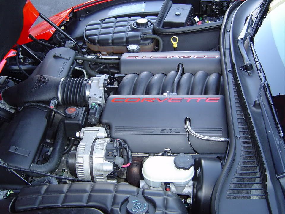

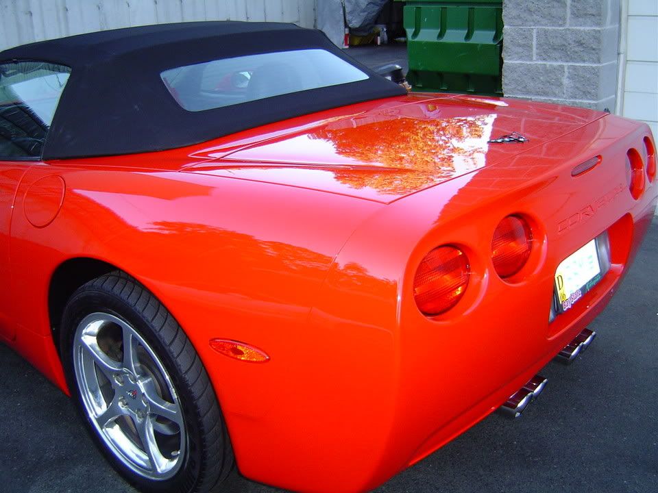

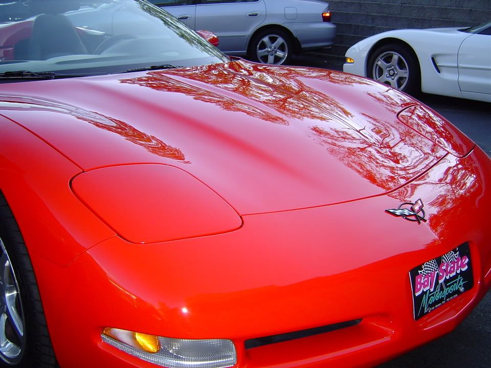

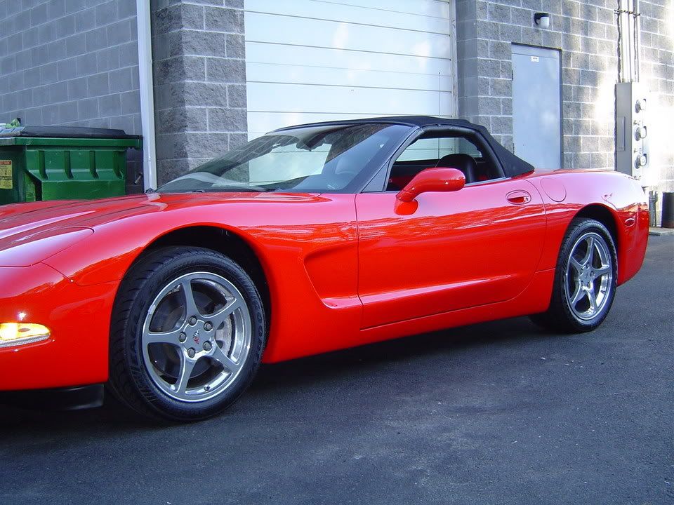

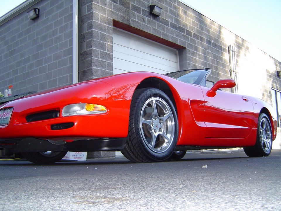

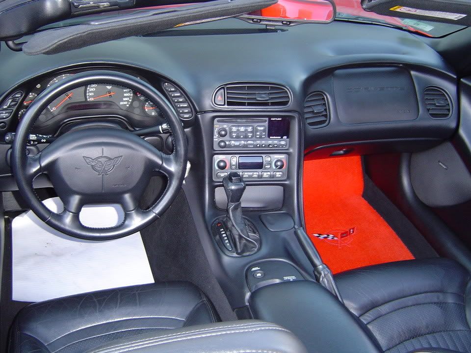

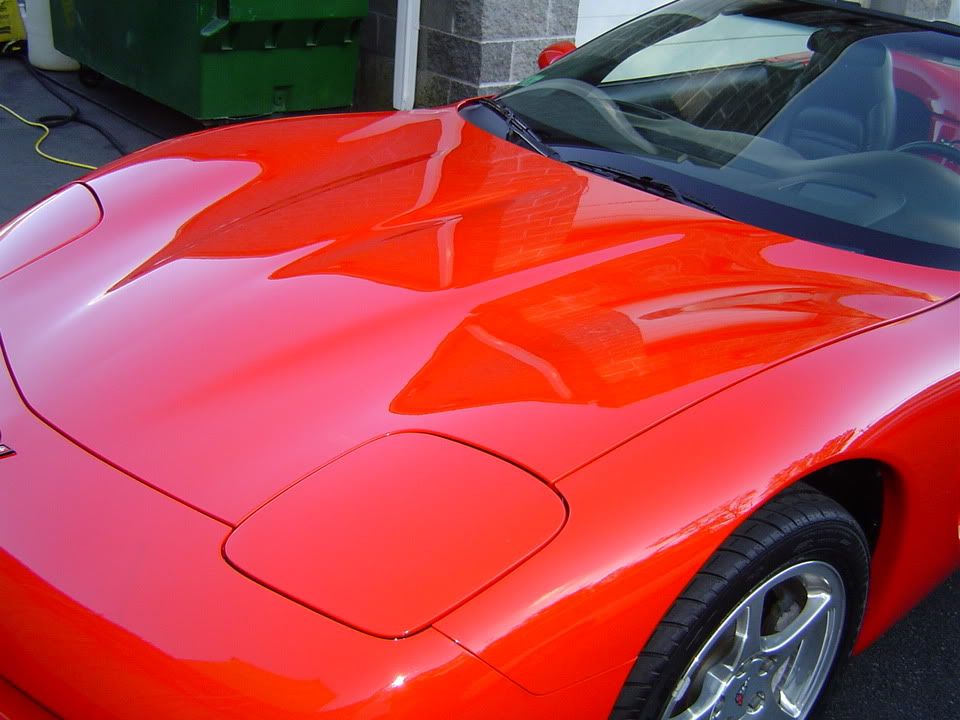

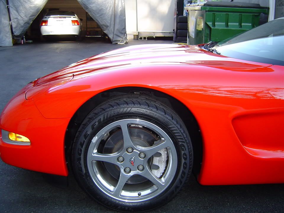

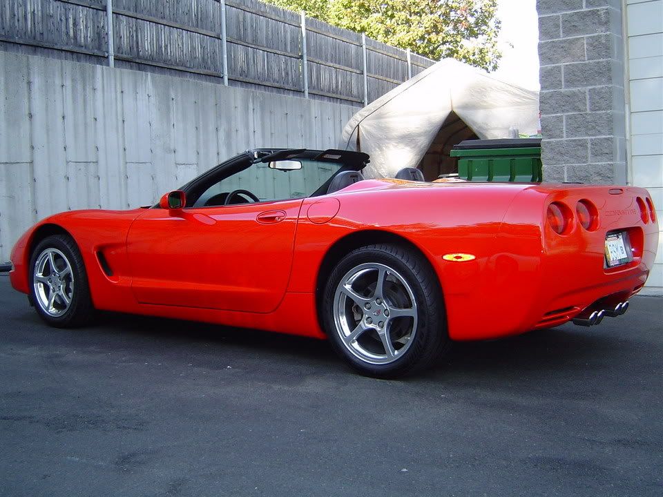

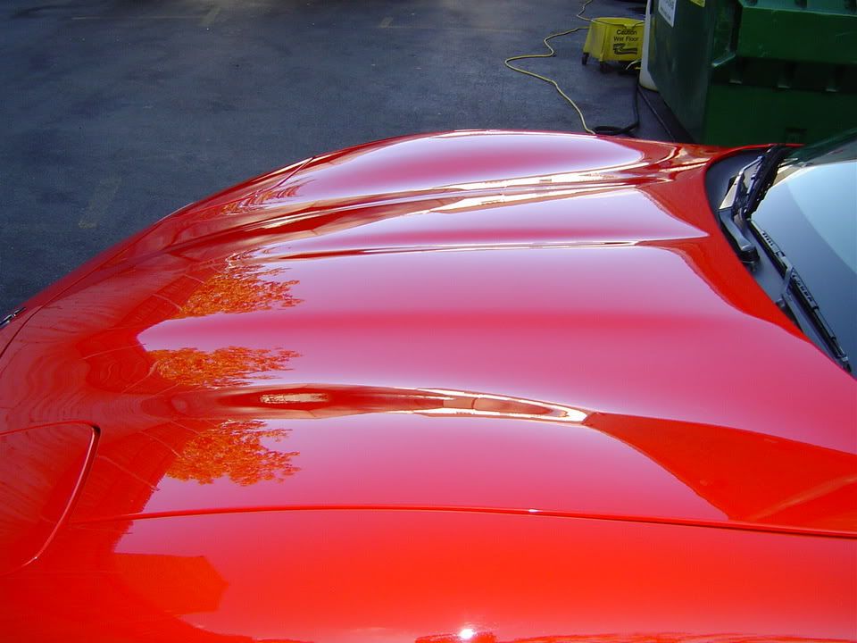

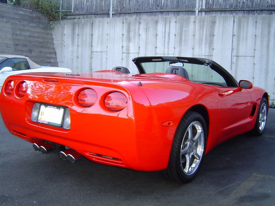

I recently started a new job working at an exotic car dealership full time. I will be doing many different things including detailing all the cars. This detail is a 2000 Corvette C5 convertible. Paint was in OK shape but had some road rash on the bottoms and a few good scratches that I had to wetsand & compound out. Top surfaces were heavily scratched.
My process:
Washed exterior, cleaned wheels & engine compartment
Clayed exterior with Kar Kraft clay bar
Wetsanded and compounded heavy scratches
SSR2.5 on top surfaces w/ cutting pad by rotary
Menzerna IP to complete exterior w/ cutting pad
Optimum polish to complete exterior w/ finishing pad
Hand application of AIO
Hand application of EX
Hand application of RMG
Hand application of Natty's Blue
Here's the pictures. The lighting was not great because it was getting dark.
Car looks very nice. :up
I know Vette clear is very hard, but do you think a cutting pad was necessary twice via rotary? I noticed you used a similar approach on the last Vette, too. Seems very aggressive.
I guess I could of worded it better. I used a yellow polishing pad for the cutting and a black foam pad for the finishing. The pads are not very agressive so I guess they would not be considered a cutting pad.
