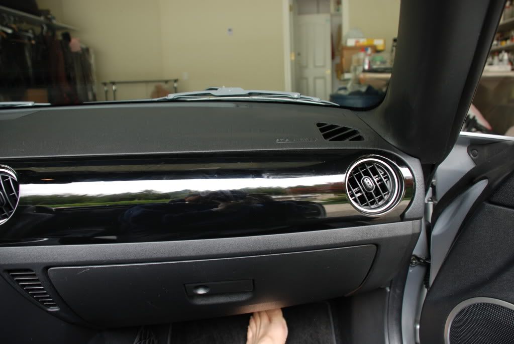

Thanks for the replys guys - I've attached a pic of the problem here:
It doesn't look to bad in this pic, but in reality it's quite a contrast between the shiny and dull areas, especially in direct sunlight. I found it hard to capture it on camera.
It's kind of hard to see, but the dashboard area closer to the base of the windshield is more dull, compared to the centre area, which is shinier. The shiny part has a gummy feel to it, while the dull part is more smooth.
Do you think the shiny part has residual armor all which is making it sticky/gummy, or do you think I've rubbed to hard on the vinyl in that area, and somehow roughened up the surface and exposed a gummier layer of vinyl?
