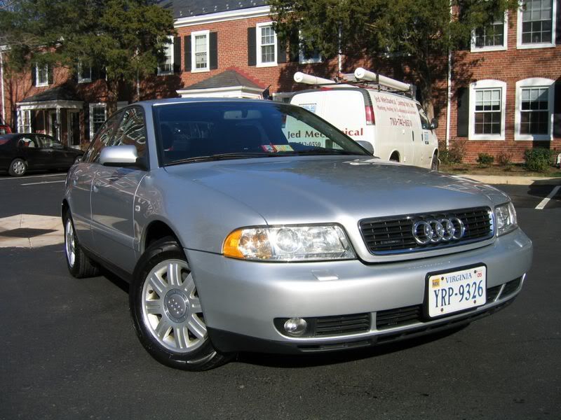

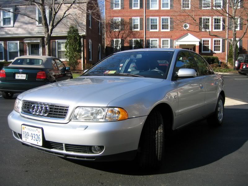

todays Exterior detail - Audi A4
Thomas Dekany
nxt wash
clay
pwc - CMA white polishing pad on 6 felt nice and slick_
TOL pads really suck! Sending all of them back toTOL
FK1 pink wax (made the paint much more slick) by hand with a foam pad
cleaned windows
wiped down interior/door sills etc...
vacuumed under the hood - tons of leaves
hot shine on black areas
After

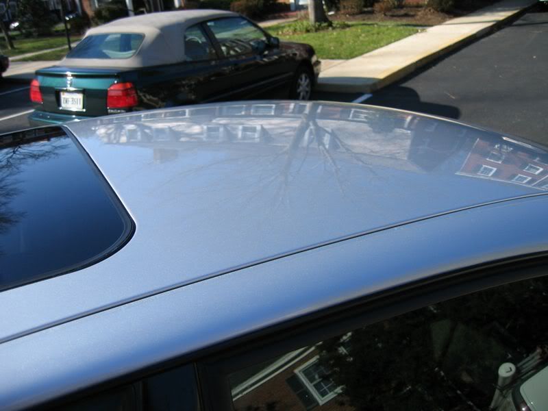

How was the Audi clear coat to work with? There have been a few members that say it's a PITA because it's so hard.
Very wet looking :bow
MongooseGA said:
You must be a night owl like me. I do all of my best thinking past 10:00 :)
No - I just don't sleep enough. Spend too much time on this site reading.
Clearcoat - I clayed one spot (yellow drop) for like 5 minutes before 99% came off. Dent underneath of it (tiny), but otherwise the paint was free of swirls except for a small spot on the hood which I saw when the sun started to hit the car - at the end of the detail. You really had to look for it, so I think the owner will be just fine.
The FK1 wax made a big difference. It reminds me of #16
