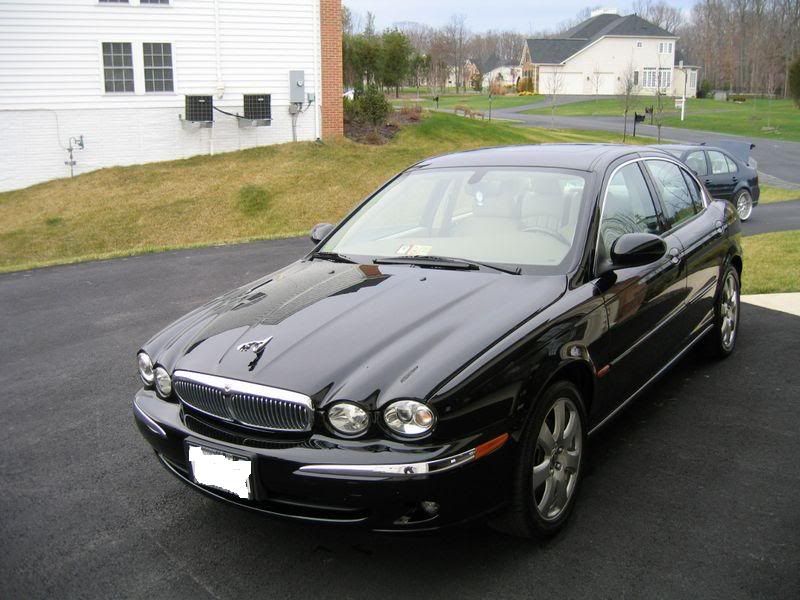

The owner of the car found me on DC. Bought it 3 months ago but the car was at the dealership for a long time. Anyways - the stealership washed it (swirled it up) then another stealer wanted to fix the swirls and of course they introduced more of them. It was mostly cloudy but we got the sun come out a few times for me to see what I was doing. I'll be taking care of this car.
I don't belive there was a swirl free area on this car.
(the owner just e mailed that under his garage light he sees waterspots, so I guess it is going to get a vinegar bath or FK1s decontemination kit)
nxt wash
TOL clay
#80 white pad 6
pwc white pad 5
fk1 pink wax by hand with it's own yellow foam pad.
hot shine on tires.

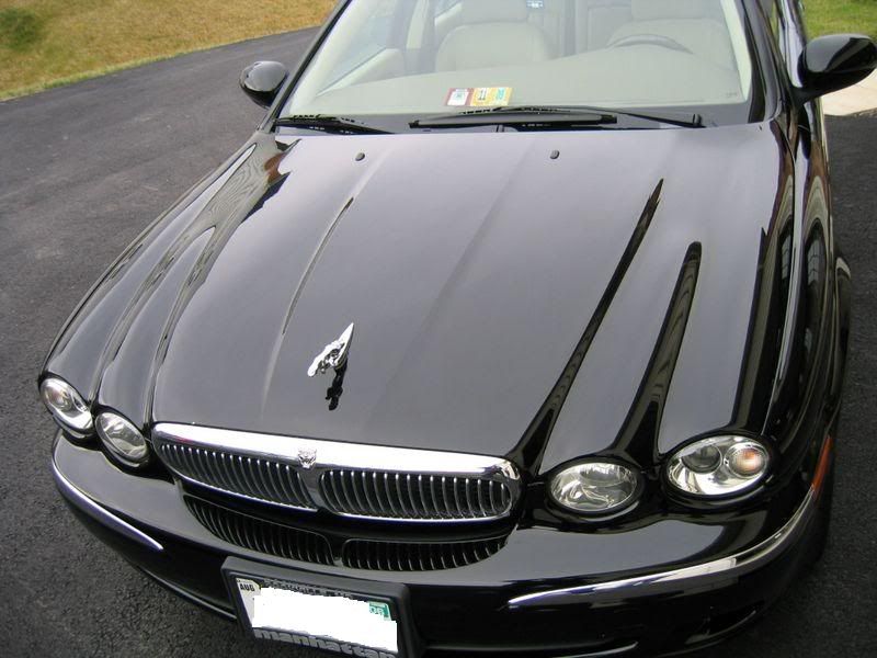

rear door is #80d front half is untouched.
hood before #80
hood after #80
Outstanding!
The paint is just a pool of black :) ...Those Jag curves don't hurt either ;)
I love the half/half shot :)
