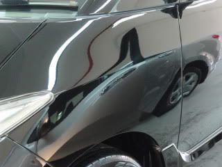

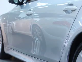

This GTR's owner was very impressed with the almost-liquid, baby oil, look.
No LSP yet.
The white car is the Nissan's owners Audi A4.
3M's Ultrafina has always been a great product for final, slow jewelling.
Mirka UF3 gives a more "sophisticated" pseudo-candy look...reminds me of NXT2 or premium carnaubas.

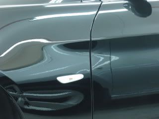

on a black MPV
on a red Golf GTi.

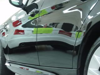

The red looks watery wet, and noticeably better vs PO85RD and Ultrafina

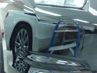

white BMW
Very impressive product, if the detailing job's price and timing allows you the luxury of slow jewelling!:drool:
