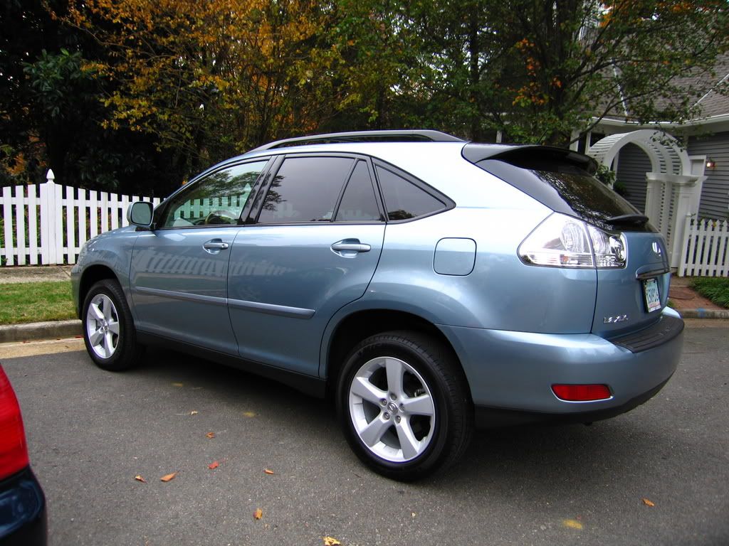

2 coats of #2180 lasted 365 days on this car that sits outside 24/7 - the paint wasn't ""slick"" of course, but wasn't dry either. Very minimal contemination even on the roof. Even those clayed off very easy. And the car is washed at Mr. Wash. Now the 330 is protected with #1000
