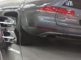

To illustrate my point above about using coatings, if customer insists on no rotary buffing and merely wants to apply a layer of "something" that'll give a "wet look"
Lexus SC430.
Absolutely no rotary buffing at all. Klasse AIO + 2 layers Matrix Micro Coating.
