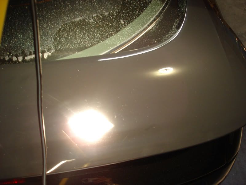

The only thing you have to worry about when you are using a cutting pad are the haze marks that it may leave behind. Those are not problem. Just follow up your polishing with a lighter polish and a softer pad to remove the haze. Here is a good example. This first picture is the straight up before shot.
I hit it with Poorboy's SSR2 and a yellow Detail City cutting pad. That got most of the big stuff taken care of, but it left some hazing behind. You can see the difference here.
In order to sort out the hazing I switched to a softer pad and SSR1. That took care of the haze and only left me with swirls that I should have sorted out with a stronger polish to begin with. I should have been a little more agressive with the first cut, but I was just experimenting on this fender, so I wasn't to upset. You can tell that I left some marks on the paint, but they aren't anything that didn't come out with another round of the same process.
