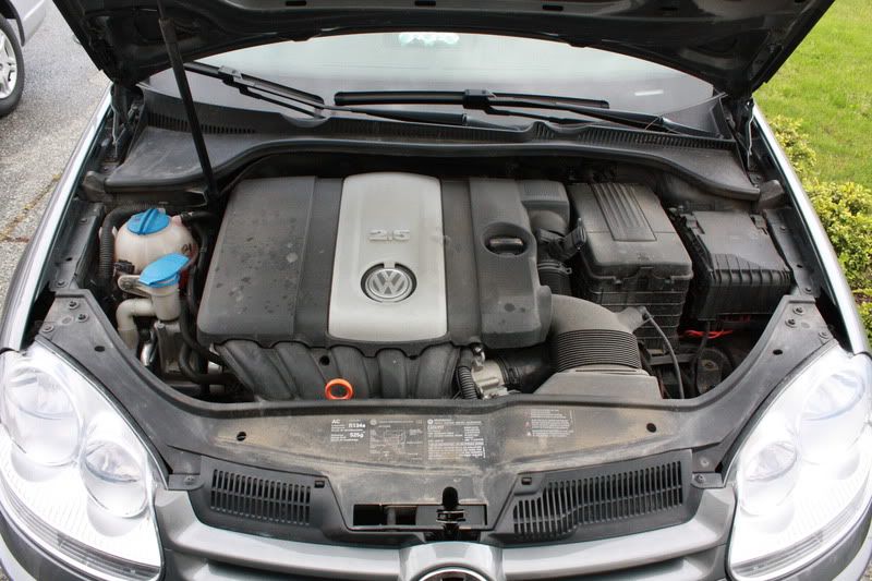

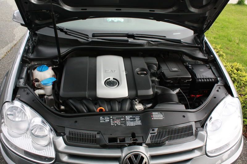

Here are a before and after shot of my test run engine detail on my wife's VW Rabbit. The car is 4 years old and had zero engine treatment during that time. My previous experience with engine cleaning consisted of putting some water on and wiping stuff down, normally just moving the dirt from point a to point b.
Process this time was:
Adam's APC diluted 3:2 Water/APC
Scrub down w/ brush
Rinse with Water
Wipe excess
Run engine until warm to dry
Applied Dressing
For the next one I will use different brushes for the smaller areas, and I might switch both the engine degreaser and dressing. I was happy with their performance but I'm always up for something new.
Note that it started raining a bit during the after pictures so the little drops are rain, not left over product.
4 Year Dirt build up:
Clean:

Night & Day :wink:
