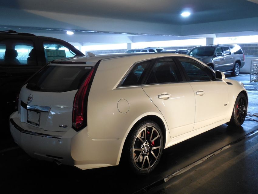

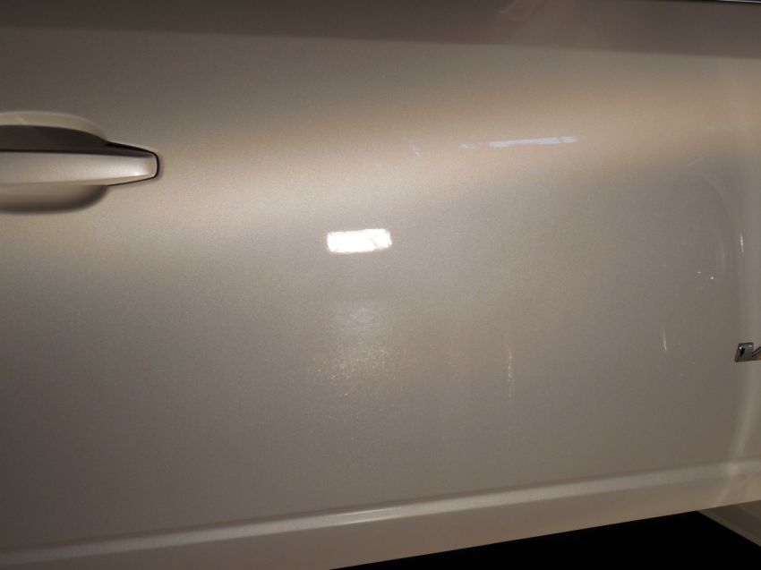

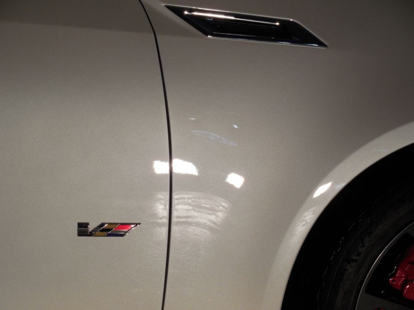

2014 Cadillac CTS-V wagon. Owner is in Florida, bought the car through Sewell Cadillac in Dallas. He contacted me through another forum and worked it out so I could get his car properly coated before it was sent to him.
Really ugly day, low 40s and fog that took all day to lift. Luckily the car was well inside the parking structure at Sewell so it was dry (but chilly) in there. The paint was in excellent shape but the initial wash still took longer than usual due to the cold, damp air. I ended up using the halogens for not only lighting up the paint but also warming it up a bit as well to make things easier.
ONR wash, Opti-Raser pink to clay
Optimum Primer using an Optimum microfiber cutting pad and Rupes 21 DA
Wipe down with ONR dampened towel (best choice considering the cold, damp conditions)
Optimum Coating applied to paint and wheels
Optimum Glass Coating applied to windshield
Armor All on tires/wheel wells

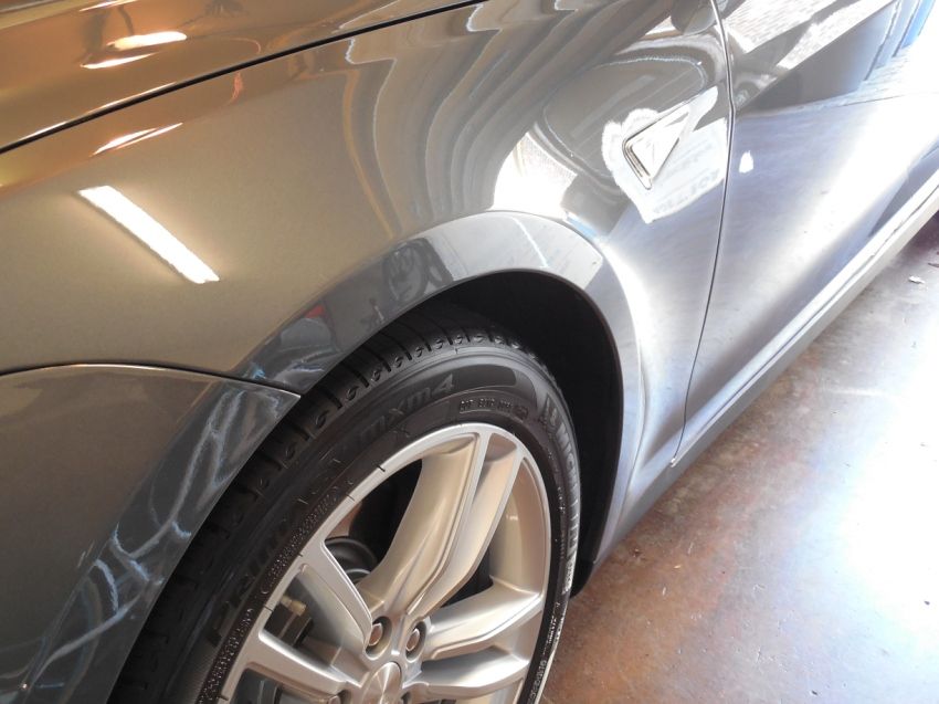

2014 Tesla Model S. Owner recently picked it up, declined cosmetic prep so it was in really good shape.
ONR wash

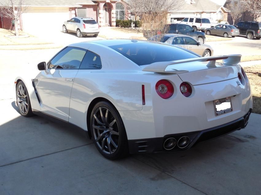

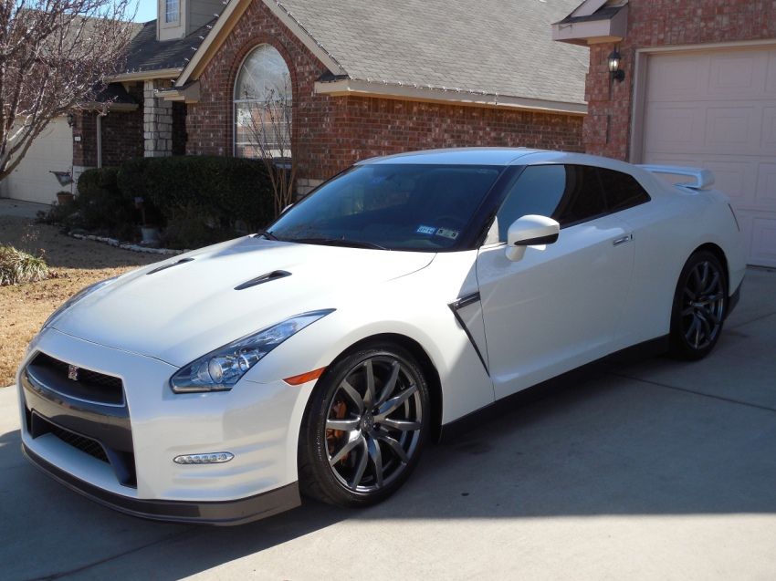

2014 Nissan GTR. 700 hp and it looks completely stock! Not like any GTR can be a sleeper, but adding a couple hundred horsepower and keeping it stock looking might surprise some other high powered cars.
Owner obviously does a nice job washing it, very minimal swirling.
ONR, Opti-Clay pink
Optimum Hyper Polish with an Optimum orange foam waffle pad and Rupes 21 DA
Optimum Opti-Seal
