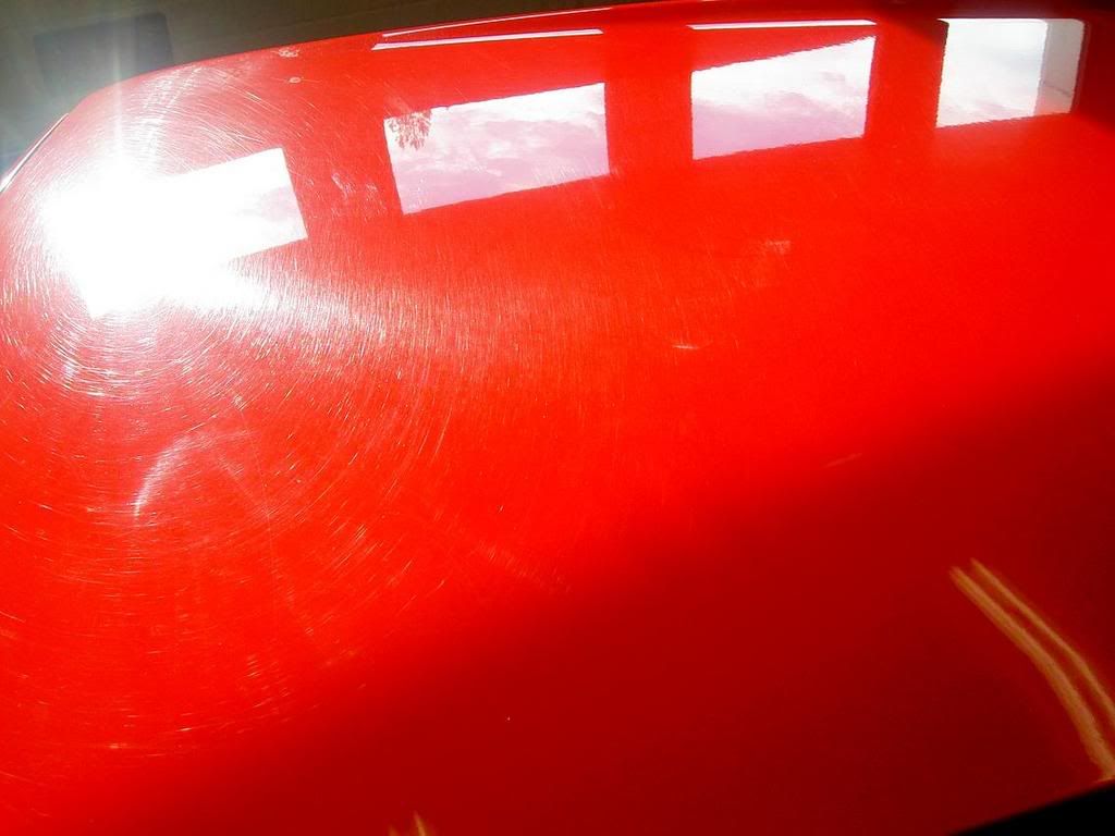

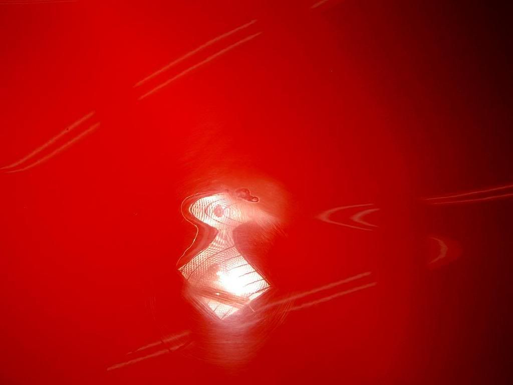

This car was pretty swirled, I only have a couple of pictures from the trunk, and the whole car looked like that. On the hood someone has sanded two spots but didn´t use a compound to take away the scratches :shocked

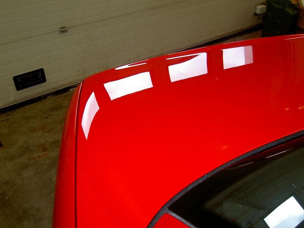

This pictures shows the wetsand damage, they hade the sizes of 1"*1" but I got out the sandscratches to 90%

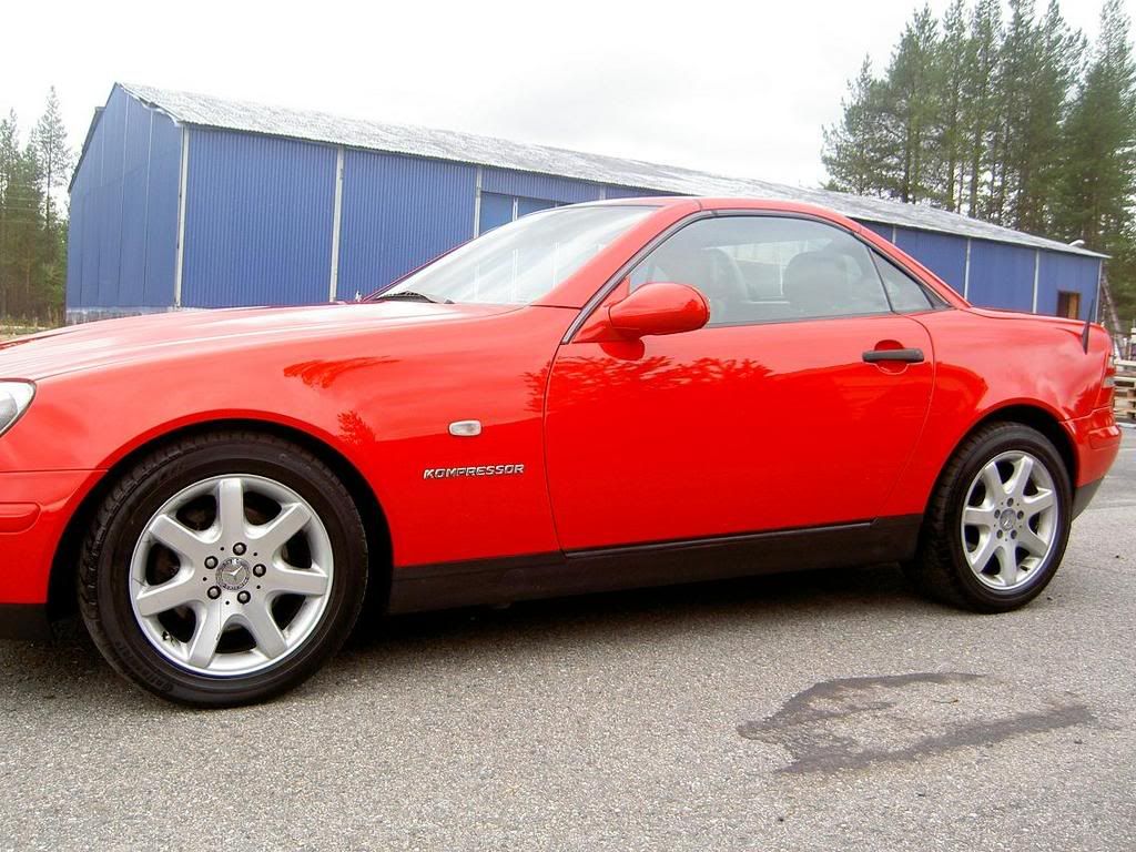

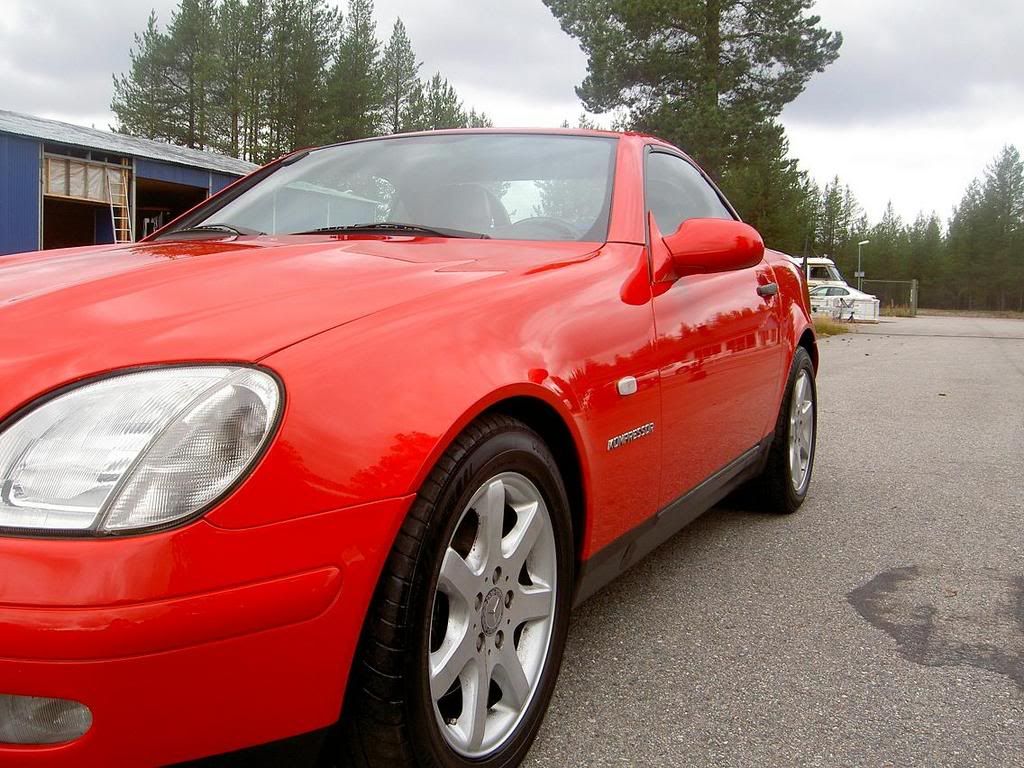

And a couple of out door shoots, sadly no sun, but I can tell you that the car looked 100% better and the customer was very pleased and happy.
