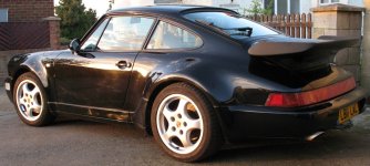

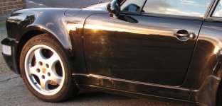

I'm trying to find the right products to improve the paint finish on my 1993 911 Turbo. It's black with a pearlescent metal flake in the paint - I'm pretty sure it's also clearcoated on top.
Unlike most 911's in the UK it seems to have been used pretty regulary which is a double edged sword; mechanically it's excellent, but the paintwork definitely isn't the best around due to the amount of abuse it has suffered on our salty, gritty, oily roads. I also live in a very, very hard water area.
You name it, this paint is affected by it; swirling, light scratches, water marks etc.
I will probably get a respray in the next couple of years when I can afford it, but until then I'd like to try and improve the painwork as best I can. :waxing:
I've bought a PC pack with the Sonus-DAS kit (white/yellow/blue pads, polishing mits, clay, flexible backplate)... however I'm unsure what products I should be using to treat the painwork. I guess I need something a little more abrasive than the light polishes to try and minimise the scratches and heavy swirling, then something to bring the gloss back up and then a final glaze or wax?
I was originally going to go for the Zaino ZPC, Z5 and Z2 products to fulfil those requirements (they seem to be rated better for more regulary used cars), but they're rather expensive in the UK. Can anyone out there reccomend suitable alternatives, or anything that would give me a better result on this type of car/paint combination. This is a drivers car btw, definitely NOT a garage queen! :)
