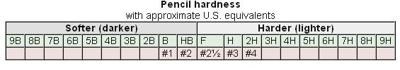

Pencil Hardness Test
This type of test uses special graphite pencils with different degrees of hardness to scratch the coating, which then determines its hardness - Testing Your Coating's Hardness
Pencil Hardness is one of many tests that are done to evaluate a coating's performance. Other tests are abrasion, reverse impact resistance, direct impact resistance, cross-hatch adhesion, oxidation, gloss retention, UV resistance, yellowing, blistering, drying times, chemical/solvent resistance (using both the rubbing and spot/time tests), salt spray resistance, humidity resistance, acid and caustic resistance
Most coatings are formulated for specific types of finishes, various conditions or different substrates. So use the pencil hardness test as one criterion for selection.
But do not judge any coating by coating thickness or pencil hardness alone, as there are many other significant characteristics to consider. Be cognizant that whatever the hardness rating it only offers scratch resistance, which only helps to minimize the appearance of light scratches
Pencil Hardness for Common Coatings
