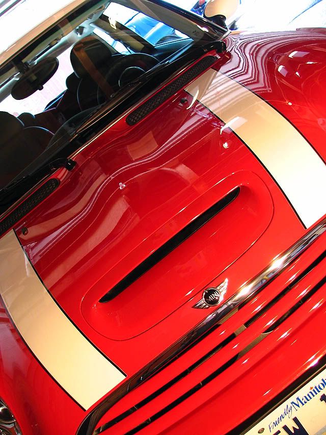

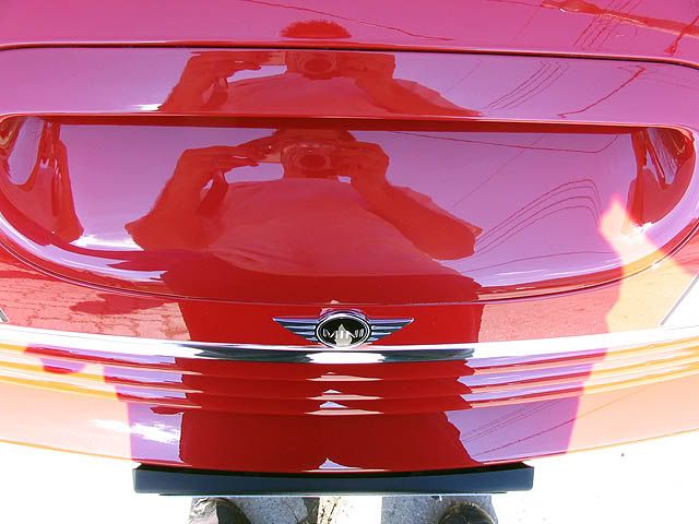

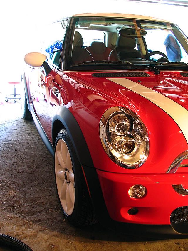

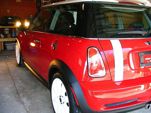

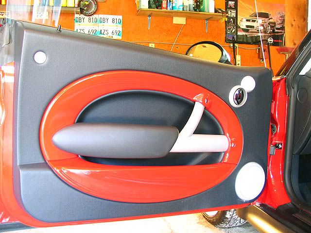

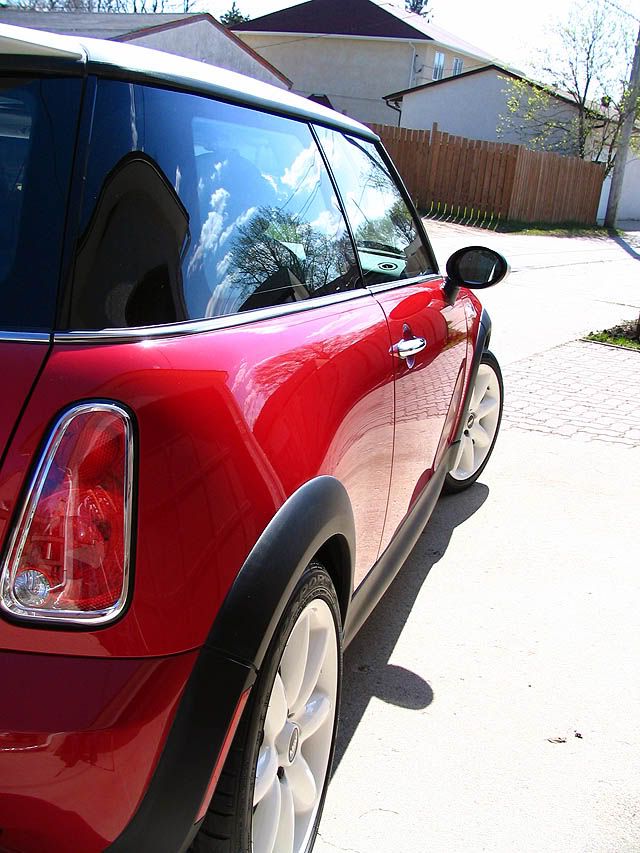

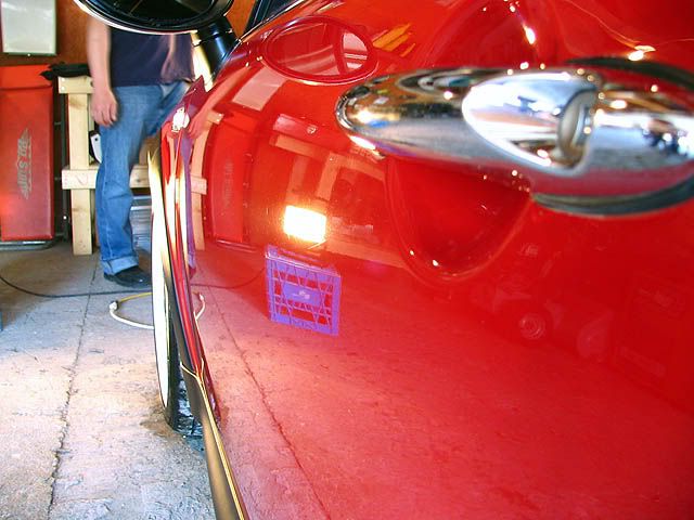

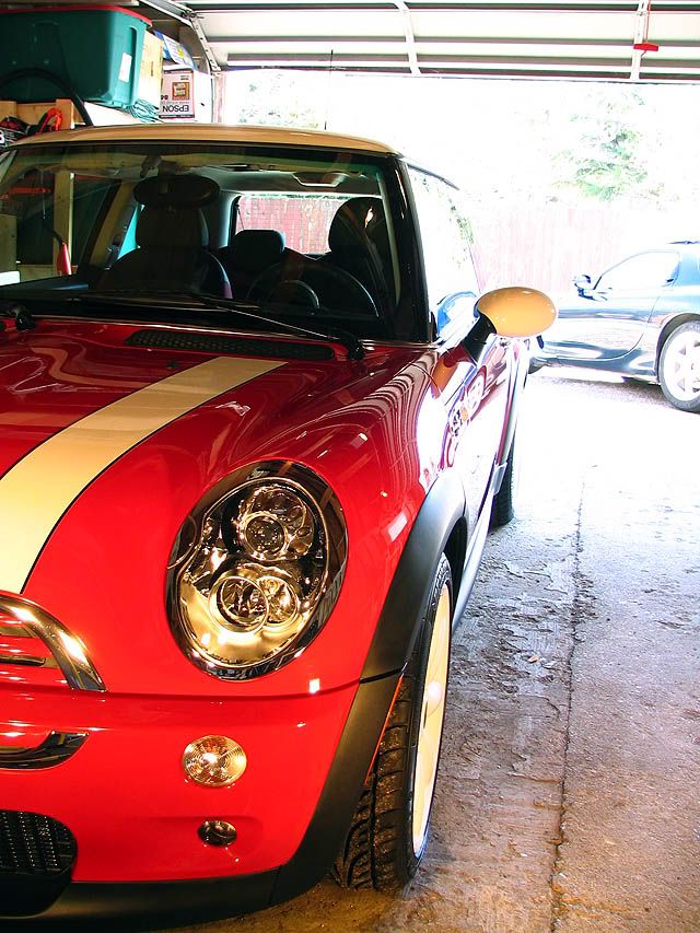

She takes surprisingly good care of it, but tunnel wash's have wreaked havoc on the paint. Swirls were pretty bad, and pretty deep, but the interior was in VERY good shape. Engine bay was dirty as hell for a car with less than 10000 clicks.
Process:
SSR2.5/cutting pad
SSR 2/polishing pad
Sonus SFX2
Collonite 476S (She needs some durability, as her husband just flew in from Cleveland just so I could detail it)
777 on rims, wheel wells, and tires
Super Dress It on trim, tires and wheel wells.

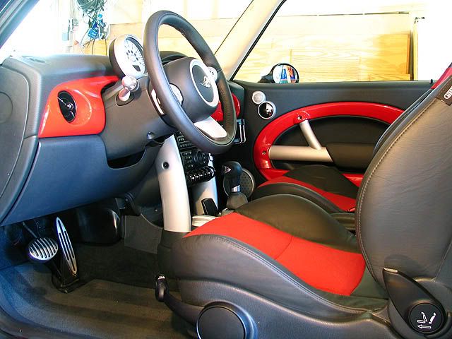

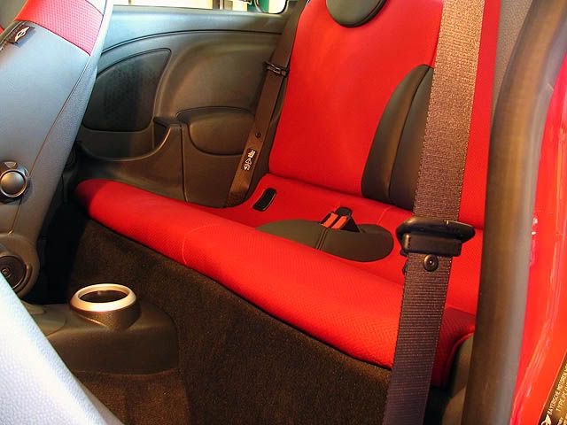

Interior:

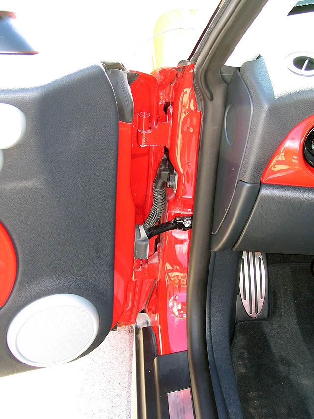

Dress It Right on all interior trim
Vacuumed and Scrubbed carpets
Cleaned glass inside/out
WetWax on painted panels

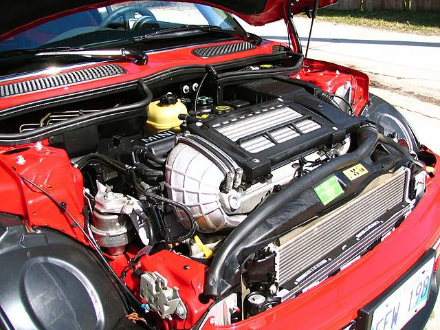

Engine Bay:
777 APC
Tryed something difference and used some Poorboys Trim Restorer on the hoses and plastics

That's the nicest overall color/interior combination on an MCS I've ever seen.
Oh, and good work, too. Did you notice a pretty high level of orange peel? My wife's former 2004 MCS had quite a bit.
This thing had next to no orange peel. :hifive:
