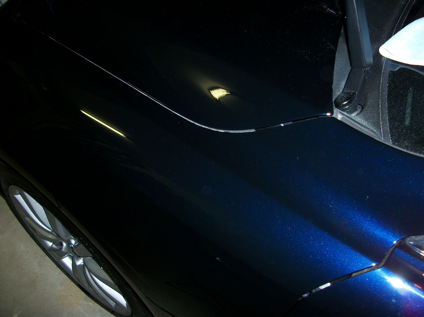

Washed and clayed, under the lights
After 1 pass with SIP on the yellow pad
Right Front Fender is polished, door is not
Another Fender shot
After polish only
During it's 1st of many foam baths ( gilmour foam master with Detailers pride, extreme foam... )
Here are the afters, you can see on the truck where swirls are still present..... wish my yellow pad has made it all the way, but this wont be the last time I polish the car, so it's damn good for now.
