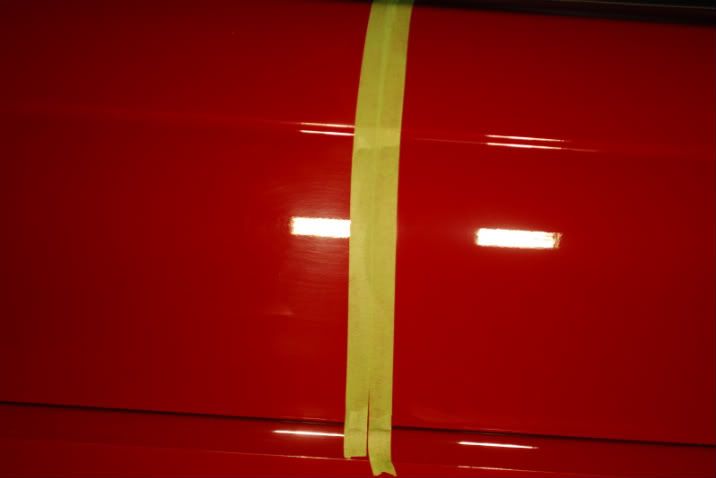

I had a 6 hour time limit on this car. When I saw the car 2 days ago I didn't think the paint was that bad, but after I started to correct the paint I noticed it was going to take alot more work. I used the same Cyan Hydro pad on this car as I did on the Rossion Q1. Man these pads gave me problems. They where clean and dry but they would not completely remove all the swirls. So after I had to go over the whole vehicle with a flat orange Lake country pad and then I finished with a white kompressor Lake Country pad.

Since I was in a time crunch for this car I only have 3 50/50 shots, but you can see how bad the paint was.
