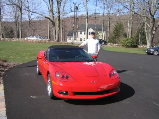

I will be detailing a 2006 victory red Vette on Saturday. It's my Dad's, so I have have to do a great job for Fathers day.
I plan on using Clay if needed, FPII, RMG topped with Soverean. I have never done a vette before, I hear the paint is very hard. It's brand new, only dealer induced swirls, I doubt he has wahed it yet. It's a few months old.
Thanks for any tips.
Me and the car, it's a Callaway.
Steve
