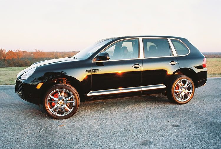

The Accord and Cayenne both were polished with Optimum Poli-Seal using an LC polishing pad and after just polishing, when I told my son to wax the Cayenne he looked at me like I was nuts. He said it looked great already. I told him Gary (the owner) likes me to finish with a carnauba on his black Cayenne. He just shrugged and said okay.
Anyway, both were waxed with my 80/20 blend of Meguiars #16 and FK's Pink Wax.
I know I have posted the Cayenne numerous times but I thought these sunset shots were a lot better than the last time since the sun hadn't actually set when I took these...without noticing the huge tree behind the Cayenne in the last shot.
