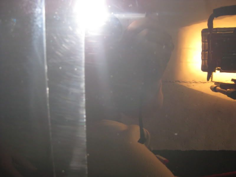

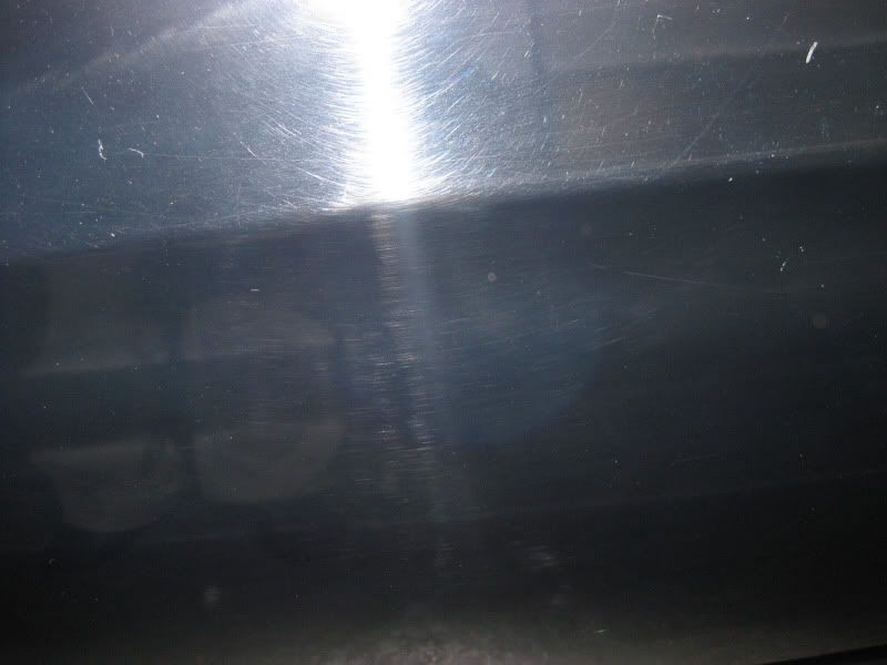

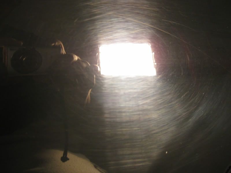

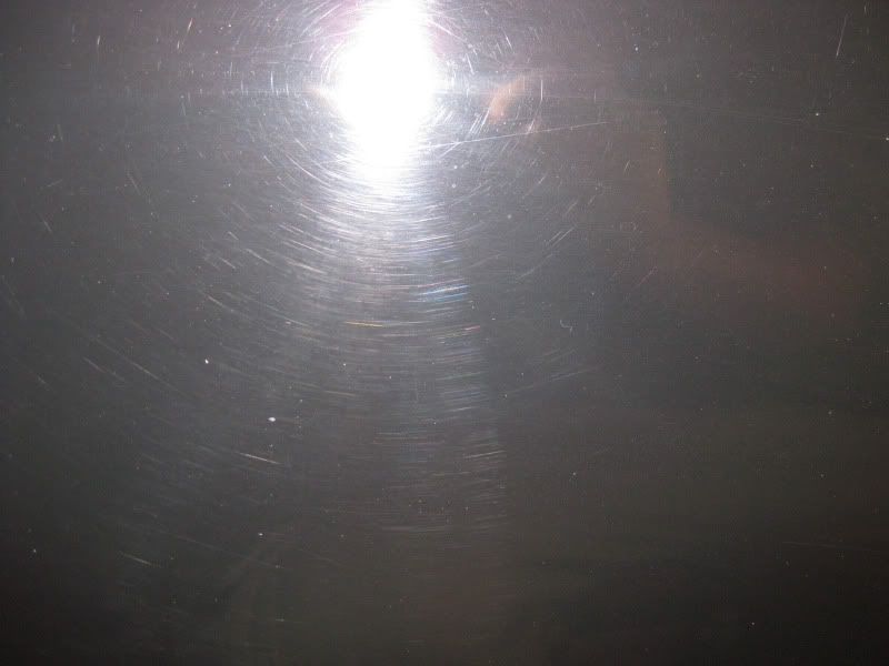

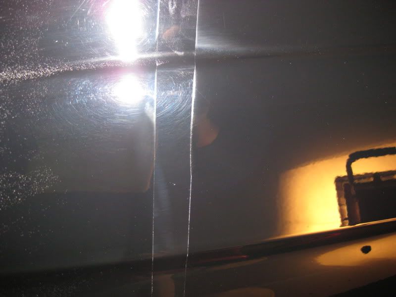

That 335i needs some serious work. Most likely though you will need to hit that thing with some Meguiars #105
Polishes/compounding I have Menzerna Power Gloss, and SIP for finishing I have Nano Polish, Final Polish II, PO85RD, and PO203S, Also have the glaze and FMJ... Waxes PS21S and BlackFire use the Flex 3401
I think what VTEC is trying to get at is what does the owner want. I've come across many clients with defective paint like that and they still think that it just needs to be waxed. Do they want a clean up or a full correction type detail? You have to answer that question first; that could be the difference between a $200 detail or a $900 detail depending on how far the owner is willing to go with it. If it's a DD then they probably don't want to spend north of $600, but you never know. I always charge by the hour on anything more than a wash, clay, and seal.
The owner of the car gave me a day start at 8 in the morning till 4 in the after noon... The owner wanted it to just pop more in which i ended up using SIP w/ LC Orange and 85RD w/ LC Black.... It was not full correction considering time and amount spent after that proceeded with FMJ and #845
Looks a lot better. If all the owner want is for it to pop more and minimize the swirls then that's what you give them. I always email pictures during the detail so they can see what's going on. I'll sometimes go with a full correction on a very small section and they're so pleased they end up opting to go with 100% correction. Looks like you achieved your goal of pleasing the client though, glad it's working well for ya.
