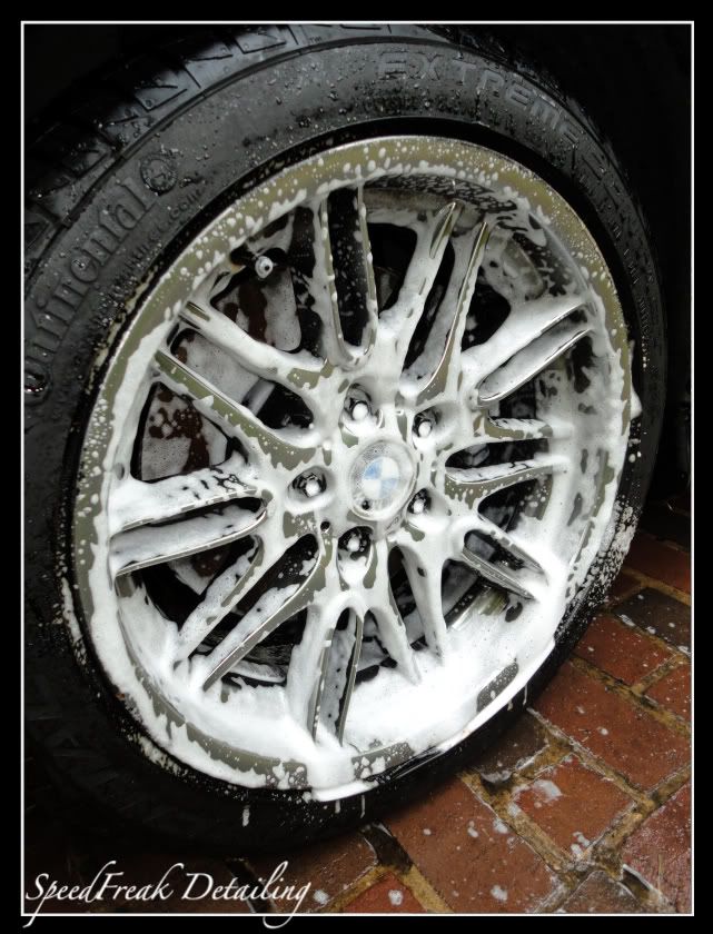

Wheels soaking in Eagle One wheel cleaner
After Eagle One, pre Iron X
Time for the good stuff

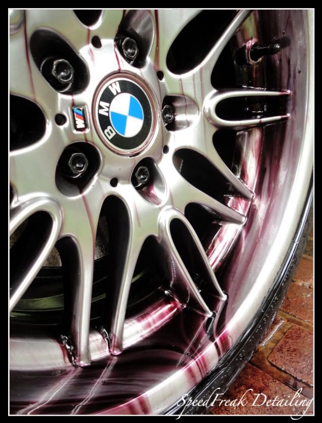

Iron X after sitting for less than a minute, showcasing the importance of using a cleaner with a dedicated iron decontiminate.

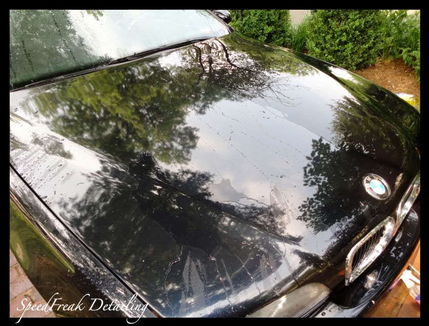

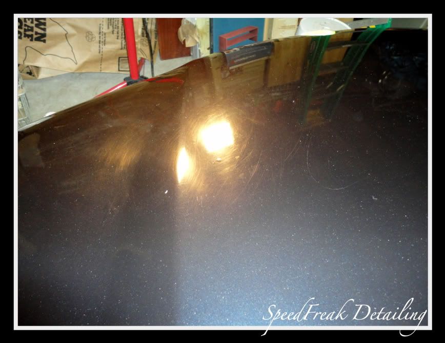

Hood post wash, dull and full of orange peel

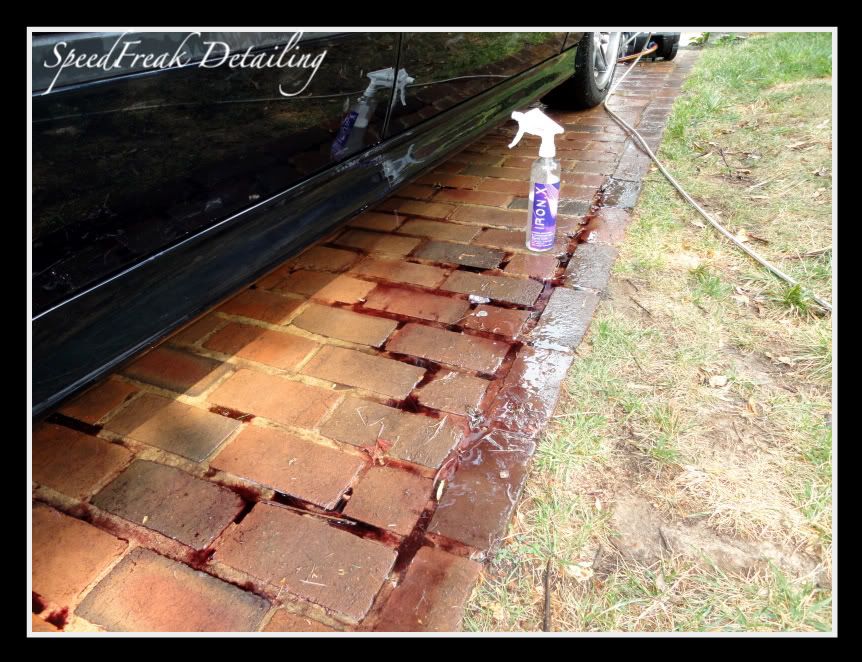

Iron X applied to body and glass post wash. Notice the blood red puddles of water stained by the iron.

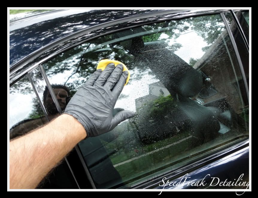

Per the usual, all glass surfaces were clayed as well as paint

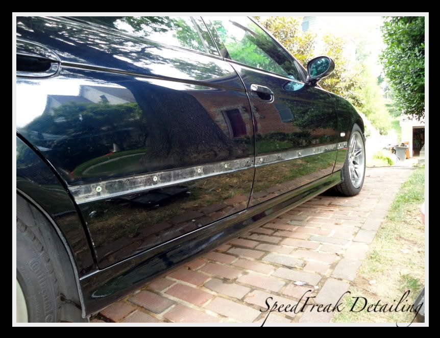

Side trim removed

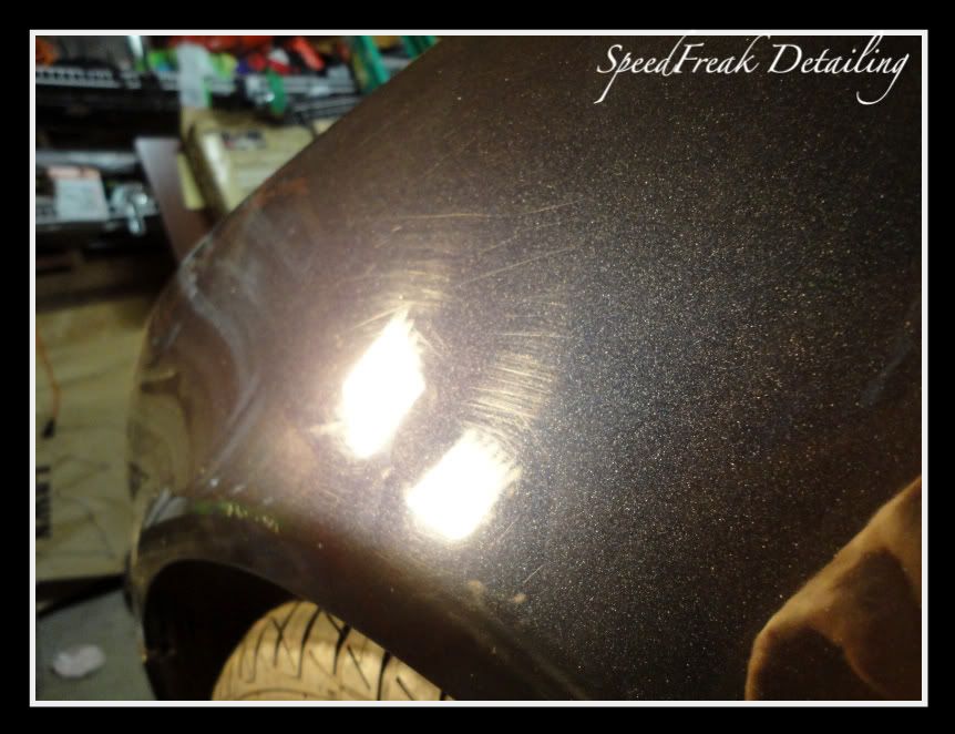

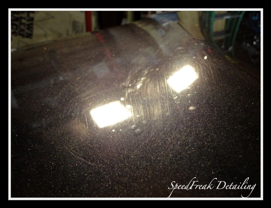

Hood shot under the halogens. Swirls, orange peel, rids present throughout
Bubbling under the paint. Nothin' much to be done here, we can take care of those swirls though

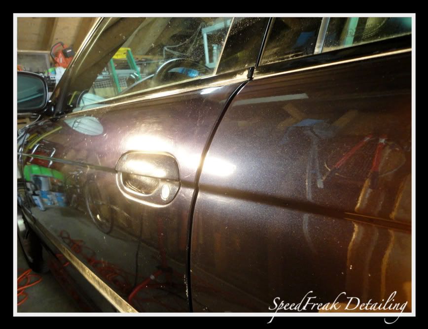

Driver's side rear door corrected, front is next

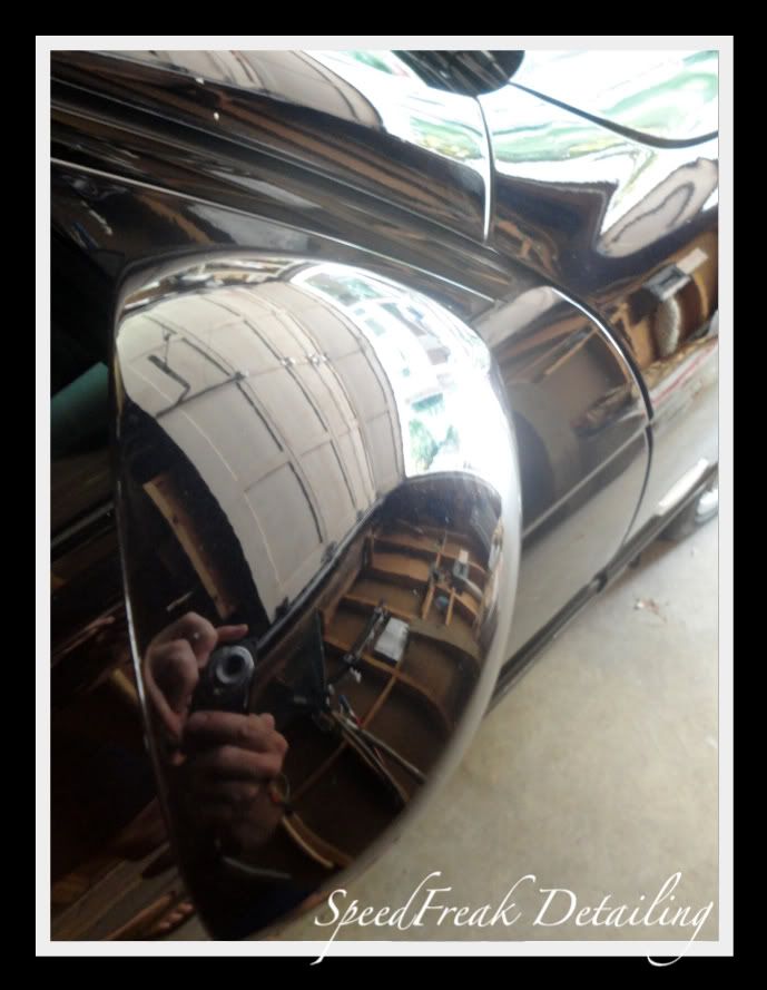

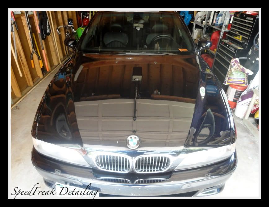

Pulling her out into the sun to check my work
Nice trunklid reflection!!
Unfortunately the sun went away just in time for the reveal.:mad So some reflection shots in the garage will have to do for now.
