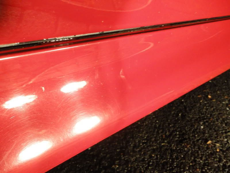

After wash and clay, heavy swirling is present throughout

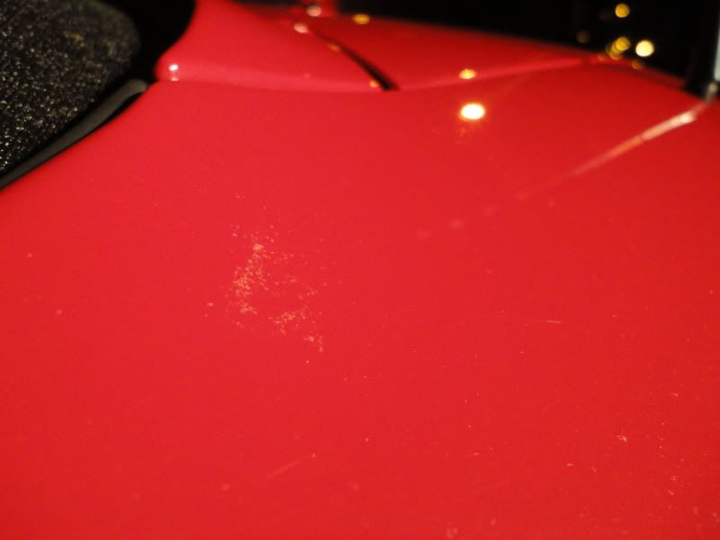

Etching from some sort of stain in driver's side quarter panel

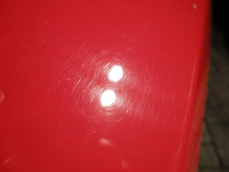

50/50 after one pass with M105/orange pad, still room for improvement
50/50 rear quarter panel

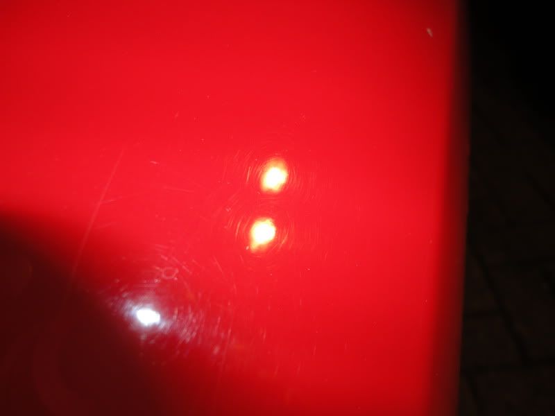

50/50 driver's side hood

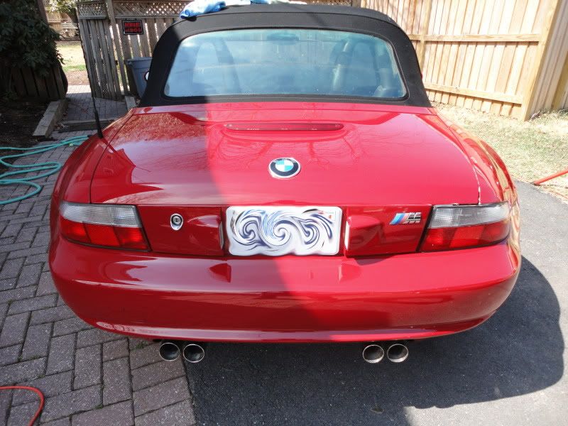

Afters

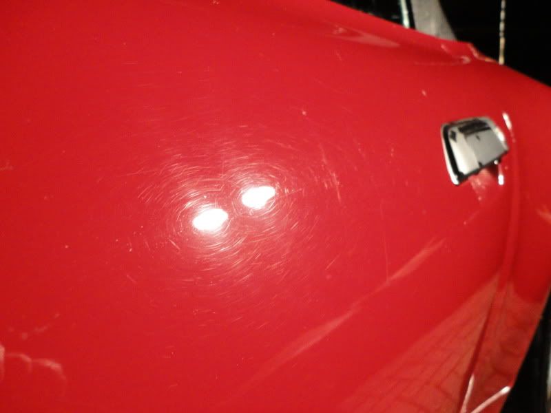

heavy scratching under door handle polished out

Afters
