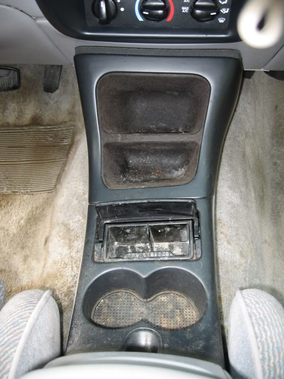

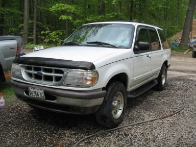

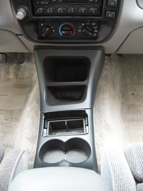

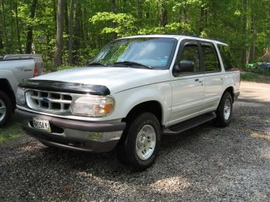

This is a 94 explorer I just did. There is a good chance its one of the worst ive done.
I used lots of high pressure air and 6 fillups with my heated extractor (durrmaid) to get all the stains out(as much as would come out)
I used a mix of greased lightning and krudd kutter.
The outside was just a thorough wash and an AIO.

Thanks for all the comments! here is a brief list of my proccess:
-pre vac
-HP air all seams, vents, carpet stains, embedded sand, door jambs(with a mix of water and GP cleaner)
-then vac again
-pre treat carpets/seats with 10/2 cleaner/water let it sit for a few then agitate with a brush
-Then hot water extract till the water coming out is clean
-do the windows and the dash and jambs again
the durrmaid is much more powerfull the TLGCM it gets hotter has more water pressure and alot more lift. plus you look alot more professional with a real machine. Im in Windham by the way.

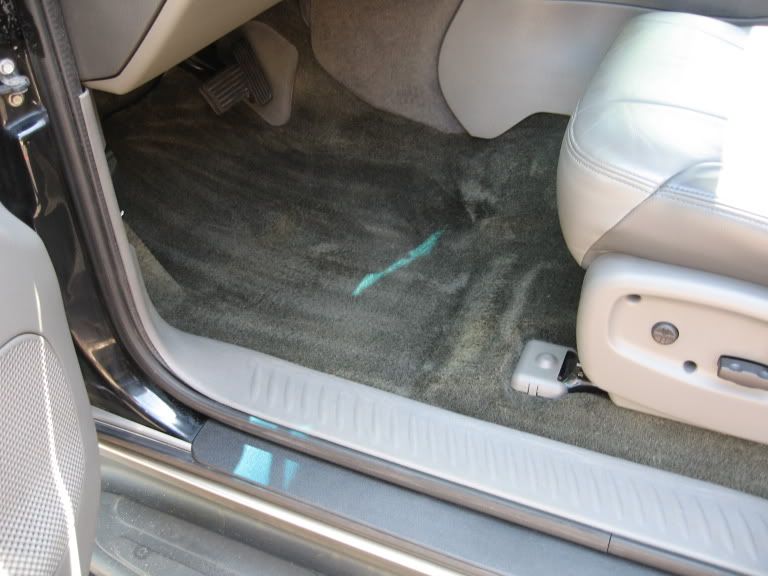

heres a couple more pics from a couple days ago 02 trail blazer. The door jams arnt done yet, I wanted to get the picture before there were to many shadows.
