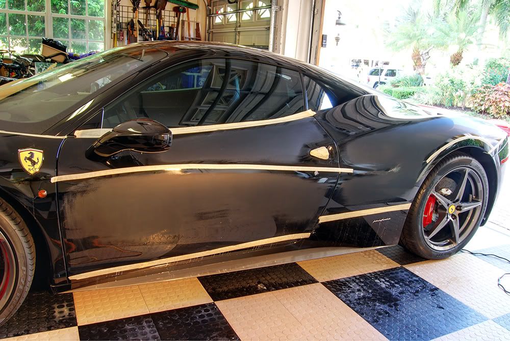

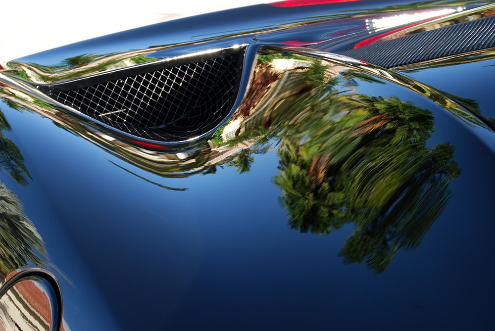

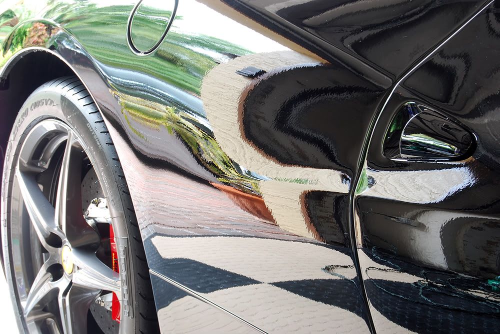

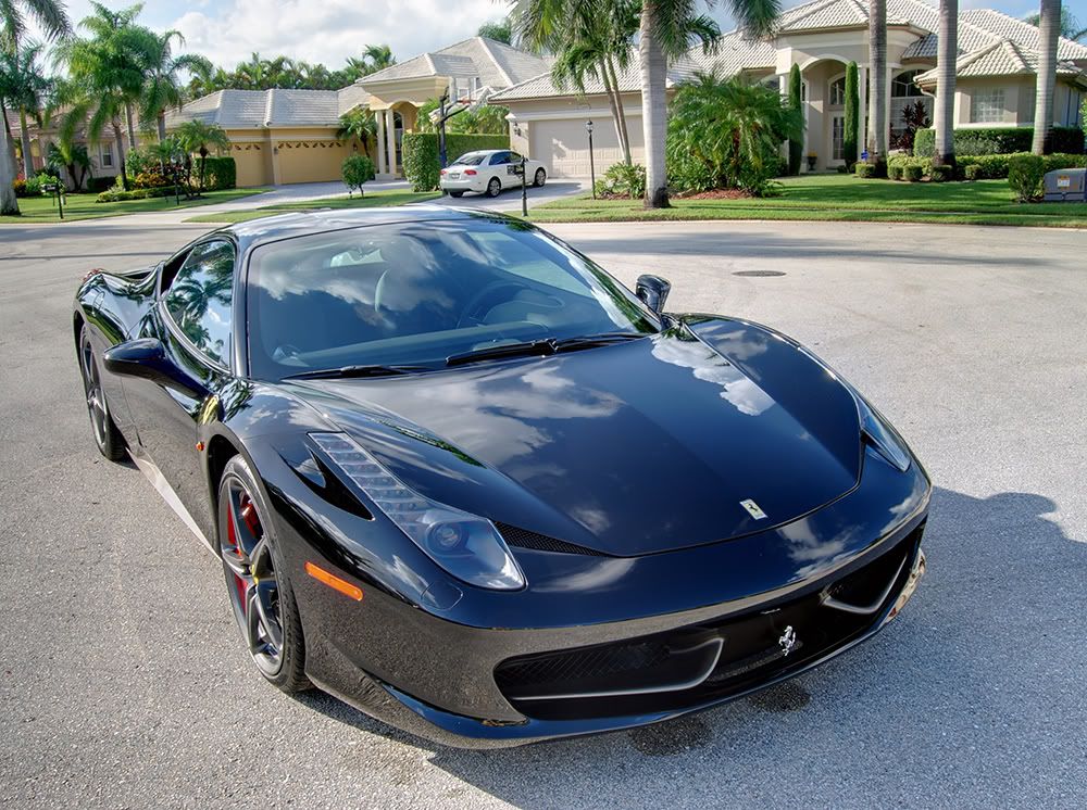

Sorry I haven't been around the last 5 days, I was stuck on my latest project. A quick sneak peak...
Terrible factory paint.
During
Two quick afters
(you can see the orange peel in still in the gas cap)
Couple of notes...
This was some of the hardest paint I have worked on and there was not a flat panel to be found. Basic process was to hand sand with 1500, then 2000 in a cross hatch, then finish with a DA and 3000 grit. Then break on the wool/rotary and start cutting, for a long time.
