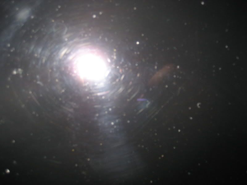

Hi guys, I learned a lot from this forum and looking to see which polishes I need to fix these paint defects. I have hard water spots, cobwebs and medium scratches. Will the Intense Polish be too much or will the 106ff/Final Polish be good enough? I own a PC 7424 and some Meguiars pads.
it is a 98 grandprix. always outside. here is the worst of it
From your post, you stated SIP and Final, yet said Intensive Polish later.. There is Super Intensive Polish and Intensive Polish. Intensive Polish on an orange pad might do you some good on a couple passes, but from what I gather.. its likely you'll need to go with the Super Intensive. The second picture shows some major scratches along with the swirls.

SIP for the scratches. Ultrafina for the finish. Ultrafina is my new favorite polish and prefer it over the 106ff anyday. Love the fact you can finish wet with it.
But the SIP will get it done for you with either a orange LC or yellow Sonus pad. SIP and IP are pretty much the same thing. Niether is ultra strong but does the trick.
Another vote for SIP here. 4" orange LC pads and SIP. It'll probably take multiple applications of the SIP to effectively remove those defects. They're pretty bad.
Ultrafina or Menz PO106FF (aka Nano Polish) would probably be best to follow up the SIP. 4" LC white pad and the 106FF would be my choice.
