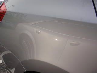

Heavily-overcast sky, with dark storm clouds overhead. 5-10mins before a thunderstorm started. Greyish silver vehicle. Sanding and compounding done, and pic taken.
:p Not a photography enthusiast, so pls excuse for amateurish quality pic below. Can be challenging to capture silver's attractiveness via the camera:)
