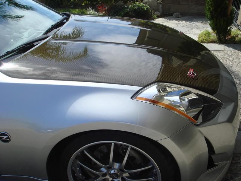

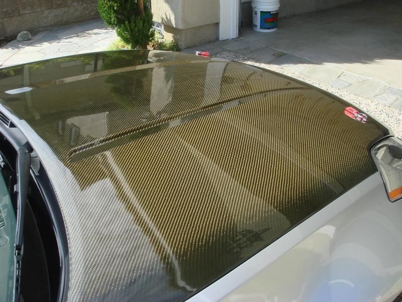

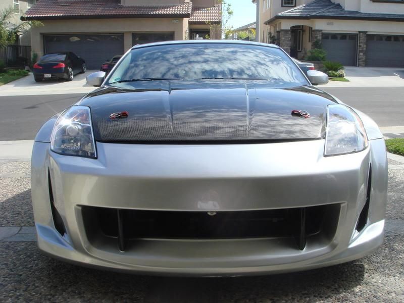

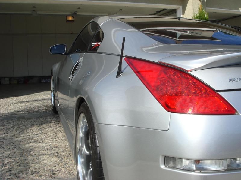

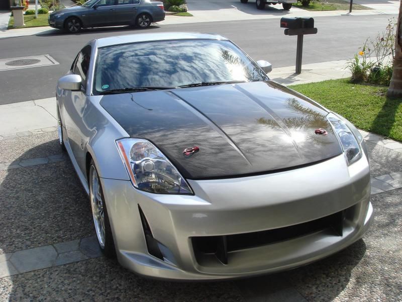

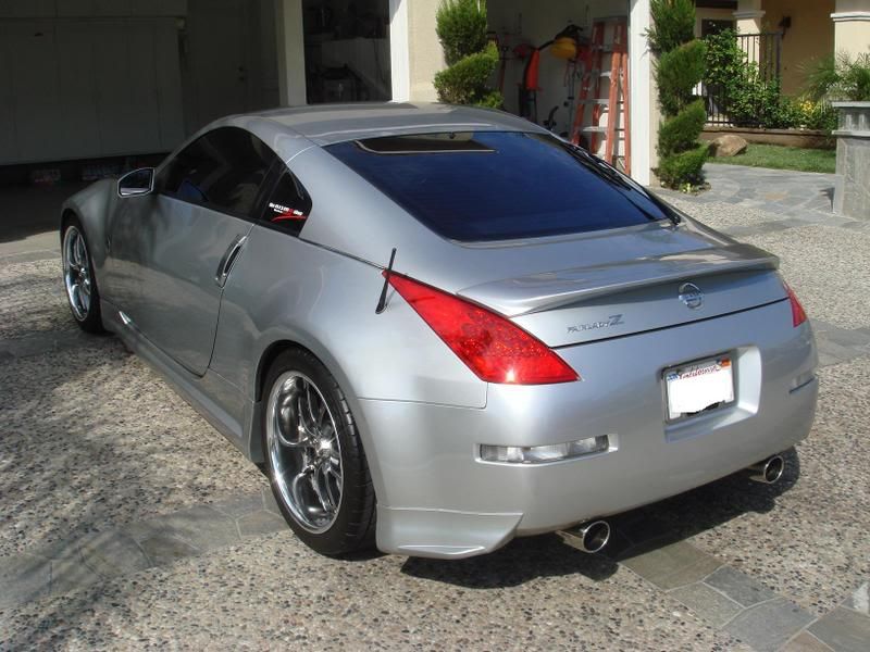

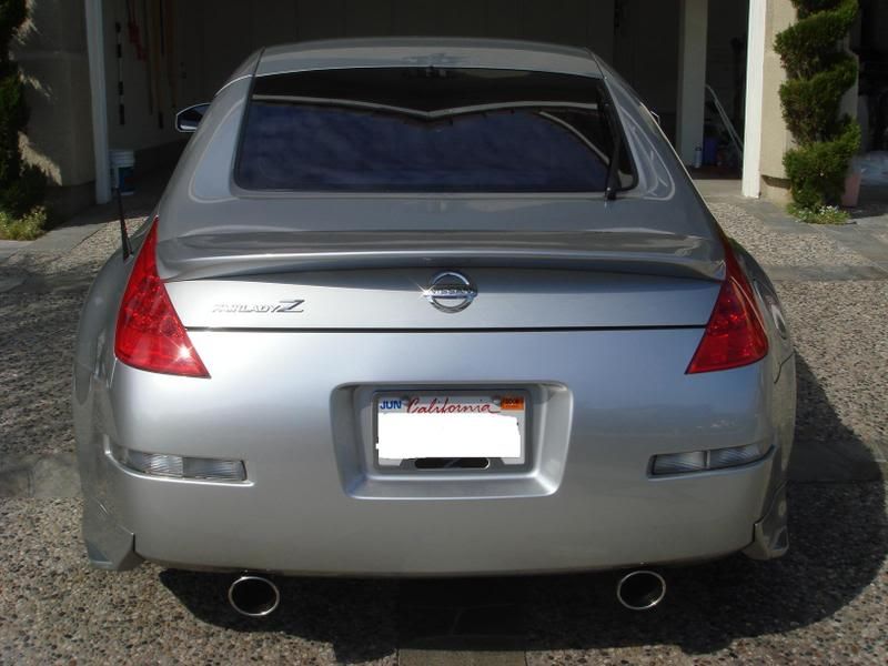

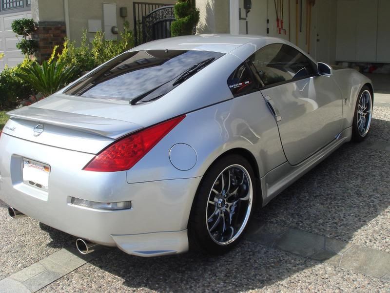

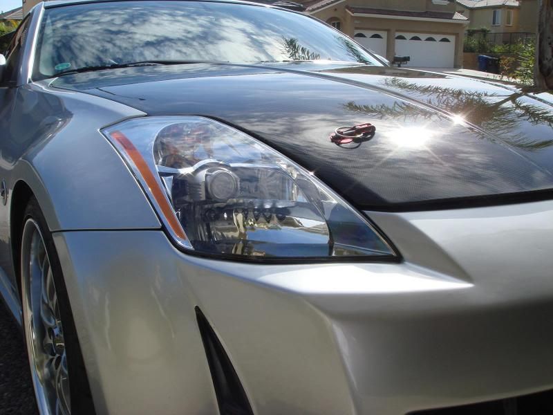

Hello everyone, first up the 350z. customer just wanted a one step polish.
Process:
wash
clay
OP w/ white pad @ 1300rpm
z2pro
Next,

on the carbon fiber i used OP followed by z2pro
