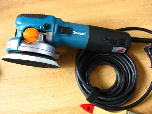

Servicing the Makita BO6040.
BMW_318TI
As you know any moving parts need some grease to work property.
It would be shame when your Makita/DA machine is broken:doublesho because of some grease problem. To prevent this I recommended you to take grease service for your lovely machine. This write up is for the Makita BO6040, but with some common sense:lol: you can do this grease service for any polish machine:buffer:

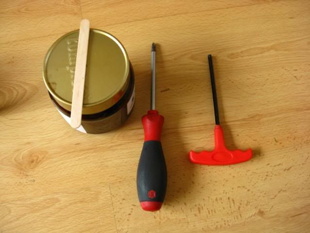

Tools needed.
Good and right size Philips screwdriver.
Allen wrench.
Good grease.
Ice scream stick:p or something silmular:p

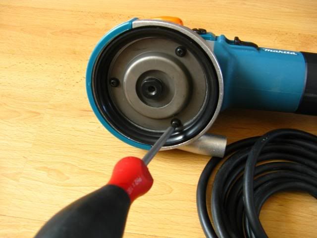

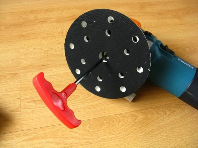

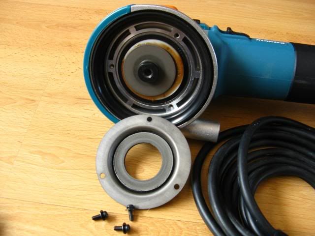

-Remove the backing plate.

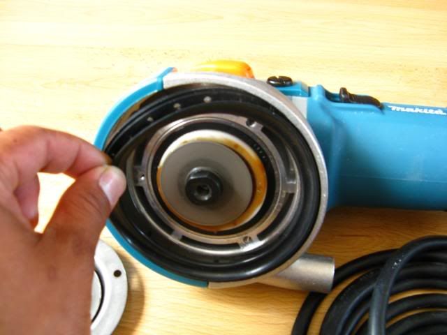

-Remove the seal plate.
-Remove the dust seal.

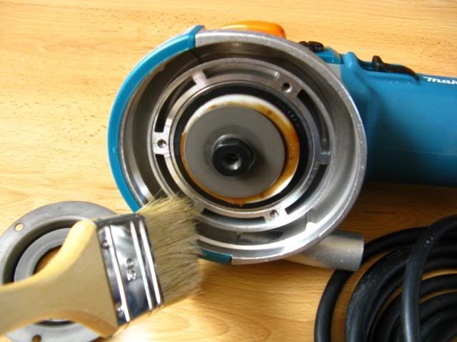

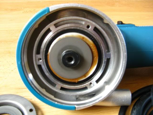

-Clean the machine before greasing.

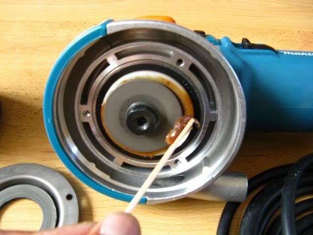

-Greasing.

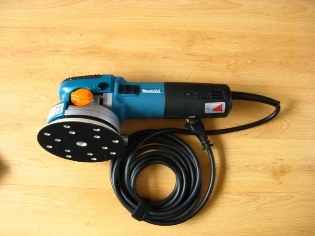

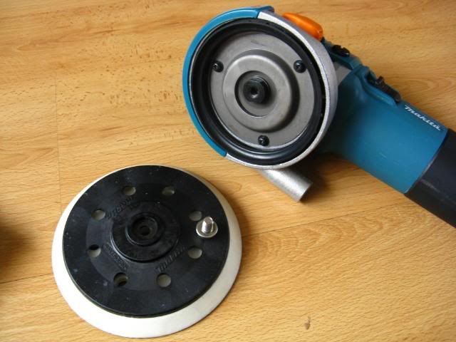

-Install all parts together.

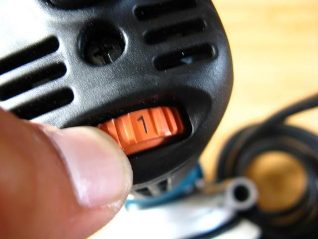

-Switch the speedcontrol to the lowest range and connect the machine to the power outlet. Let it runs for to let the grease spread property into the gears.
-Done:thumb:
