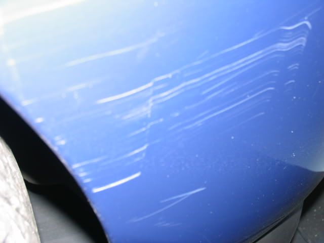

Ok so I wash my car on friday and notice this large scuff, I know I never hit anything and I do park in a car park frequently so someone has bumped my car :(
The process was
4.5" pad LC Orange with ssr2.5
4.5" pad LC White with Machine Glaze #3
Here are the befores

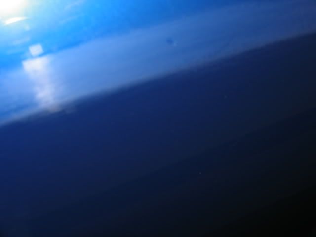

After

Pretty pleased, the chip a slightly different colour but metallics are a pig to match and this is a pearlescent paint too so even more tricky.

Dont get me wrong guys the scratches for the most part are gone but the ones that are deeper do need touched up, im happy to leave it as it is, if it were metal then I would be touching the area up.
