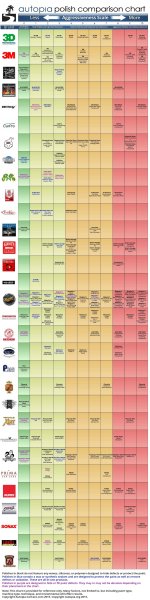

Listen to all the advice being given, we are not trying to confuse you or make things more difficult. Just break ALL the different products into 3 categories and it will make it easier. 1) Polishes, 2) Compounds, or 3) Waxes/Sealants/Last Step Products.
If you don`t already have this....here`s a copy of Autopia`s polish comparison chart.....maybe it will help a little.....
attachment.php
The test spot is where you will figure out your process for the entire car. Saying that, you can take a look at the car and sorta know if it needs to be compounded or not. Swirled up and lots of scratches? Compound. Light marring after claying? Polish. Some of these new compounds are LSP ready after use. If your car has mild scratches and swirls try one of the many AOI products. With the AOIs you can use a firmer pad to remove defects. Just don`t over think it. If it is not fun take it to a (reputable) pro and let them do it. But if I remember correctly you are doing this for resale. If I was in the resale biz it would be AOIs and call it a day. Most folks are not looking for perfection in a used car, they just want to see that the paint is in decent shape prior to purchase. My suggestion would be CarPro Essence with a microfiber pad. Essence leaves a good layer of protection behind. You could go with a cutting microfiber for more defect removal and a finishing microfiber for less severe defects.
