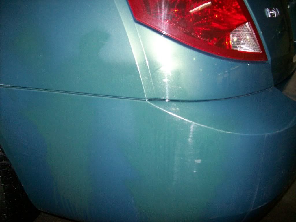

The front bumper of the vehicle was destroyed!

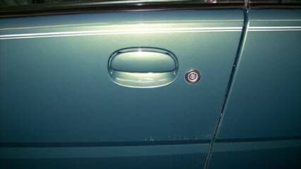

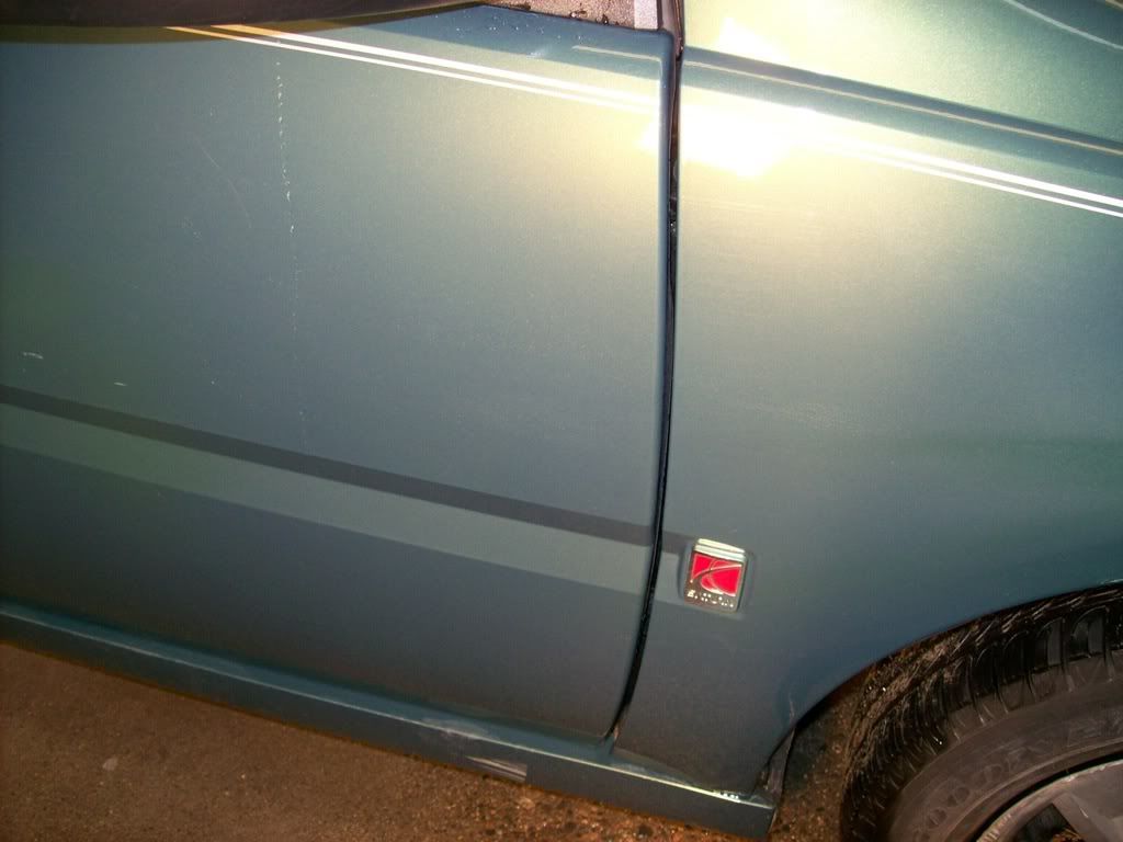

The whole vehicle had a nice "dusting" of green paint and you can tell by the pictures that it made the whole car look very flat!

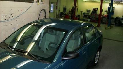

After (not sure why this picture looks dul too, that paint is like glass!

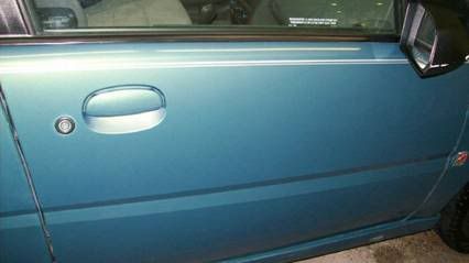

After

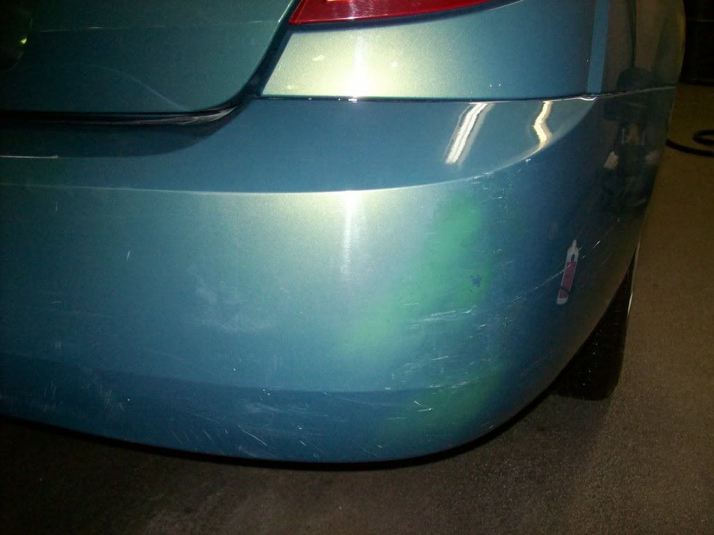

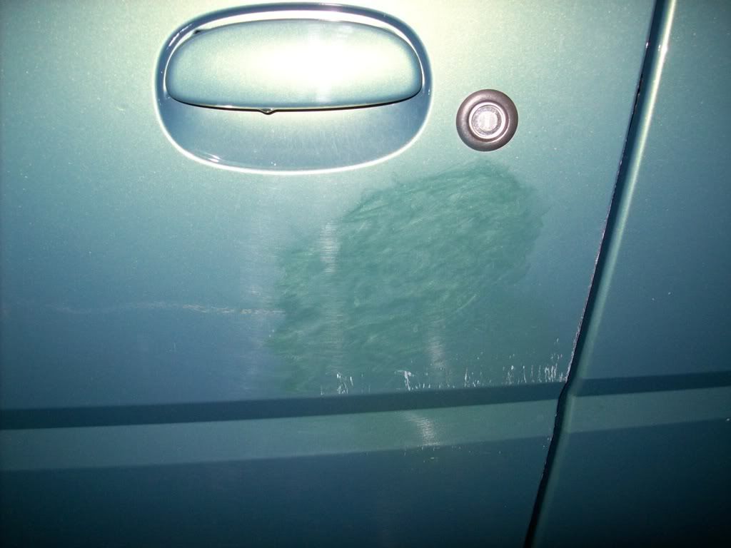

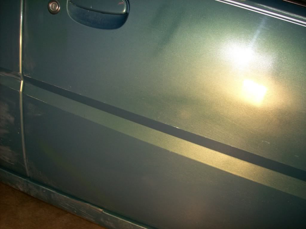

Here's one of the worst spots. The spraypaint in that picture is THICK!
Another bad spot

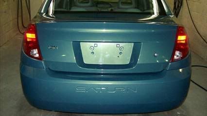

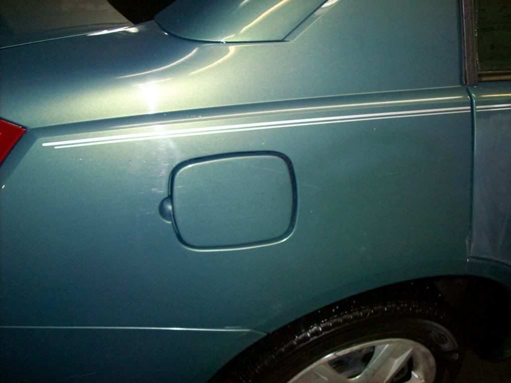

Heres the rear bumper...

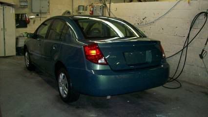

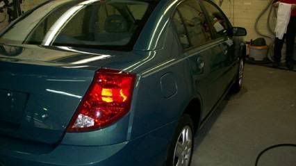

Heres a few afters, for some reason the person who's camera i was using downsized all the afters....
I will see if i can get some Decent outside pictures, Not much sun here in the winter months :(
This car was very bitter sweet for myself, i was not happy with the final outcome (ended up putting a bra on the front end) however i felt it was a fantastic turnaround!
everything from the pinstripes down was dusted! the only real damage i could find under all that spray paint were minor scrapes and ALOT of white paint transfer, this could have all been averted had they just removed paint transer!

One suggestion... get some better lighting (halogens would help) for your picture taking. The after shots are way too small and hard to make out which is a shame because it looks like you did an amazing turn around.
