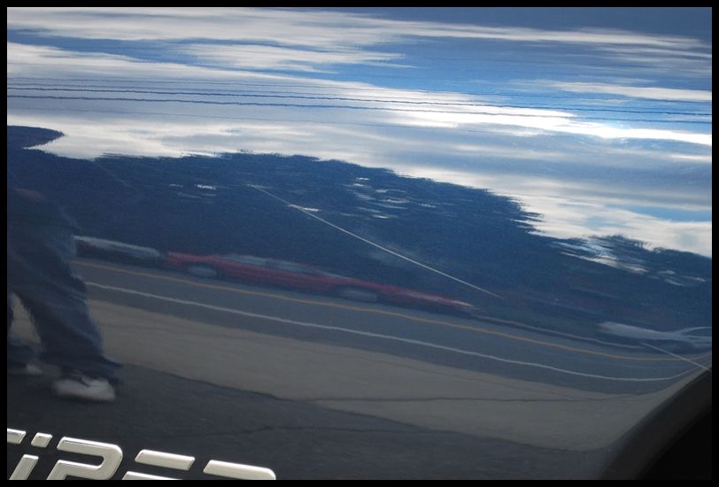

As you can see, there were some pretty good scratches scattered all over the car and some heavy swirling. I was hoping for a quick 2-stage polishing treatment, since the owner told me not to go crazy, but as soon as I started polishing, I quickly remembered how hard Viper paint was. Since a 2-stage wasn’t producing the results I was hoping for, I ended up moving up to a 3-stage polishing treatment to get the car looking its best.
I ended up polishing the complete exterior with Menzerna Power Gloss compound using an orange pad on the rotary, followed by Menzerna Super Intensive Polish using an orange pad to remove all of the heavy defects. For the last step, I used Menzerna Power Finish on an orange pad via PC7424XP. Blackfire Wet Diamond was used as the LSP.

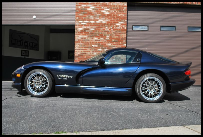

Here are the final results…

Jakerooni- Thanks a lot Jake! Yes, the Viper clear was definitely harder than I was expecting. Overall, it was nice paint to deal with, but just took a little longer than I expected due to the harder paint.

Man was that thing hammered. He should have those wheels stripped and painted like the ones on your M, that would looks pretty sick.
It sure was! He told me he was planning on getting new wheels once this set of tires were junk. When he left the shop, be burned rubber all the way down the street! The car is a BEAST!! :)
