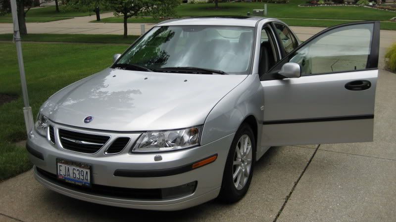

My first detail of a silver metallic car. Just happens to be a family owned Saab. The paint hasn't been maintained since new, except for an occasional wash.

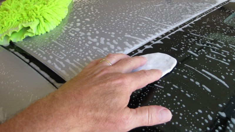

Clay & Wash - Simultaneously ( I prefer it that way)
Megs Gold Class Shampoo. I wanted lots of lubricity and foam for the clay process.

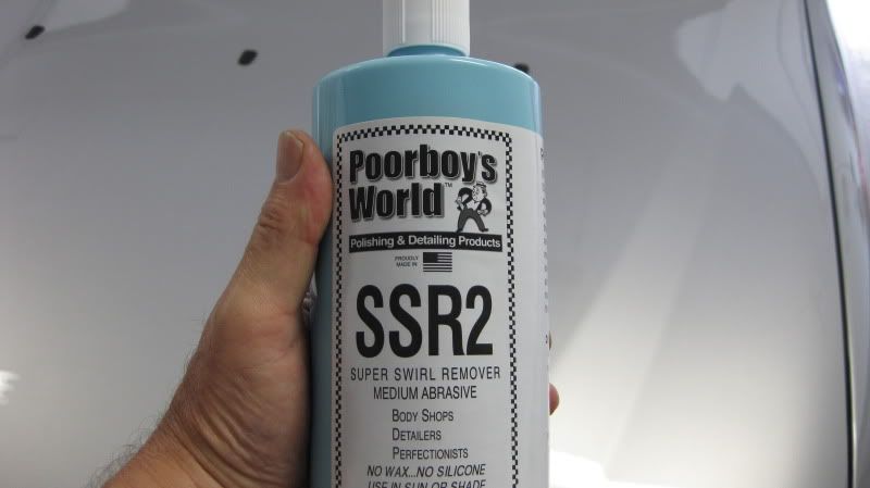

Swirls and scuff marks removed with SSR and a PC.
Polished with 3M Professional Finish. 12 hour cure.
Two layers of DP Max Wax with 8 hours cure in between.

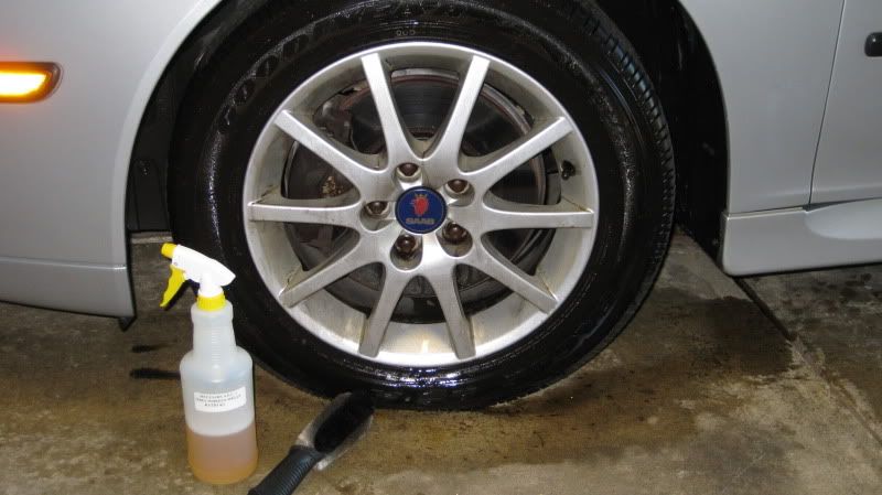

Wheels, Tire and Wells. Took major elbow grease to remove the built up grime and brake dust. But, I'm very pleased with the Megs performance.
Megs APC+ 4:1
Wheels - DP Wheel Glaze
Tires - System One Licorice - Two coats
Wells - A cheap tire spray from Advance Auto, worked in with a brush and wiped down.

Clay treatment while washing the car.

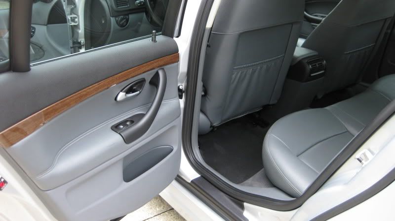

Interior Leather & Vinyl
Cleaned all vinyl and leather with Megs APC+ 10:1 and allowed to dry.
Vacuumed carpet with Metro Vac. Nice to own a powerful vacuum. It lifts the carpet off the floor with suction.
Cleaned all carpeted area with Megs APC+ 10:1
Extracted moisture from carpet with ShopVac.
Dressed all leather and vinyl with DP Interior Protectant. Two coats, second coat buffed until dry.

Clay treatment on glass.
Nasty wheels and tires no match for APC+
SSR Complete
Leather & Vinyl Complete. Check out the door jambs.

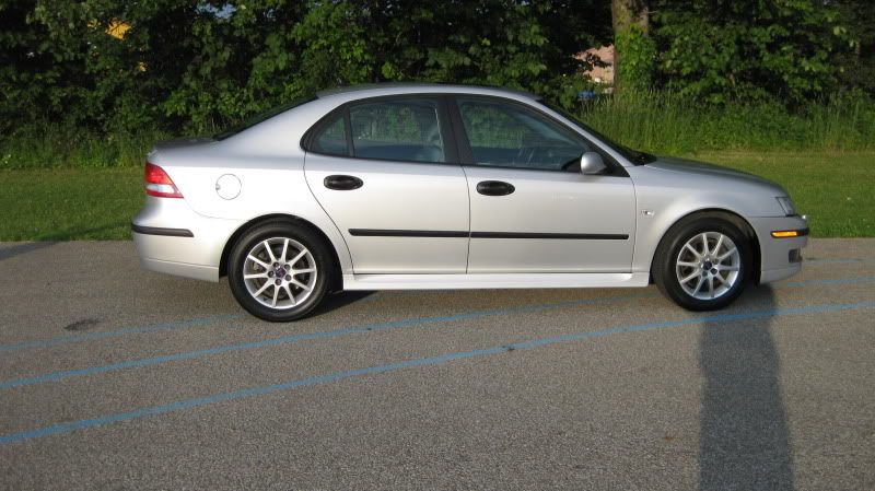

A few photos of the finished detail
Hood photo with rain clouds above.
