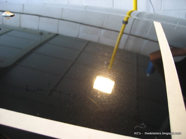

paint before correction - after wash & clay
unavoidable swirls , RIDS & water mark

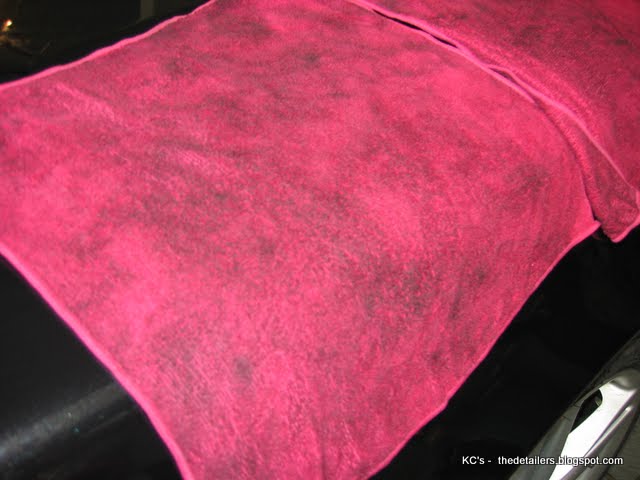

mostly contributed by the choice of cloths - esp - good morning cotten terry towel - ta da
as for me - i would choose plushy microfibers towel - contaminant pick during wash
surface contaminant pick during clay
otherwise it will be push further in when correctional carried out - removing the root cause

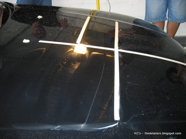

paint issue - to be corrected

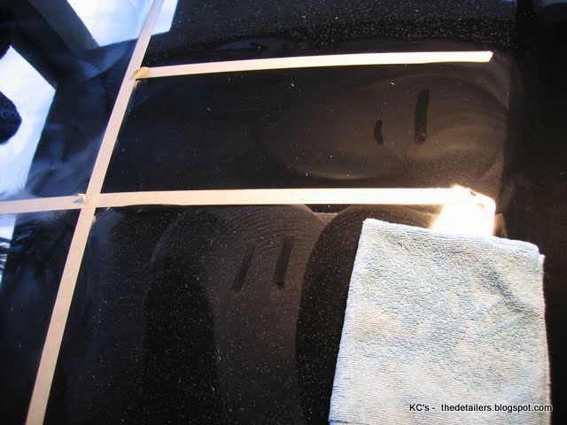

what we did was to segregate a few areas to test out the product & how it react over certain machine reaction
1st area for waxing with rotary
2nd area for consumer product with DA- basic polisher
wax applied prior polish
on rotary???

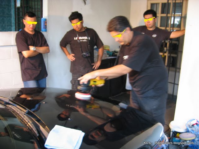

our host is given a chance to kick start 1st
2nd area for consumer range product
our pro - amateur detailer to be 2nd in line
look at the 123 steps of applications - in sequence
massage in like KBM - 3/4 twist with yr pure hands -

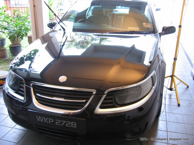

before pic

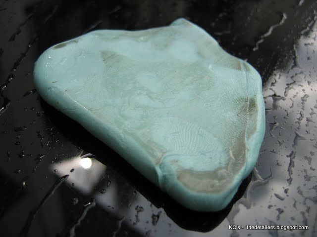

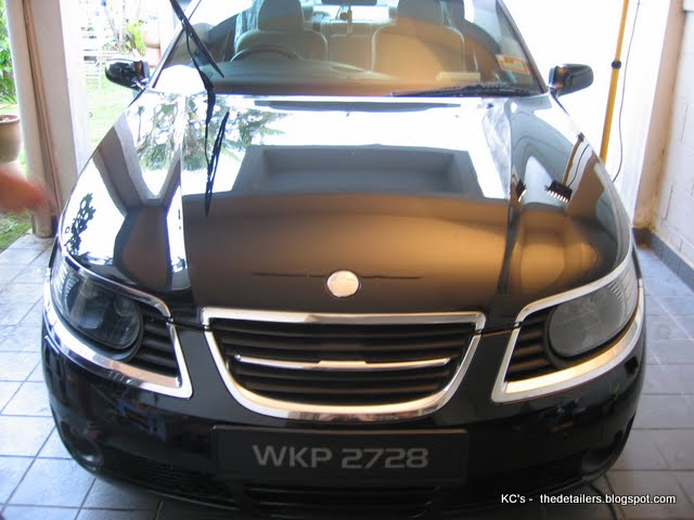

a 50/50 % compassionate before & after from left angle
on rotary???

1st area Wax with china make rotary???
hologram was visible once we remove the wax

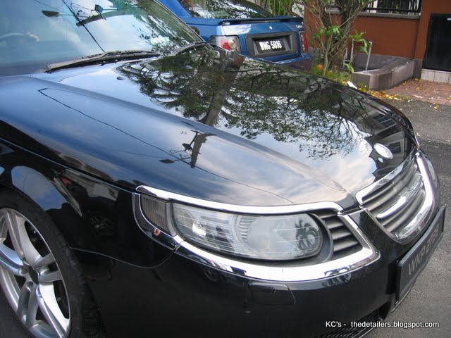

before
after wax by rotary
after

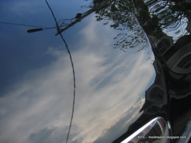

gloss restore
eleggantly yours
reflection
gloss
