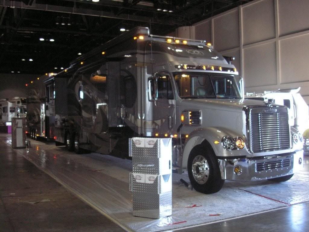

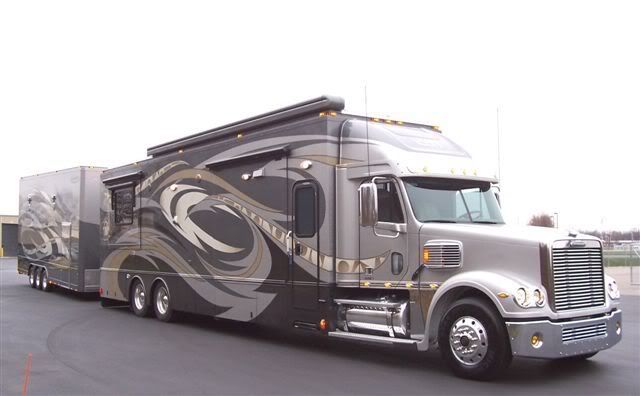

well it may be 77 feet, here are some photos. They want quotes for in and out, exterior only and for wash/dry/light polish on the chrome I am almost hoping they go with just wanting an express type detail because this thing does look a bit intimidating, let me know your thoughts
