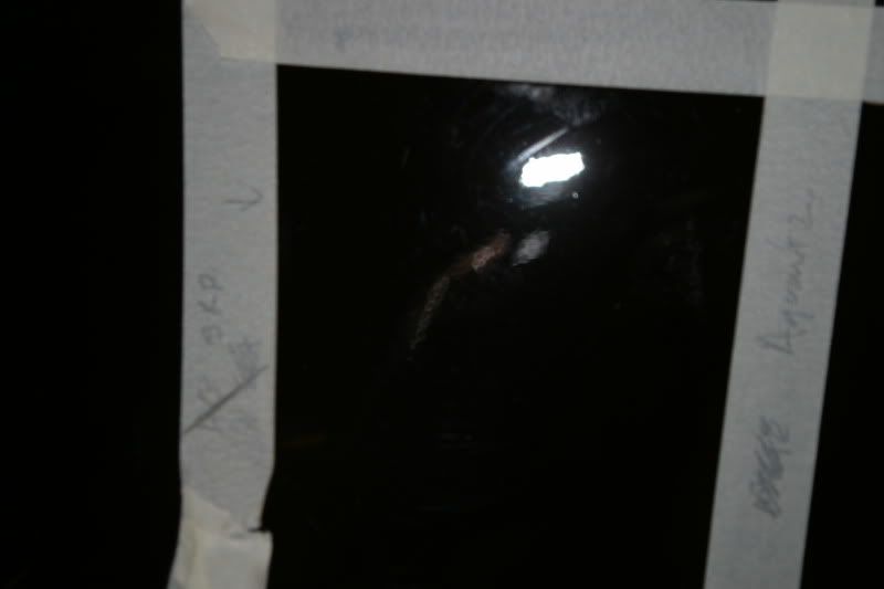

First up was AG SRP.
The before picture actually looks quite horrendous :confused: which I suppose it is ! I used SRP with the rotary at speed 900rpm as many of us on this forum would use it via machine. I would have done it by hand but to be honest I don't think a lot of people use SRP by hand once they have been on DW or Autopia for a while.
In addition, most of Joe public wouldn't use these products until they knew a little about detailing. So I presumed this would be acceptable.
Quite staggered by the finish, I stopped half way and noticed circular clear coat damage from the SRP so this is certainly more aggressive than I realised it has since been upgraded to sit next to 3m UF.

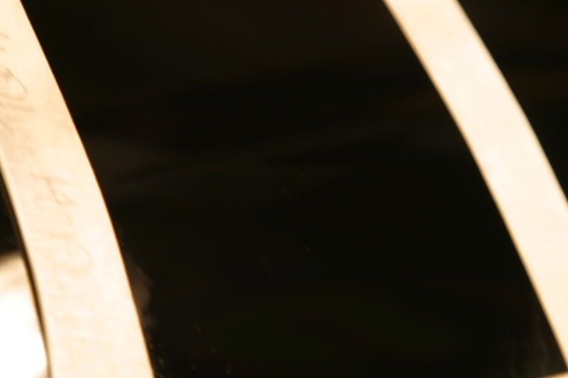

So next up is Aquartz
Obviously this is not a glaze but I had to include it as this test stemmed from my original post. Aquartz did what it was supposed to do, left a noticeable layer, I could spot this as I stopped polish to the tap as I was dragging the cheap glue from underneath. There was a certain difference on the coated and non coated area.
Very happy with the results did what it was supposed to do, funnily enough in the detailing world sometimes this is hard to find.

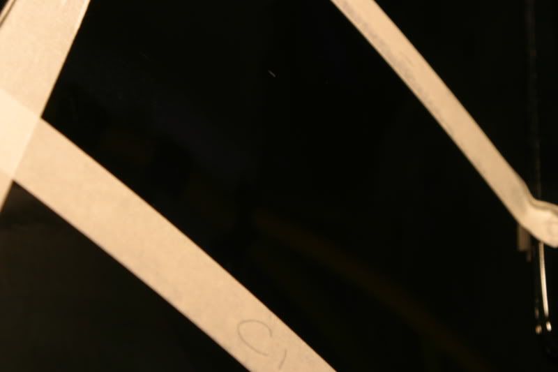

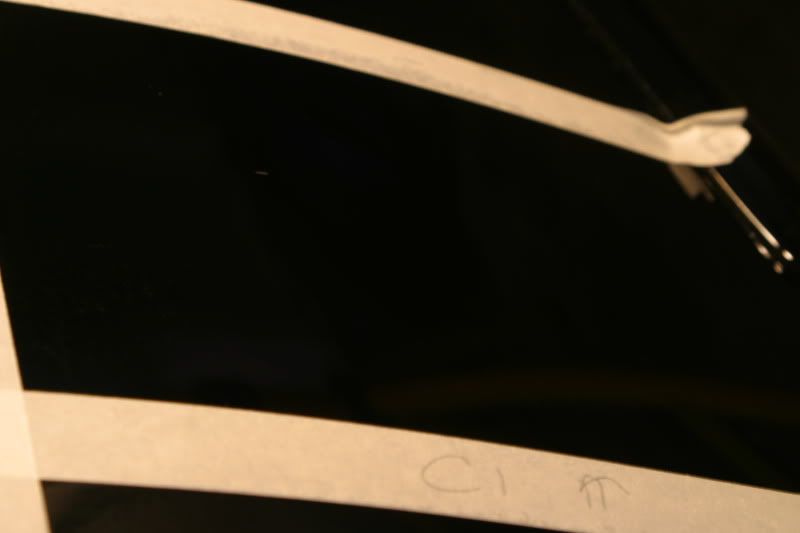

C1
This again was just added to compliment my other test. This appeared to actually fill some minor marring
Before
After

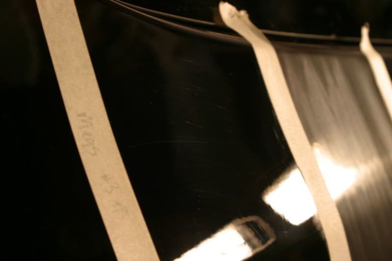

Megs no.3
This is a paintable glaze. It really cleaned the paint up but it didn't leave any "glaze" behind as the name suggests. EPIC FAIL.

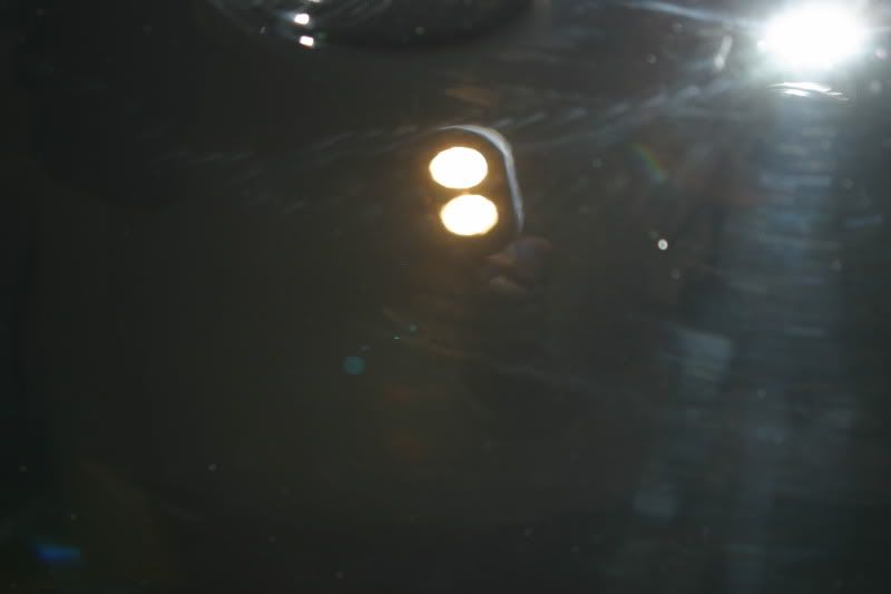

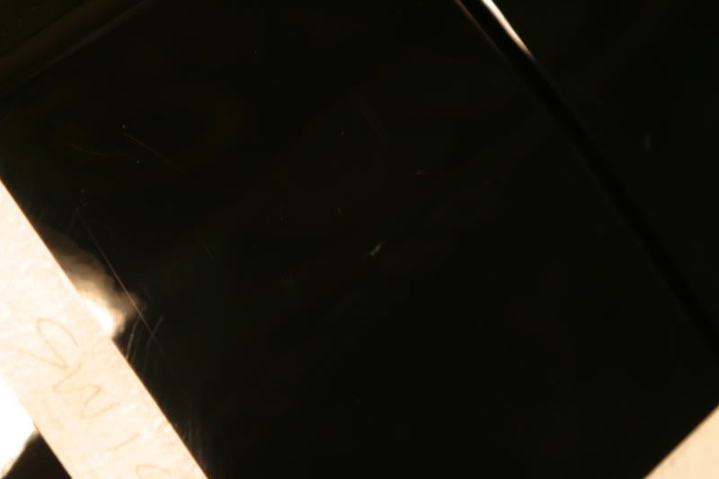

Poorboys Blackhole

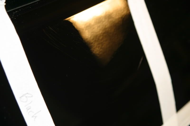

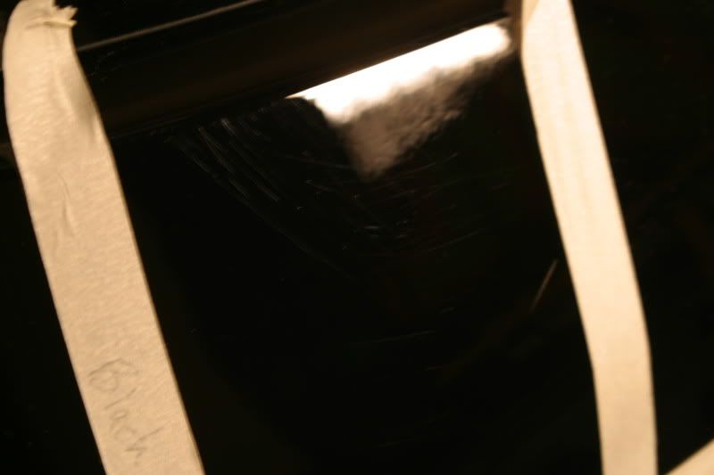

This is a product I have tried umpteen ways. I tried by hand today to see if it helped any !! This with a doubt leaves a very smooth finish but I really don't think it is worthy of such a good reputation.
I have tried via, Rotary, Hand and PC. Everytime it does the same thing, masks the light marks but somehow makes the larger swirls seem worse. Exactly like this.
Before
After

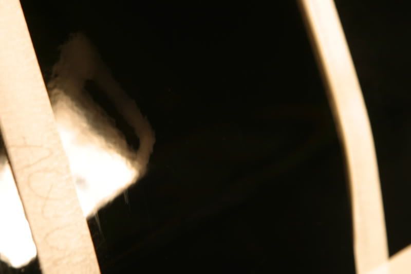

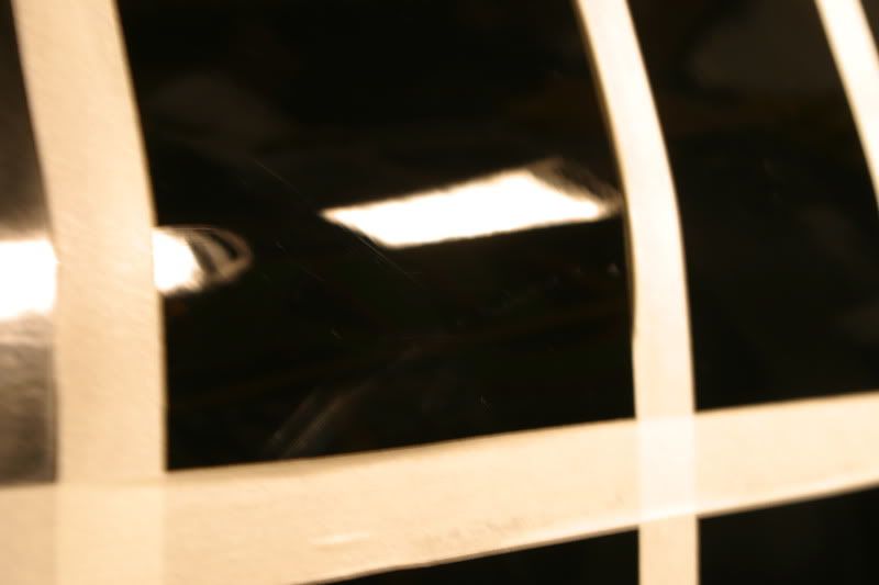

Next up was the Swissvax Pre Wax. I thought this would be similar to zymol, it is NOTHING like it. Very runny, very oily, long work time.
I actually wouldn't mind trying this on the whole car to help feed the paint, its a great wee product. Masks some swirls not much but I just liked the high oil content especially the fact I snowfoam the car every week.
Before
After
