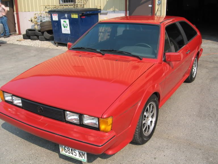

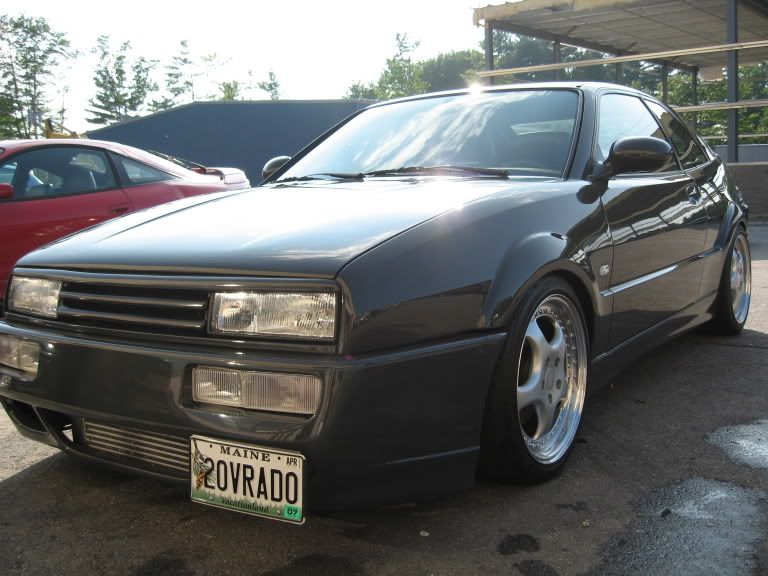

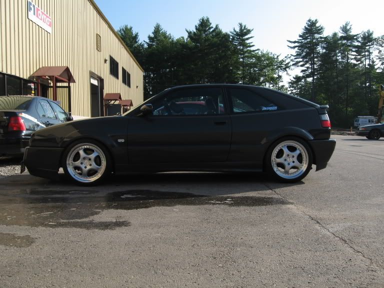

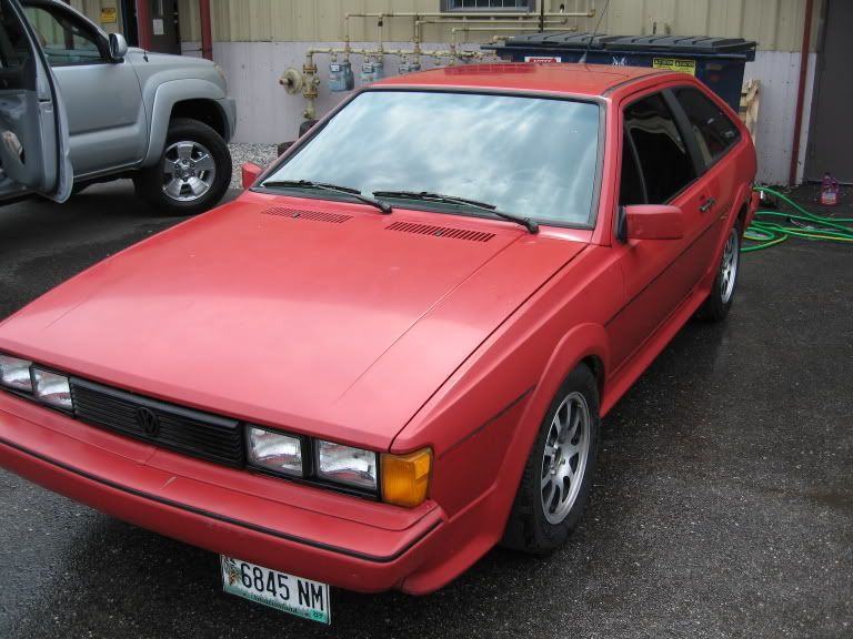

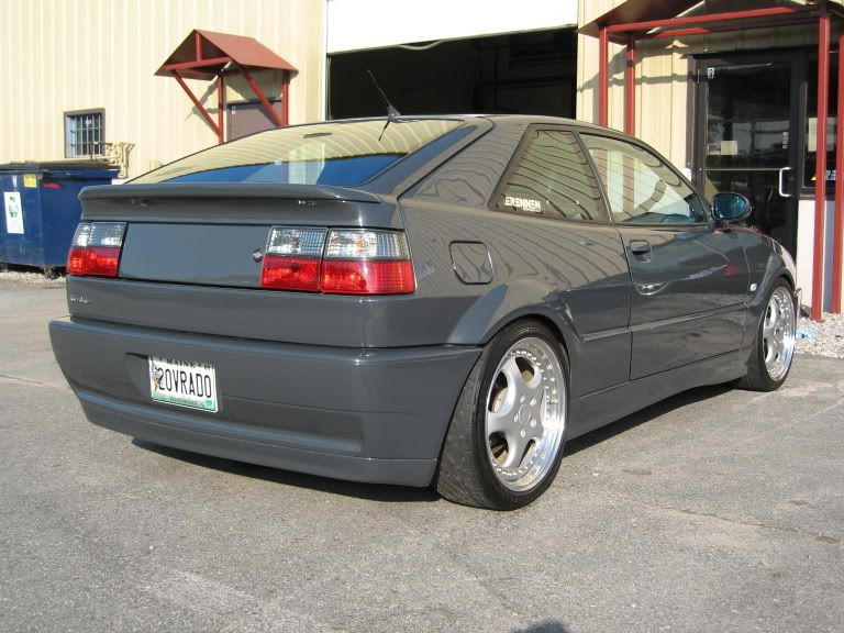

The scirocco was just neglected as you can see. The Corrado was painted by the owners body shop who rotary compounded it and left it at that. The Titan went down to narrow of a path, And I have no Idea with the Tahoe.
The scirocco:
the bad spots like the hood I started with Pro swirl remover and a rotary
then the whole car got a few passes with Pro duz all with the pc
Followed Pro swirl remover with the PC
P21s
The Rado(very hard clear):
I started the hood with pro swirl remover and the rotary
pro clearcut/duz all mix speed 6 with the PC (white pad)
Pro clearcut/duz all mix speed 5 with the PC (white pad)
Pro swirl remover speed 5 with the PC (black pad)
Pro satin cream

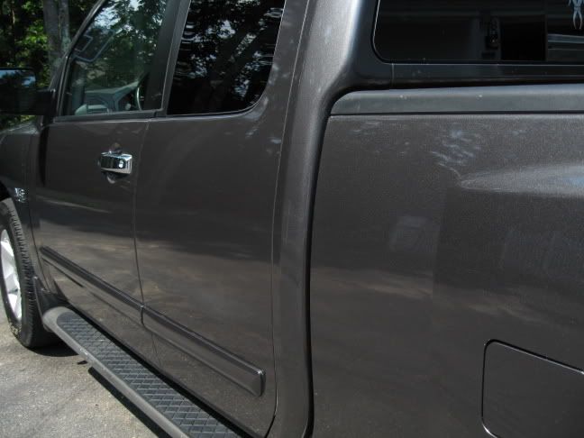

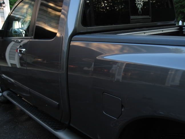

The Titan. Bad before shots but the scratches looked like this head light to taillight on both sides. alot of them would catch your fingernail.
Pro clearcut/duz all mix with the rotary and yellow pad alot of passes (the whole truck)
Pro swirl remover with the rotary and black pad
Pro swirl remover with the pc and white pad very slow passes
Pro satin cream

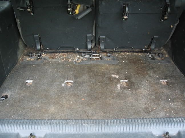

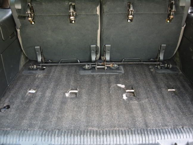

The Tahoe:
Vacumed, HP air and Pro heavyduty interior cleaner
Pe treated with greased lightning/a little HD cleaner/water and scrubbed for a second.
Then extracted with my durrmaid
