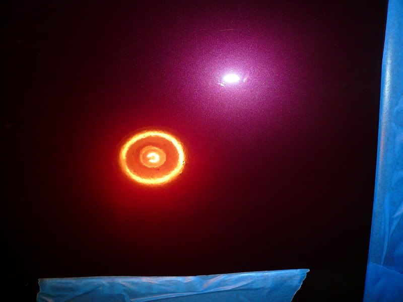

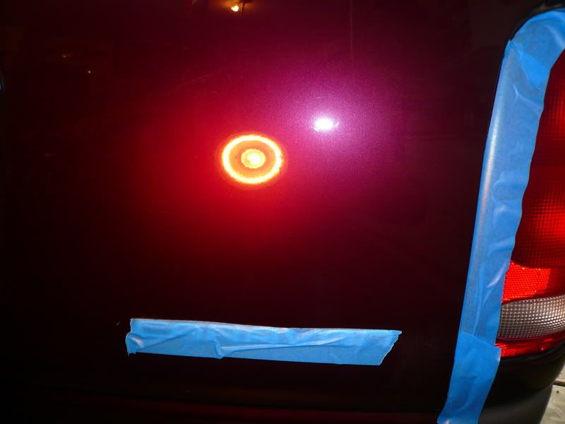

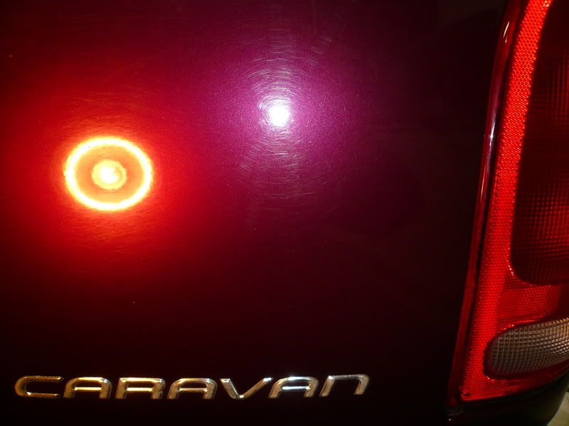

Sorry if I'm in wrong place, but I thought I'd add.......water should NOT be used to prep your pad. Instead try ONR/QD strength or clay lube. Works fine with IP/LC orange. Just did my wifes DD.............pics coming
BEFORE........
after...
ANYWAY........hope that helps One pass with 5 1/2 " LC orange pad w/PC IP
