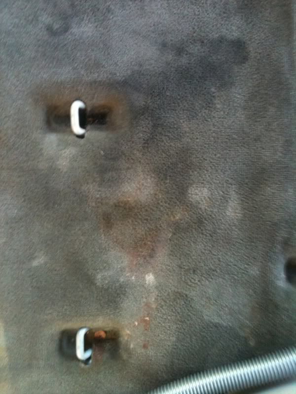

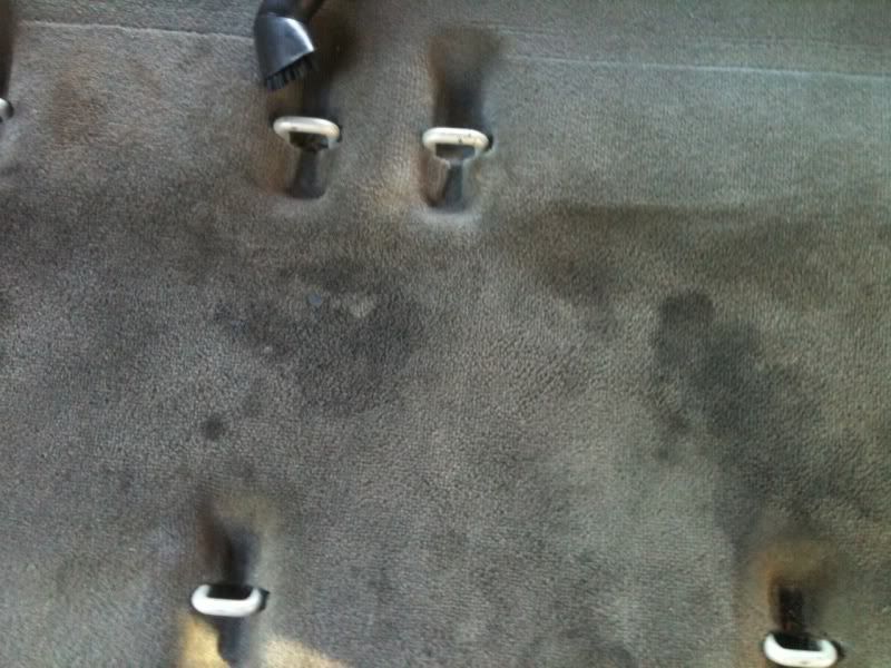

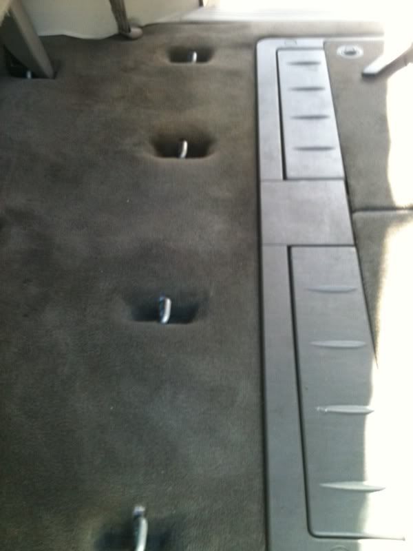

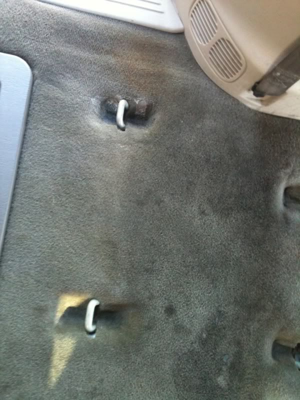

This was just a test Van I did that was trashed and I put my skills to the test to see how I could make the interior look because it had SOO much trash and food and candy all melted and stuck in the carpet and on matts and I got it all out! Whole interior had to be scrubbed. All surfaces I did with a tooth brush and a little bit bigger brush and some APC as to dirt was in each of the crevices of door panels and on the dash and what not.
Here was the interior carpet of the van I got most of the staining out. Its hard to see in the pic because of the shadow which makes it still look like the rug was kinda stained. But in person it looked 10X cleaner than before!
Before!!
After!!

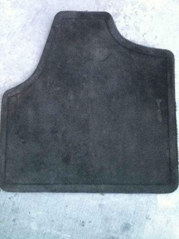

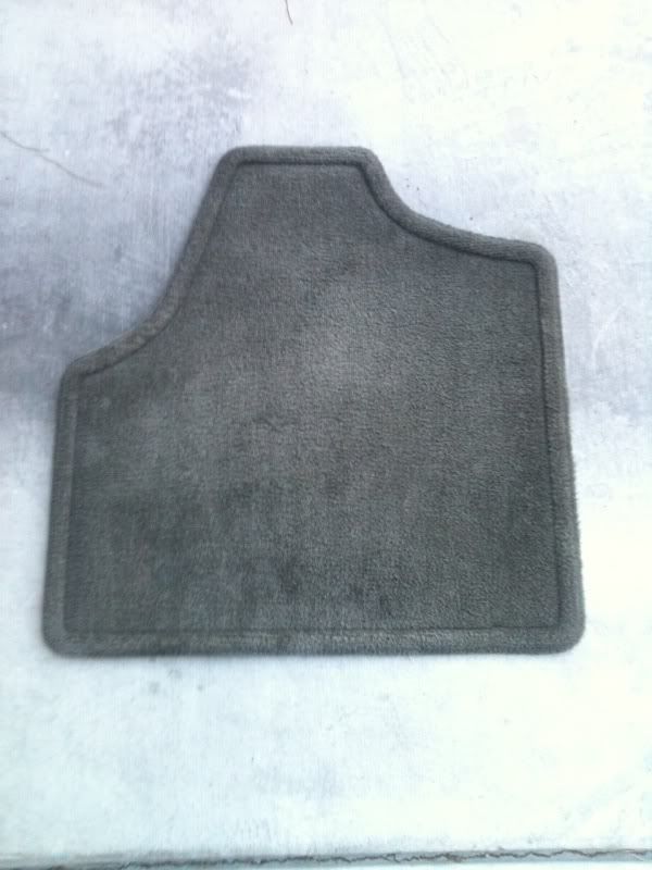

Here is one mat! This was one of the cleaner matts in the car as well/
Before:
After:
