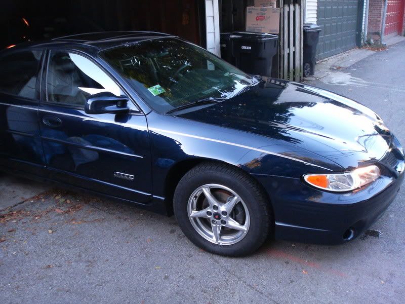

Maybe its because its dark in my garage, and I dont have any sunshine reflecting on it. I will need to take it out of the garage tommorow, and get a close look at it. It does look good, just not what I expected. The vehicle is a Blue 2001 Grand Prix GTP.

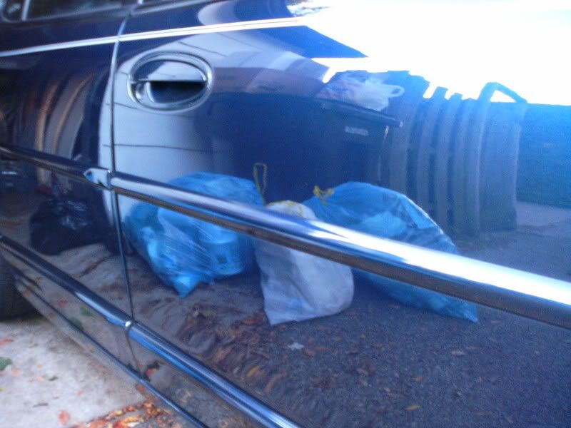

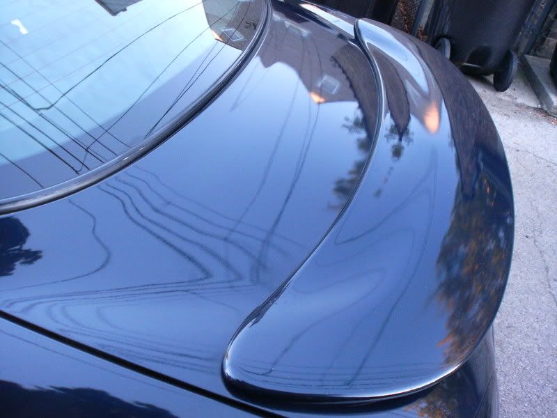

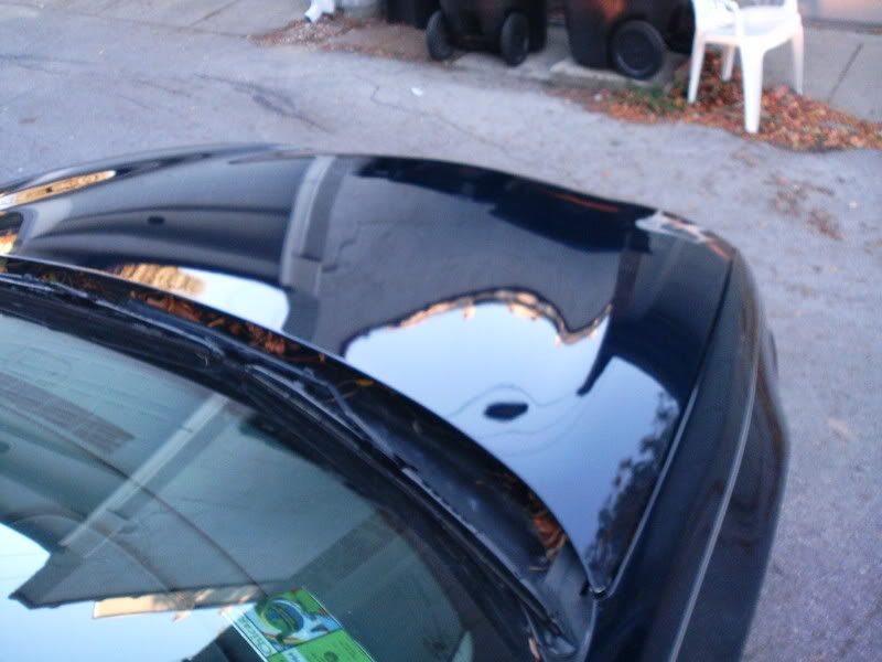

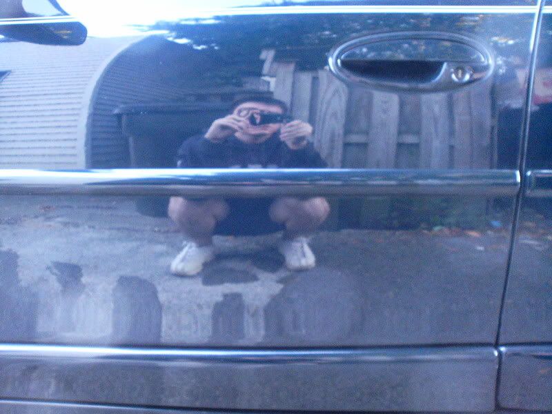

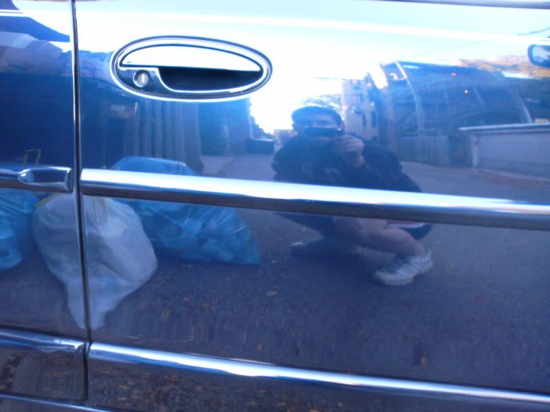

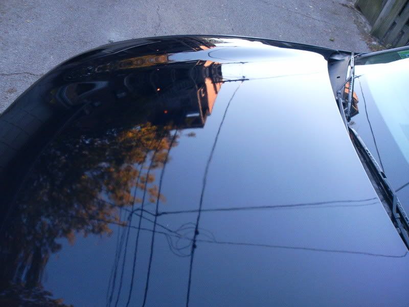

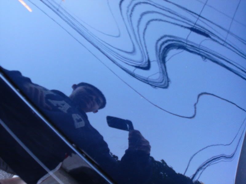

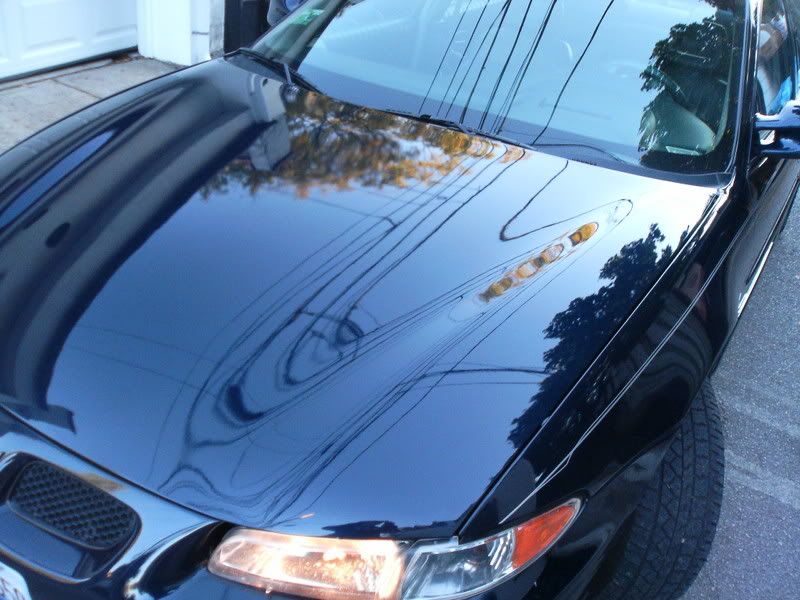

Some pics from the morning. I guess it does look better than I thought.
What do you guys think? Not bad for my first time doing ANY type of waxing, polishing, etc. Oh yea, I do know how dirty the rims are..I wasn't focusing on them, I was just playing with the PC to get a feel of how it works before I try it on my car.
hello,all you need to do is ues the carnuba wax after all of your steps,,,,trust me throw ,the turtle wax to the side
:bigups hello,all you need to do is ues the carnuba wax after all of your steps,,,,trust me throw ,the turtle wax to the side:bigups
Clean the wheels and dress the tires and I think you're set. Find some nice scenery and some sun and snap more pics.
