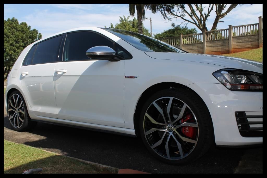

This beauty was brand new... less than 600km's on the clock..... plastics covering most of the interior.....and that new car smell - I reckon if you could bottle it, you'd be a rich man :lol:
So the objective of this detail was slightly different to my 'normal' work....
Despite the owner insisting on not having the vehicle washed by the dealer, it was.... and so the plan was to clean and decontaminate everything, give it a very light polish and protect it. The owner takes good care of his cars and really needed a decent base to work from... unfortunately 9 times out of 10, you won't get that from the dealer.

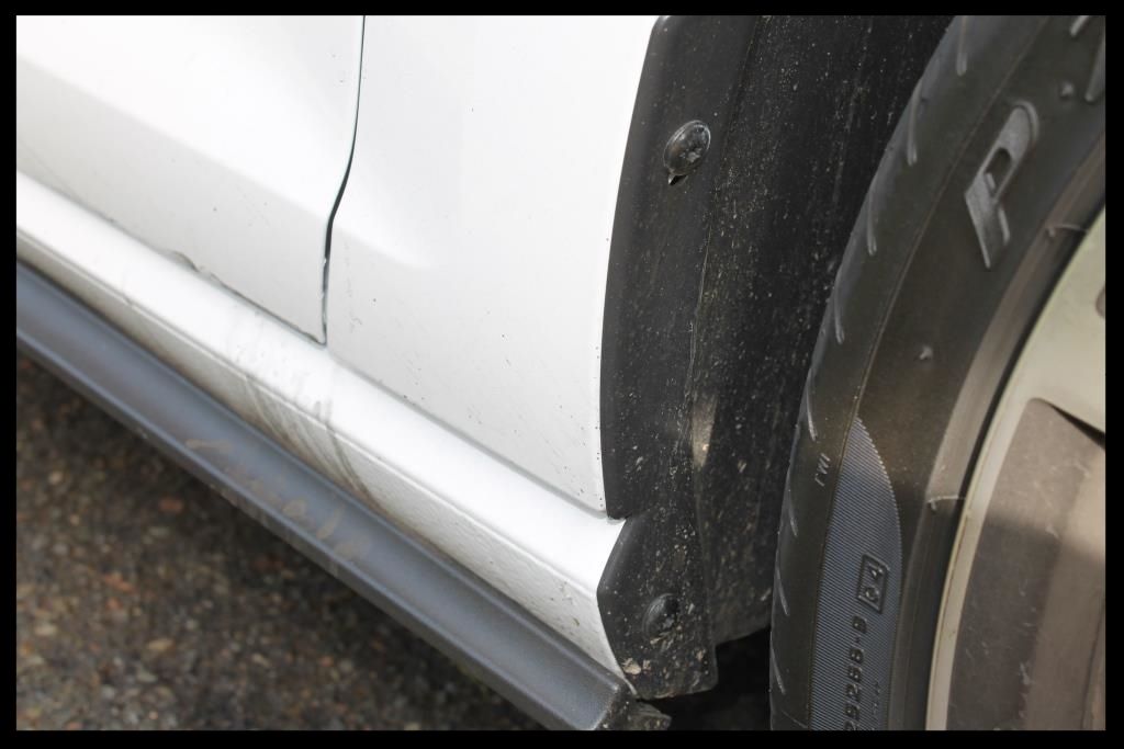

As you can see the wheel wells needed a clean

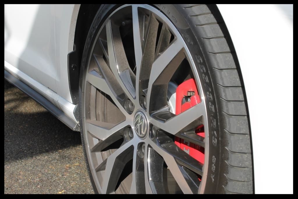

As did the tires, wheels and brake calipers

This is how the rear wheel looks before

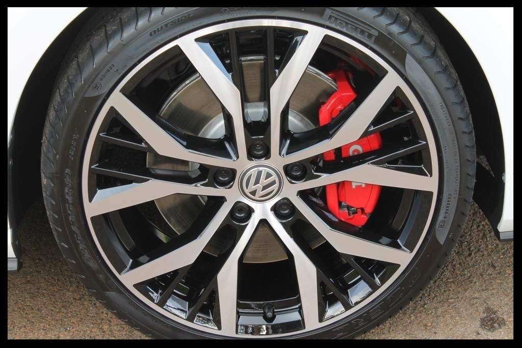

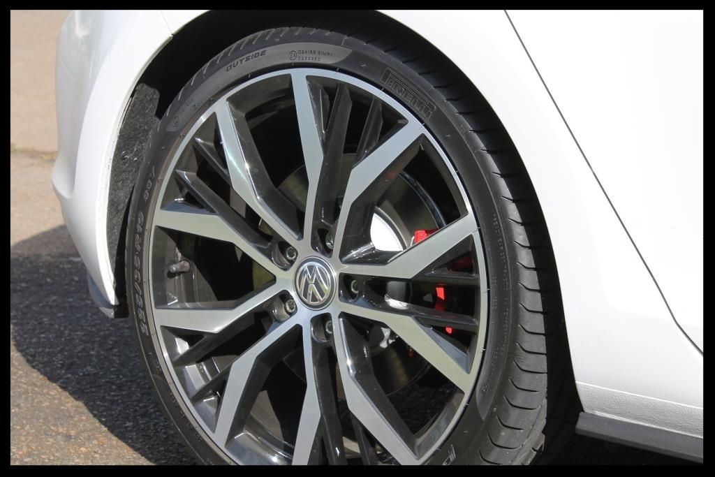

I then sprayed some APC into the wheel wells, let it dwell a bit, agitated with a Mothers Fender Well Brush and HP rinsed it. The tires were cleaned twice with Valet Pro Billberry Wheel Cleaner and HP rinsed. The wheels were then cleaned using Valet Pro Billberry Wheel Cleaner, HP rinsed and dried. Valet Pro Citrus Tar Remover was then sprayed and the wheel wiped down with a clean MF towel. Valet Pro Dragon's Breath was then used to ensure all the embedded iron contaminants were removed. The wheel was given a final HP rinse, leaving them looking like this.
The process was then repeated on all 4 wheels.

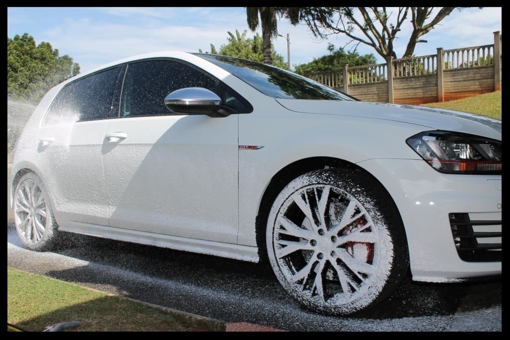

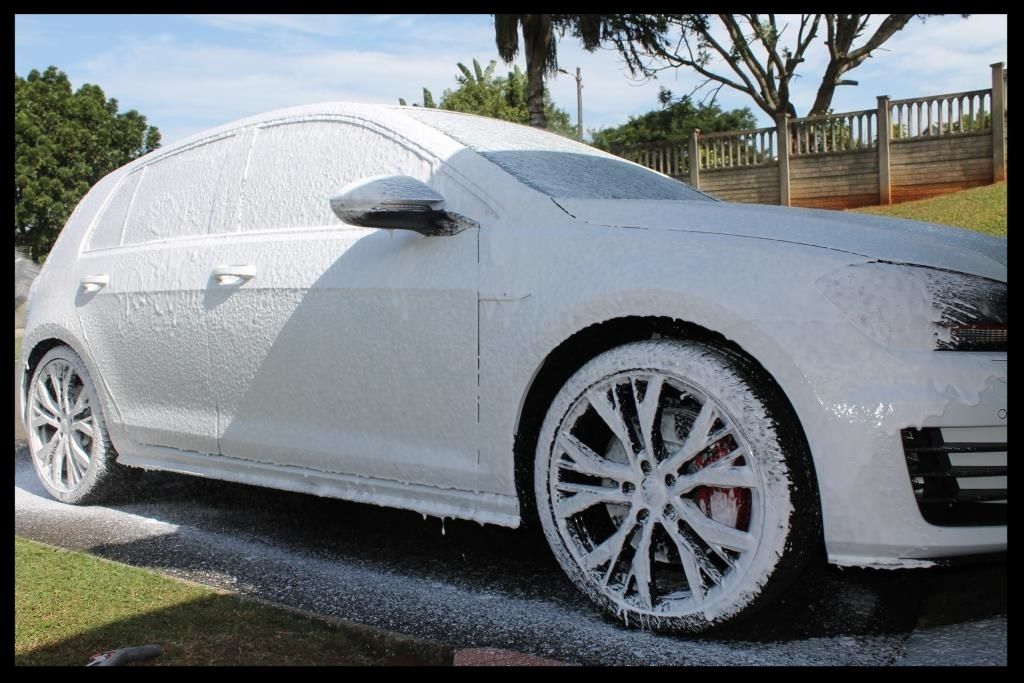

First I gave the whole car a thorough HP rinse working in a cross hatch pattern making around 3 or 4 passes - the idea is not simply to wet the car, but rather to try and remove as much of the 'loose' dirt as possible - once its on the floor, it can't be used to scratch the paint. Once this was done used a foam cannon and some Valet Pro Advanced Neutral Snow Foam to cover the car with a layer of foam,. You will see that I start from the bottom of the car and work my way up - this helps to ensure that the lower panels are getting clean/fresh foam on them, not the dirty stuff dripping down from above.
The foam was left to dwell to allow it to 'soften the bond' between the remaining dirt and the paint, allowing you to HP rinse some more dirt off the car. I then sprayed Valet Pro Citrus Prewash via a pump sprayer onto the lower half of the car to help further break down and traffic film build up.... so that when I did then perform a 2 bucket wash, the paint was as cleaner than had I just stared washing.

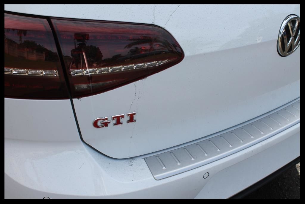

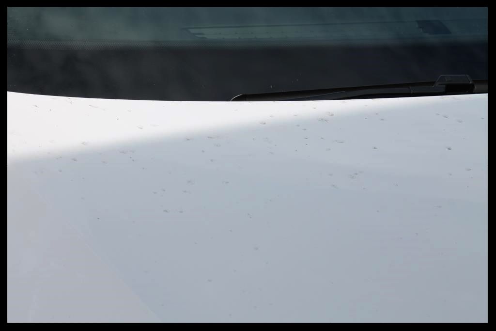

With the car clean, it was time to decontaminate it.... and yes, it had contamination..... not a huge amount compared to what I typically deal with, but enough that Joe Public would have their false belief - that a new car has perfectly clean, defect free paint - smashed. There were hardly any tar spots, and minimal iron but there was a fair amount of 'other' contaminants that required the use of a fine grade clay mitt to remove.

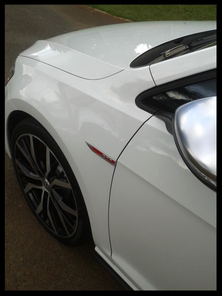

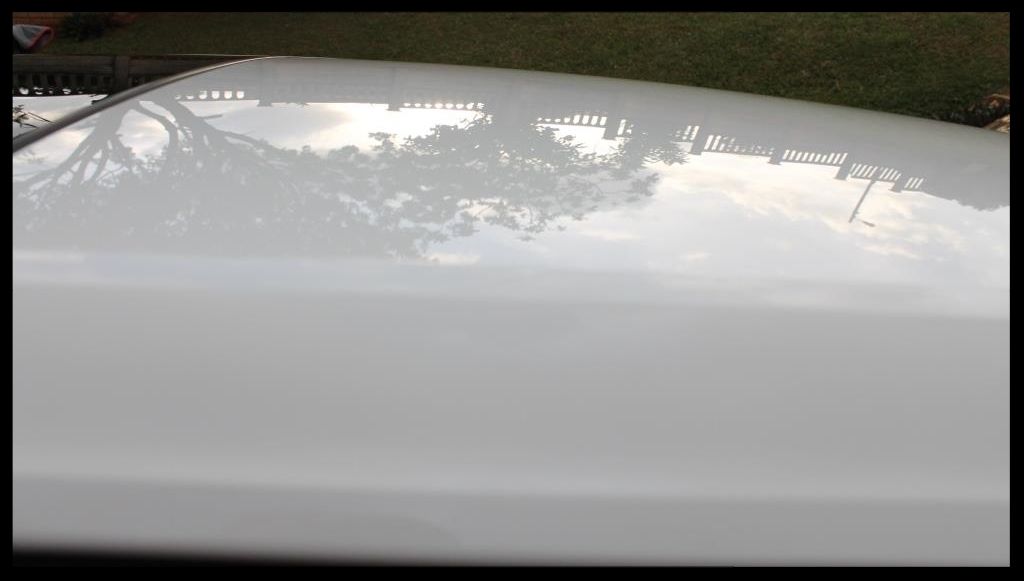

Given that the car was so new and had only some light wash marring, I wanted to use something with even less cut than my go-to finishing polish, Menzerna SF4000.... so I used some Menzerna PP Ultra, which has a cut of 2 compared to SF4000's cut of 4. I paired this with a Lake Country White Hybrid on the Flex 3401. Attempting to take any 50/50's proved an exercise in futility....

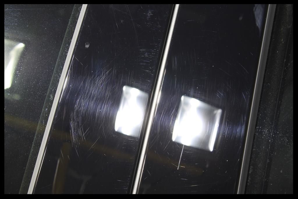

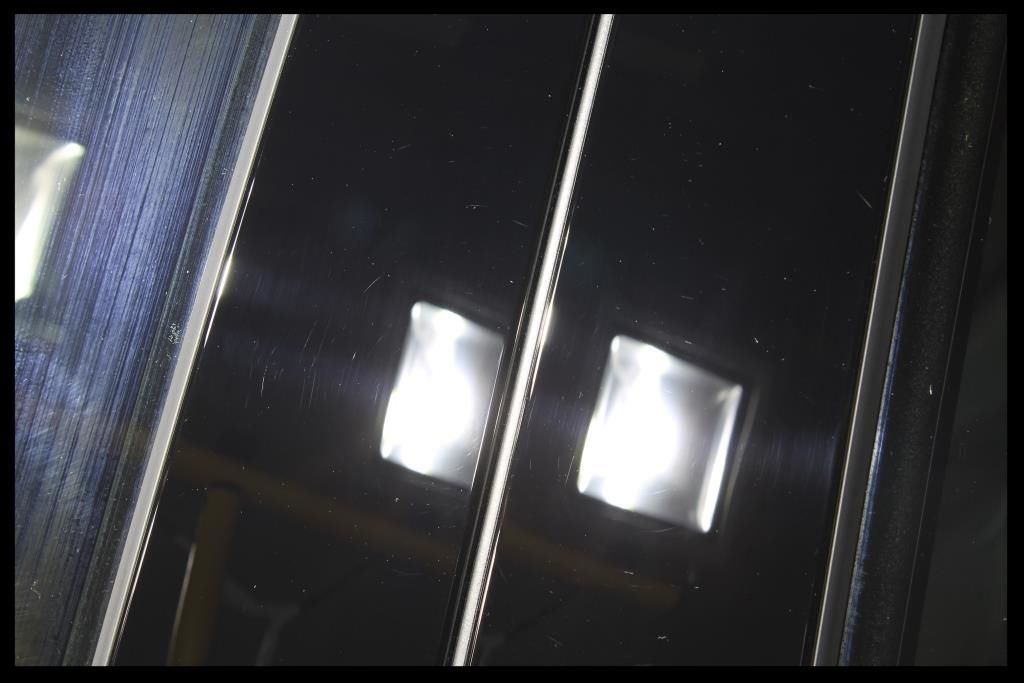

The B-pillars however, being covered in a softer paint, showed some damage.
This is what they looked like after the same combo I was using on the paint.
Although not perfect and with some hazing, it was enough of an improvement to not push any further - they will take a beating over time (as all VW's with painted B-pillars do) and the paint needs to remain as thick as possible.

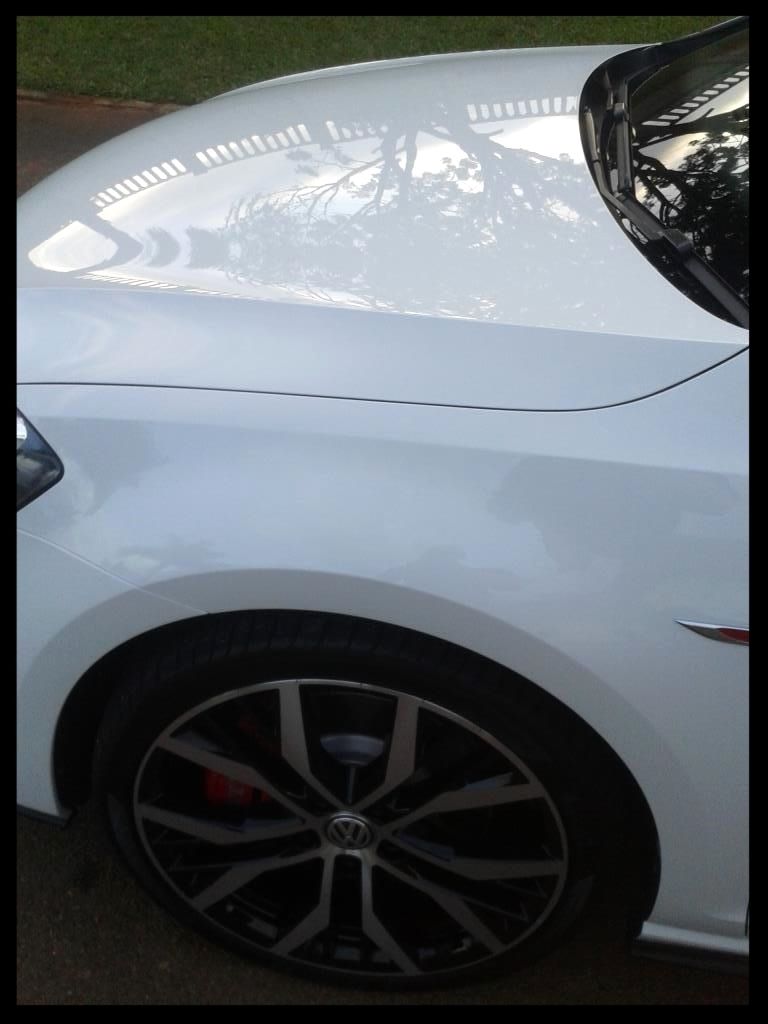

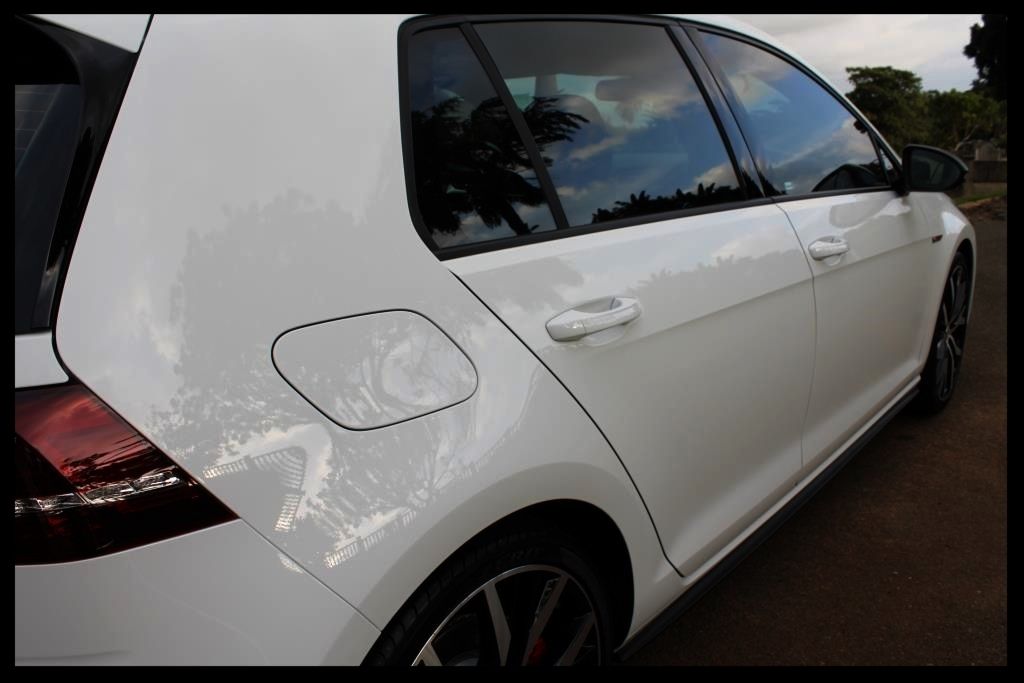

Once the polishing was completed I topped the PP Ultra with some Collinite 915 to really make the paint pop.
All the exterior plastics and rubbers were cleaned using Shield Heavy Duty Vinly and Rubber cleaner and protected using Aerospace 303. The exhaust tips were cleaned using some APC and MF towels, then polished using Meguiars NXT All Metal Polish. The glass was then cleaned using Glossworx Glass cleaner and MF Towels.

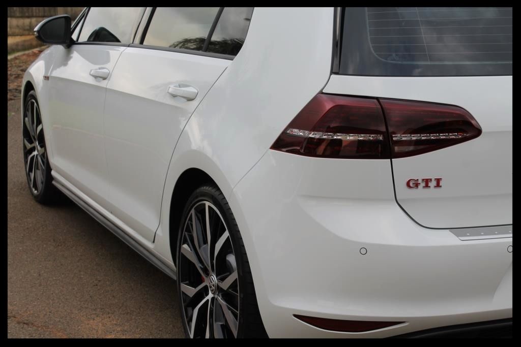

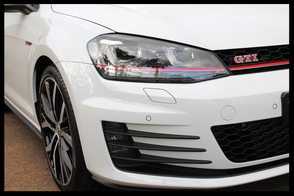

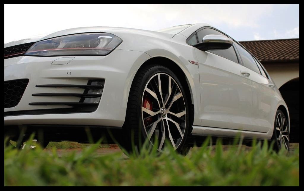

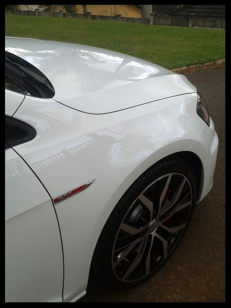

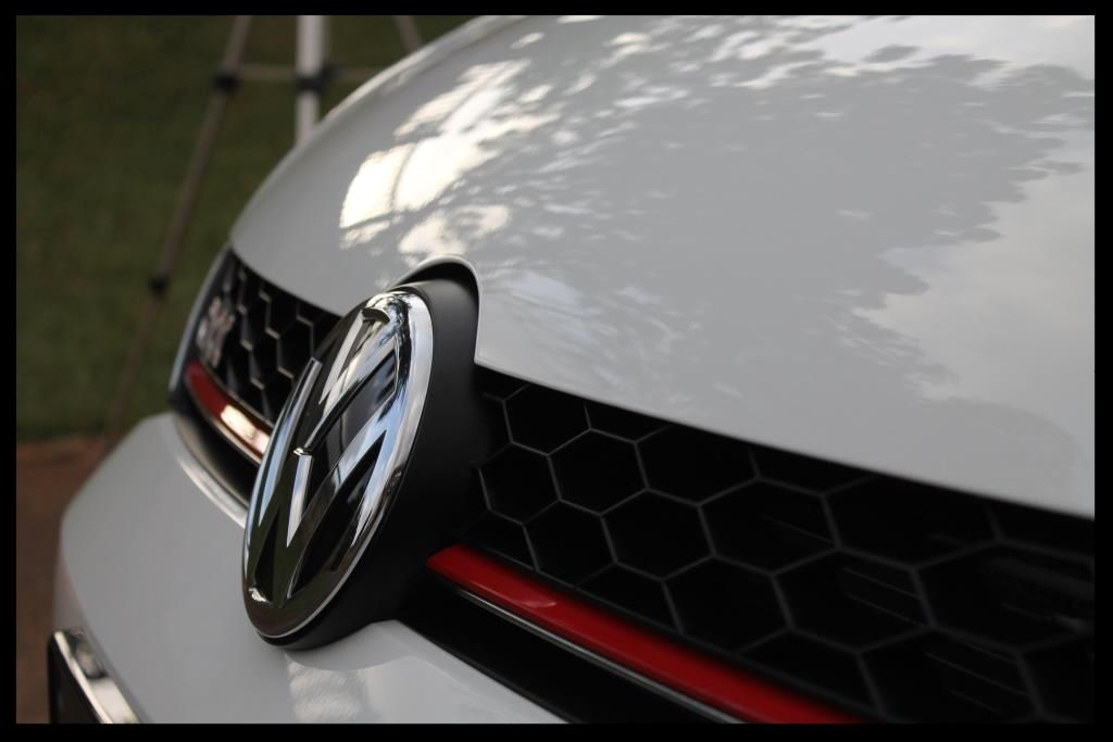

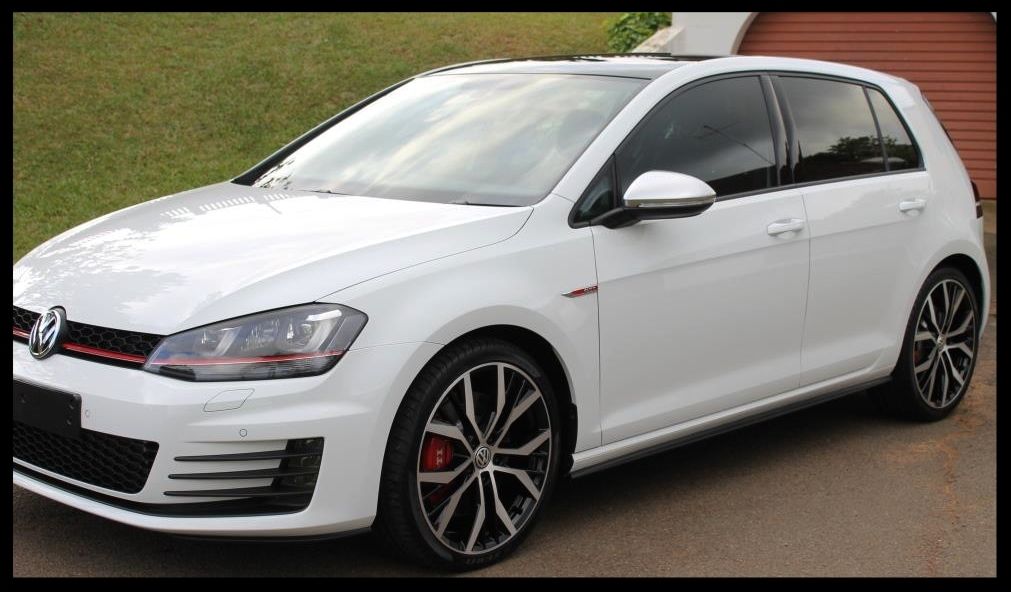

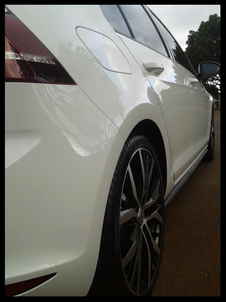

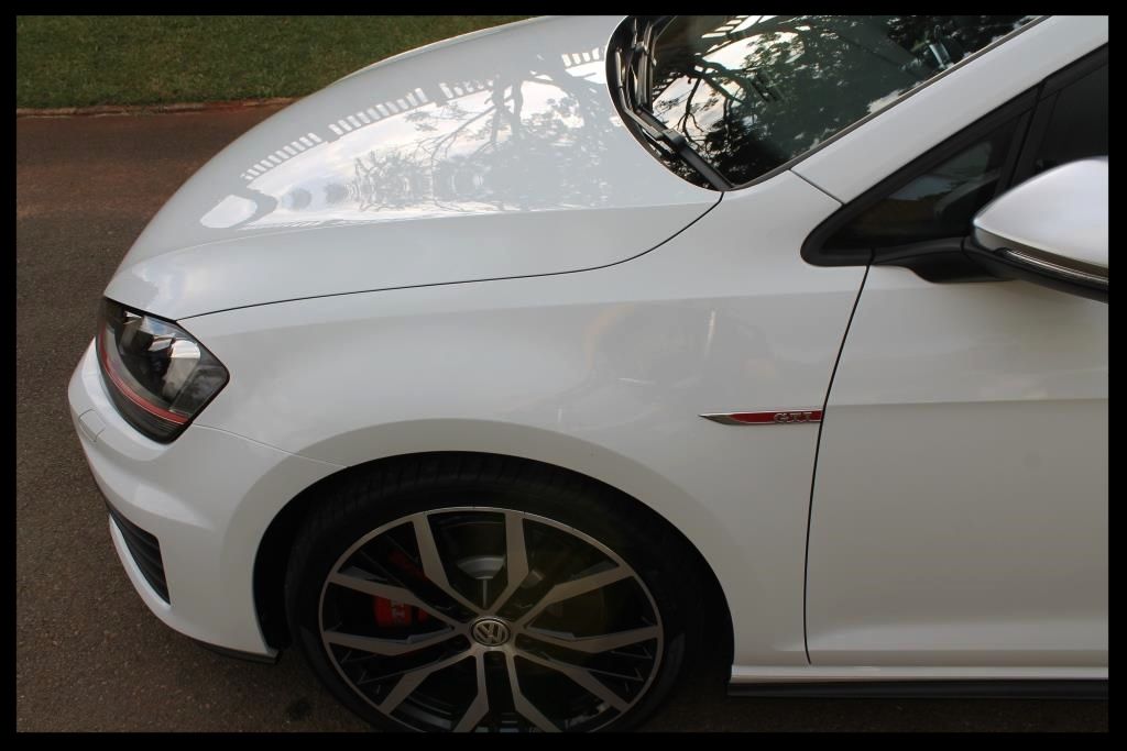

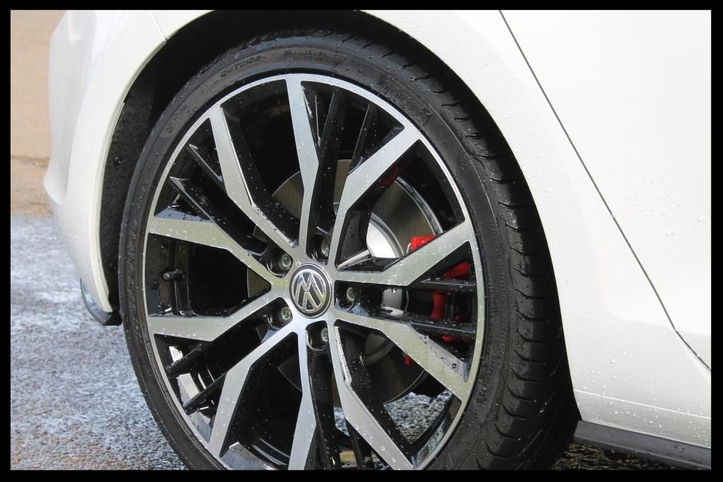

Here are a few pictures I took as the owner was collecting and the sun was dissapearing over the horizon.
