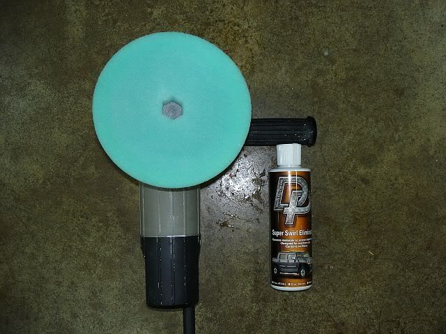

Product: The Super Swirl Eliminator is a whitish colored polish. You can feel the abrasives in it by rubbing it between your fingers. It has a light chemical smell. It’s about the same thickness as other polishes in the same general category.
Usage: I started out with an Edge light cut pad (green), but soon needed to step up to the medium cut (yellow). I don’t’ think that this was due to the polish, but rather to the poor condition of this paint. In any case, I applied the normal “ring” of product to the outer edge of the pad. I think the directions indicate the use of way too much polish (three 3” lines on the pad), but that’s just my opinion. I spread the polish, turned the PC on to about 4, worked for a minute and then bumped it up to 6. Worked a 2’x2’ section very slowly until the product started to “vanish” on me. Wiped the residue with a MF towel. It works like most other polishes I have had the opportunity to use. I guess it’s close to SSR 2.5 in abrasiveness, if not a bit more strong. Easy to work, and easy to remove the residue.
I liked the ease of use of this polish and the very easy removal of residue. It didn’t produce mush haze (if any) and I think that is wonderful considering I was using one of my more aggressive pads. It removed a ton of swirls, but I did have to work slowly, and in a lot of places make more than one pass. Again, I chalk that up to the poor condition of the paint. The product dusts very little, but then again I did use it sparingly. I assume if you used more, it would dust more. It left a nice finish and removed a lot of marring. A very good polish indeed.

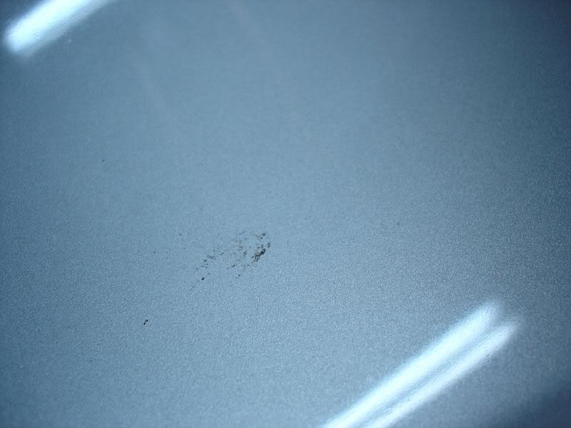

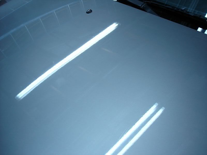

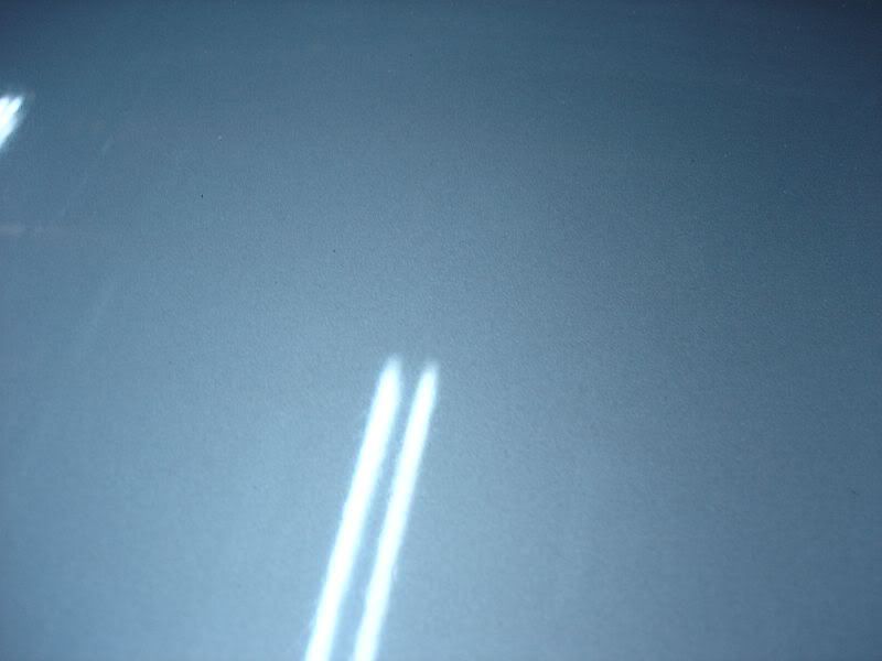

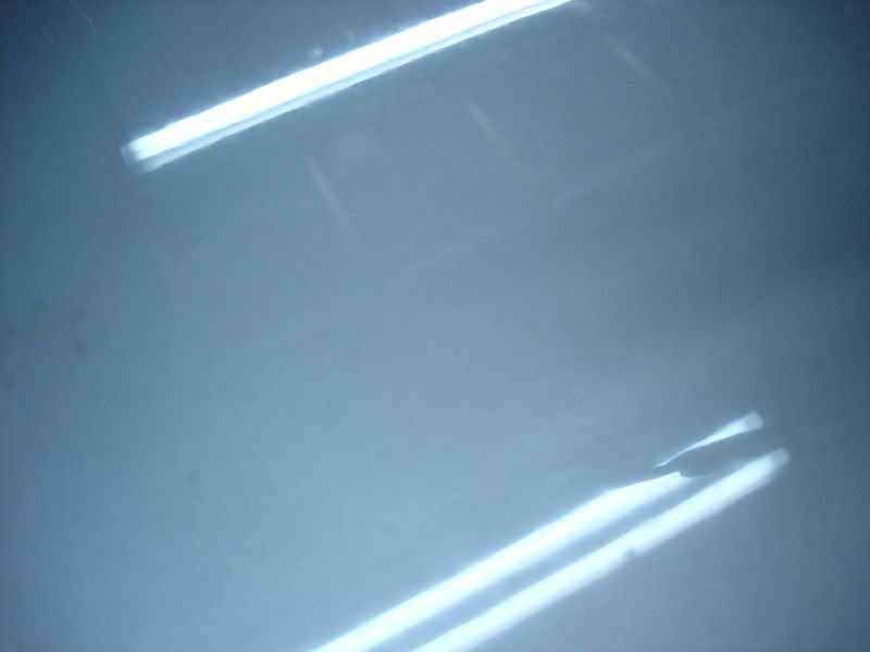

Here's a few pictures. They're not the best, but they are all I gots....
Some befores of the hood:
Some afters:
