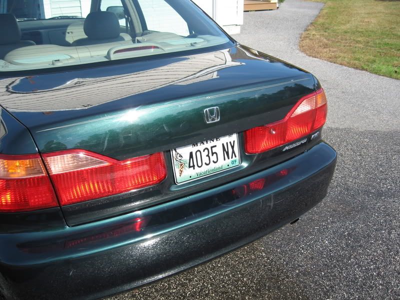

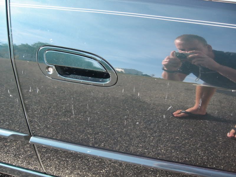

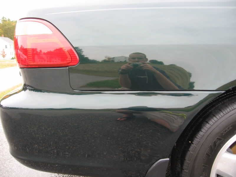

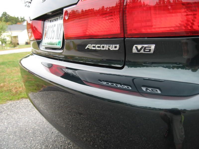

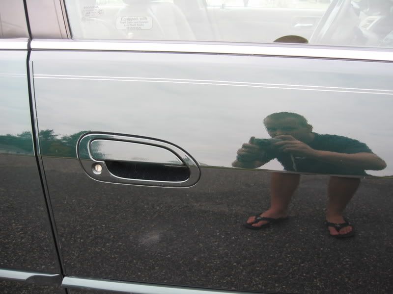

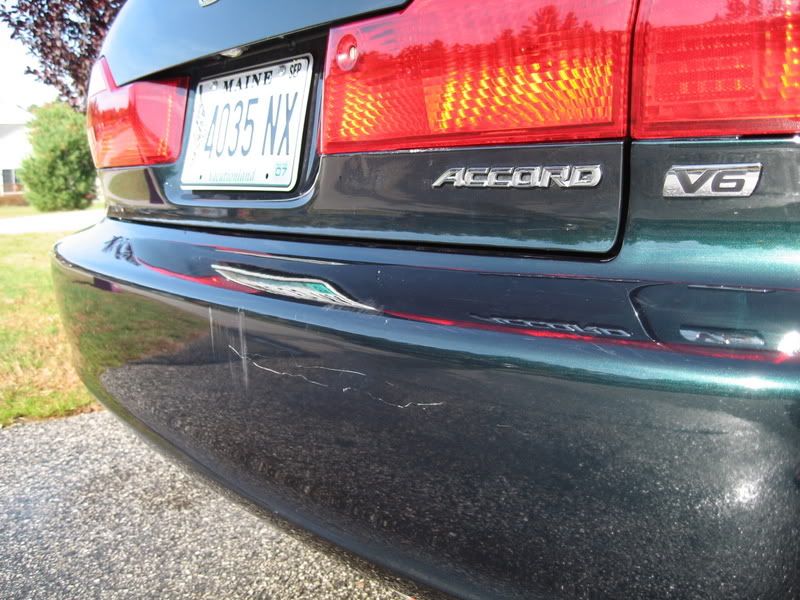

its a green accord with more scratches and door marks than I cared to count. The owner just bought it and wanted it cleaned up. the whole thing was covered in holograms.... the reason its probably not worth looking at is the sun wanted to dissapear for my after Shots! I did manage to get in a semi (before pc and klasse)finished hood shot before the clouds rolled in.
process was:
optimum compound at 3000 rmp on the defects (pretty much the whole car) with a yellow cutting pad
optimum polish at 1500 then 600 with a black finish pad
then optimum polish with a quick pass on speed 4 with a white pad just to make sure no holograms were left.
topped with AIO
the smudge is just some leftover aio
