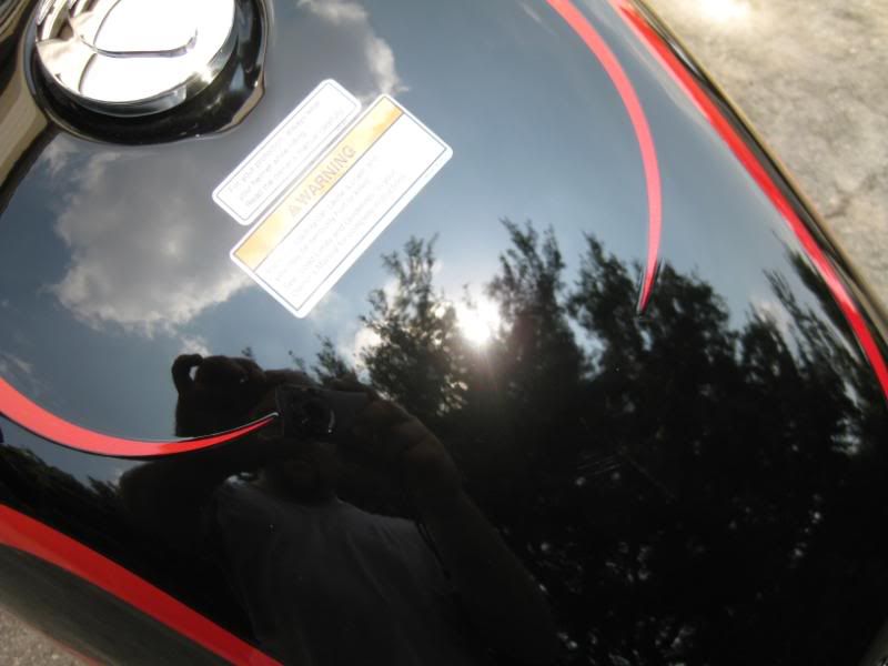

The process of the 2005 Honda Shadow Sabre:
I just want to state that the overspray was extremely cured and bonded to every surface of this motorcycle.
Paint:
Overspray was removed with Clay Magic Red medium clay and diluted ONR as lube
(this left severe marring, but it was the only thing that would remove the overspray)
Compounded with G110 and LC 4” spot buff orange pad with Meguiars M105
Polished with G110 and LC 4”spot buff white pad with Meguiars M205
Sealed with Poorboys World EX-P sealant (12 hour cure time)
Waxed with Poorboys World Natty’s Red paste wax
Finished off with Meguiars Last Touch quick detail spray
Chrome:
Overspray was removed with Clay Magic Red medium clay and Meguiars APC+ as lube diluted 5:1 (the overspray was very well bonded to the chrome)
Polished by hand with M105 (on deeper marred areas and) Mothers Chrome Polish
Sealed by hand with Optimum Metal Polish
Seat:
Overspray was actually removed from the seat with Optimum Power Clean at 100% and 4 Magic Erasers
The seat was very dry after the overspray removal so I applied 3 coats 1 hour apart of Surf City Garage VooDoo Leather Rejuvenator.

A couple of 50/50’s after M105 (sorry, the sun was in and out so these 2 are the best that turned out)
