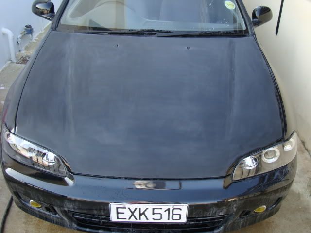

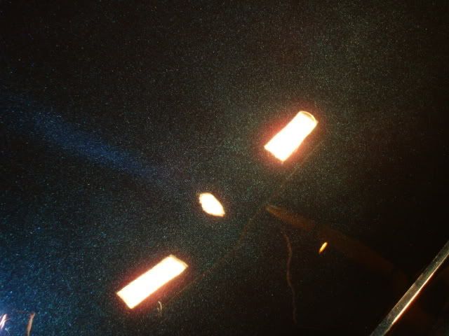

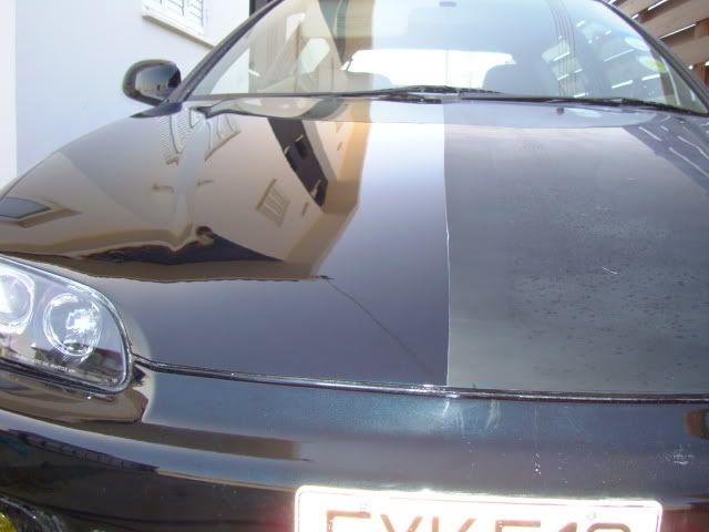

The hood full wet sanded with Meg's 1000 grit sand paper

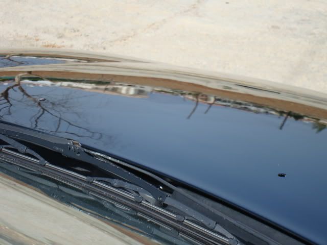

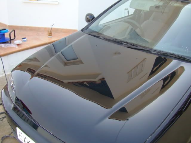

50/50 photos after the compounding/polishing steps

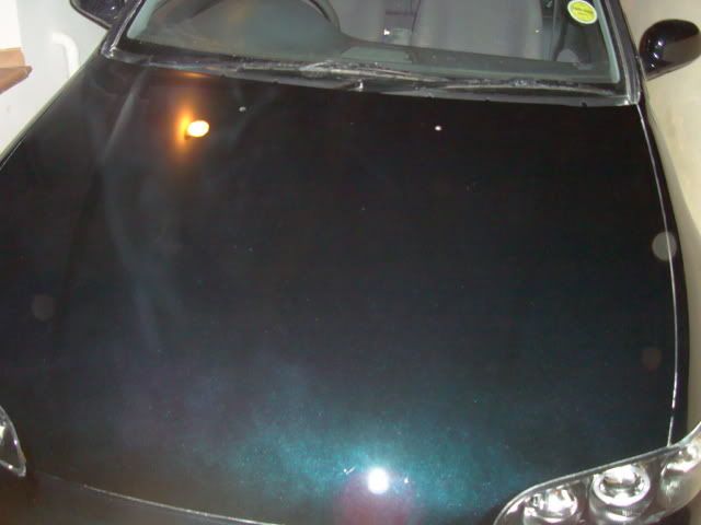

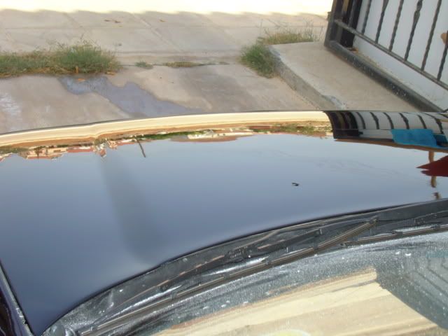

some pictures after the entire hood finished

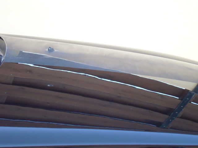

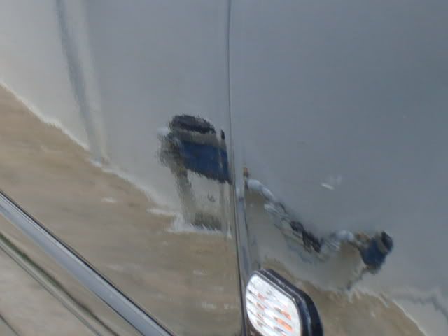

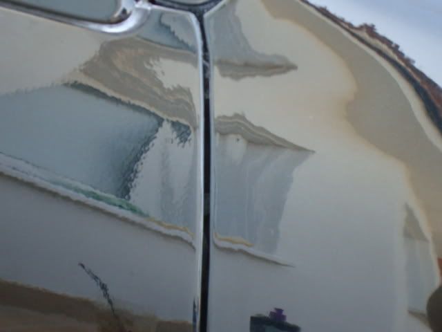

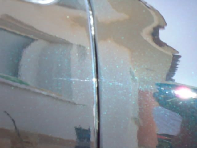

and some pictures to compare the finished parts with the orange peel level of the rest parts

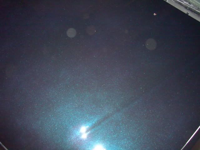

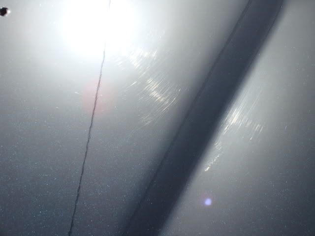

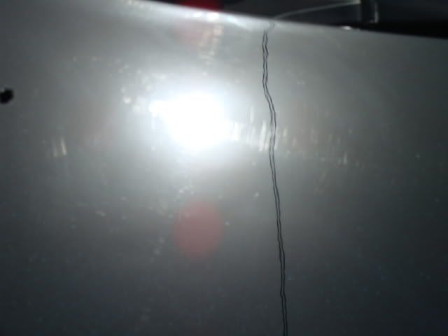

Then i took the car out the sun to check what i have done..i was disappointed and i have some questions...Those sanding marks need a wet sanding with less aggressive sand paper or they need more compounding with a bigger wool pad that i used??
Thanks for looking and all the advises are welcome....
First off nice job removing the OP.
Yes you will have to do both IMO.
2k and 3K would be best after 1k.
I like using an 7-8" wool pad on such large areas.
Thanks mate! should i go directly with 3000 or to start with 2000/2500 first??
First off, it is looking much better.
I would recommend 2K grit sandpaper followed by 2500 grit. Make sure you soak your sheets of sandpaper for 30 minutes before sanding for optimum results. Also, make sure you use a little dish soap or car soap in the water for added lube.
Like Bryan stated, a 7or 8 inch wool pad makes life a lot easier when compounding out sanding scratches. Be very careful not to sand too much near the edges or you will burn through when compounding.
Work in the compound with the wool pad the best you can before going to the PFW pad/SIP combo. Follow it up after with 106FA and 85rd and you should have a flawless finish.

The PFW (6'') is not enough to remove the sanding marks??What wool pad do you recommend me to buy???
no i think he means work in the Powergloss and PFW as much as possible. basically the compounding step is the most important and take your time to remove as much defects as possible. personally after the Powergloss and PFW i would prob use SIP and an orange pad or even white pad
I have LC pads..6,5''or 6'' Orange green and black and 5'' or 5,5'' yellow orange white and black, and 4'' yellow orange green white and black.
PFW isn't very aggressive, especially trying to remove 1000 grit marks.
And, although you can, jumping from 1000 to 2500 is rather large.
Sanding in 500 grit incraments will yield flatter results. However, from
1000 > 2000 > 3000 will work. Better still is 1000 > 1500 > 2000 > +.
For future reference. :)
And for heavy cutting, keep a few 100% twisted wool pads and maybe
a few polyester/wool blend pads for lighter compounding.

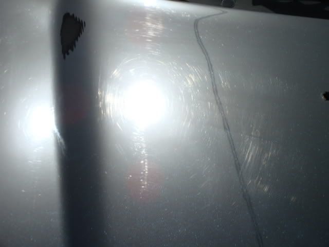

i wet sand it again on the afternoon with 2000grit 3M and i polished it again using
PFW 3,5'' and Menzerne PG
LC 5,5'' YELLOW and RD3,02 + PG
LC 5,5 WHITE and RD3,02
LC 5,5 BLACK and 85 RD
All compos by rotary
Here are the results
is that a repaint/custom paint? i wish i could get the orange peel out of my car, but with factory scion clear?? i doubt i'll make it very far and the car has a lot of orange peel.
Yes it is a repaint/custom paint..It has so much orange peel that you can feel it with your hand...Now about the factory paint i am not sure if there enough clear coat to wet sand it....
