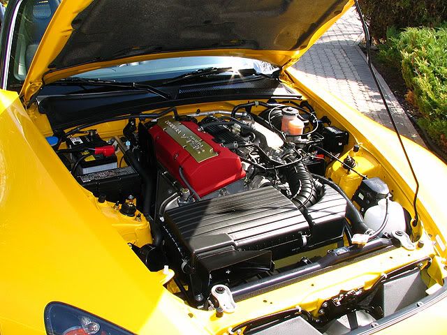

Engine bay was pretty greasy surprisingly:

Engine Bay Looks Not Too Shabby Either.
(Flash was on to show there is no grease left.)

Engine bay was soaked with 777 APC
Dressed with Dress It Right

Can you document in more detail what your engine process was? I really want to do engines but am just to scared and dont want the responsibility if something happens
GREAT WORK!!!!!! When you used Dress it right on the engine, did you cut it with water or use it straight? I usually cut it but have had problems with it in cold weather. Have you used it straight on tires at all? I still have 2 gallons left. I usually reserve it for wheel wells but again, it was cold when I used it.
I personally would never use Dress It Right on an engine bay. Just too expensive, but I used it straight. Wanted to give it the best look possible.
As far as the engine bay, I just spend about a hour on it. Took a damp cloth and wiped the dirt off. Sprayed on my degreaser. Let it sit for like 10 minutes, then came back with a degreaser soaked rag and went over it again. Sprayed on the dressing, let it dwell and then just wiped it down. I like Dress It Right, because it dries somewhat hard, so it doesn't attract dust like crazy.
