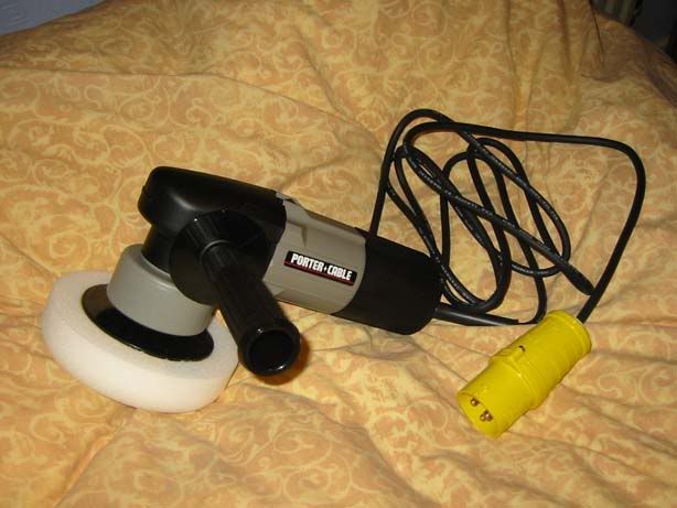

I found AudiDrivers post at the bottom useful. I bought a 110 socket from B&Q for £4 and chopped off the 2 pin cable on the PC. I then wired black to live and white to neutral - there is no earth cable. Then you are set to work with your 110v transformer - I bought mine from machine mart - 1500w for £70
Here is a link for wiring
http://web.onetel.net.uk/~uncletony/mains stuff.htm
Just took me all of 15 minutes to change the plug over, very easy.
Plugged it into the trannsformer and all is well.
Now I need some decent weather, where it does not rain, just as you are about to apply the wax :rolleyes:
After, courtesy of Screwfix:
