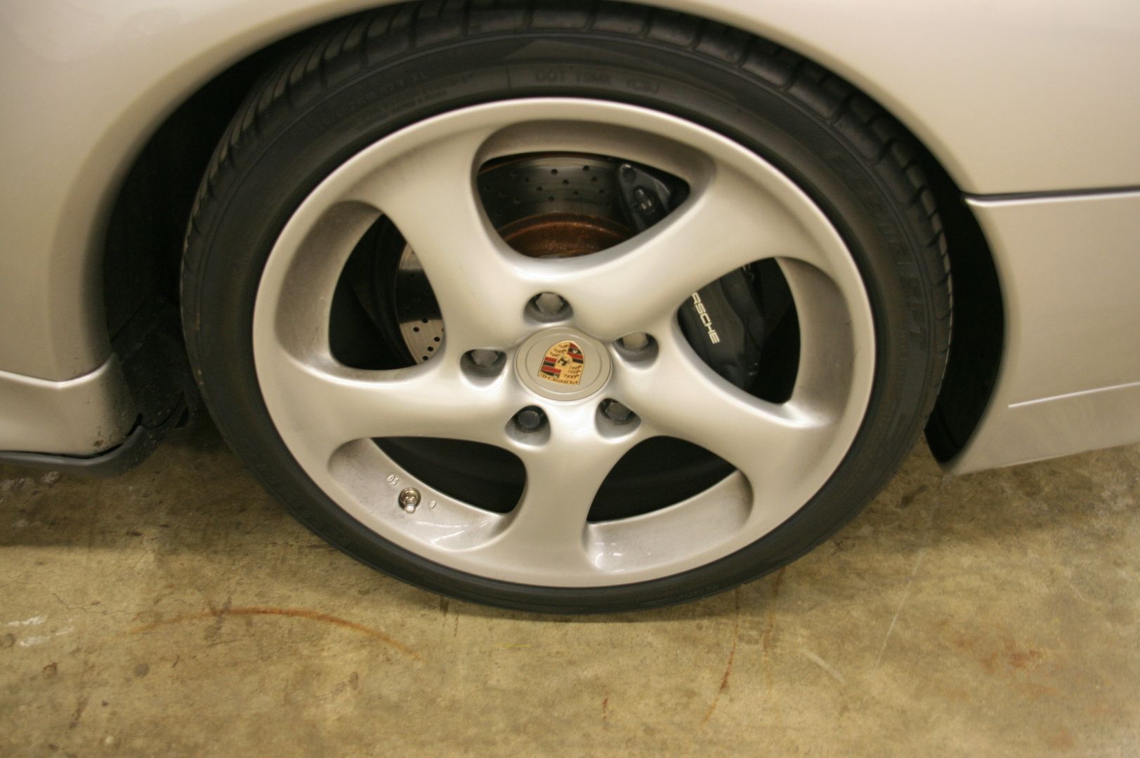

I used Sonax Full Effect to remove the brake dust inside the barrels, love this stuff! Side note, the lemon scent claim is about as accurate as free falling bomb.

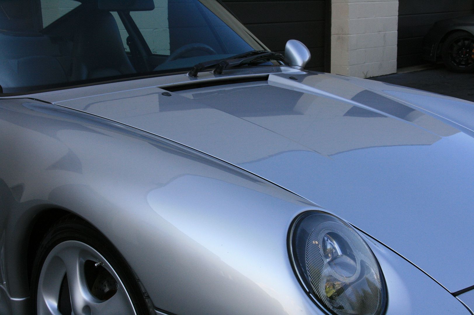

Not sure how to describe this accurately, which I'm assuming would be considered the cowl:

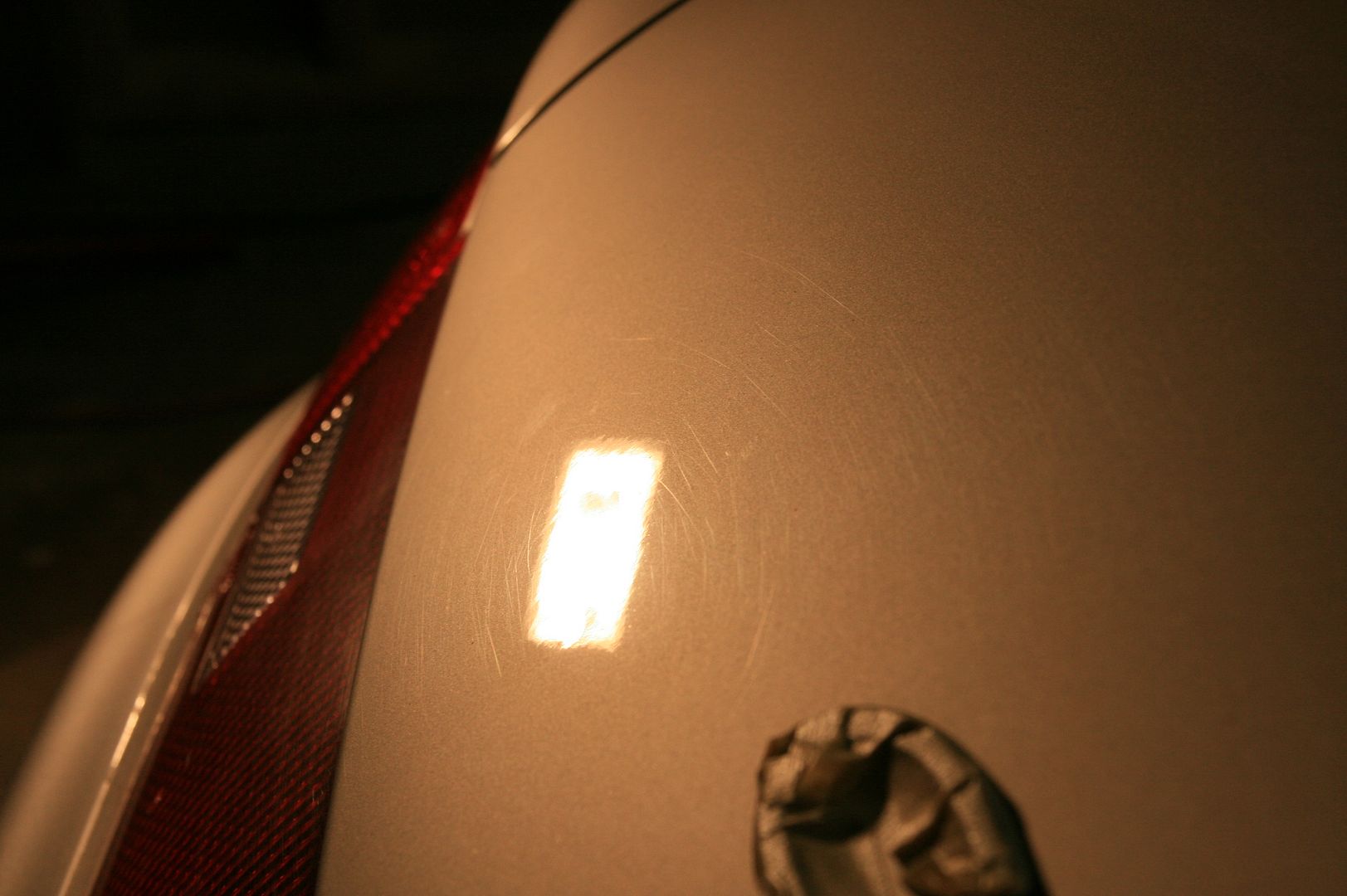

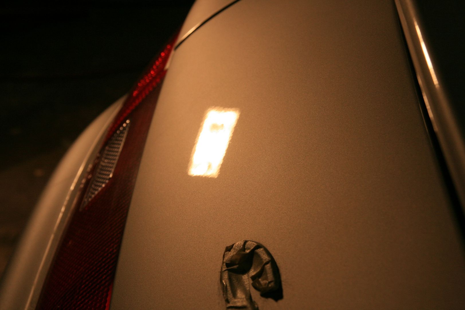

Paint correction on the trunk.
Arctic Silver is definitely one of those silvers that really pops! As you can see in these reflection photos following below, which are the result of
Meguiars 105/LC Purple Wool
Meguiars 205/LC Foam Orange
Menzerna 106/LC Foam white
Paint was cleansed with IPA and P21S Paint Cleanser
Sealed twice with Menzerna Powerlock. I will let the visuals do the talking from here!

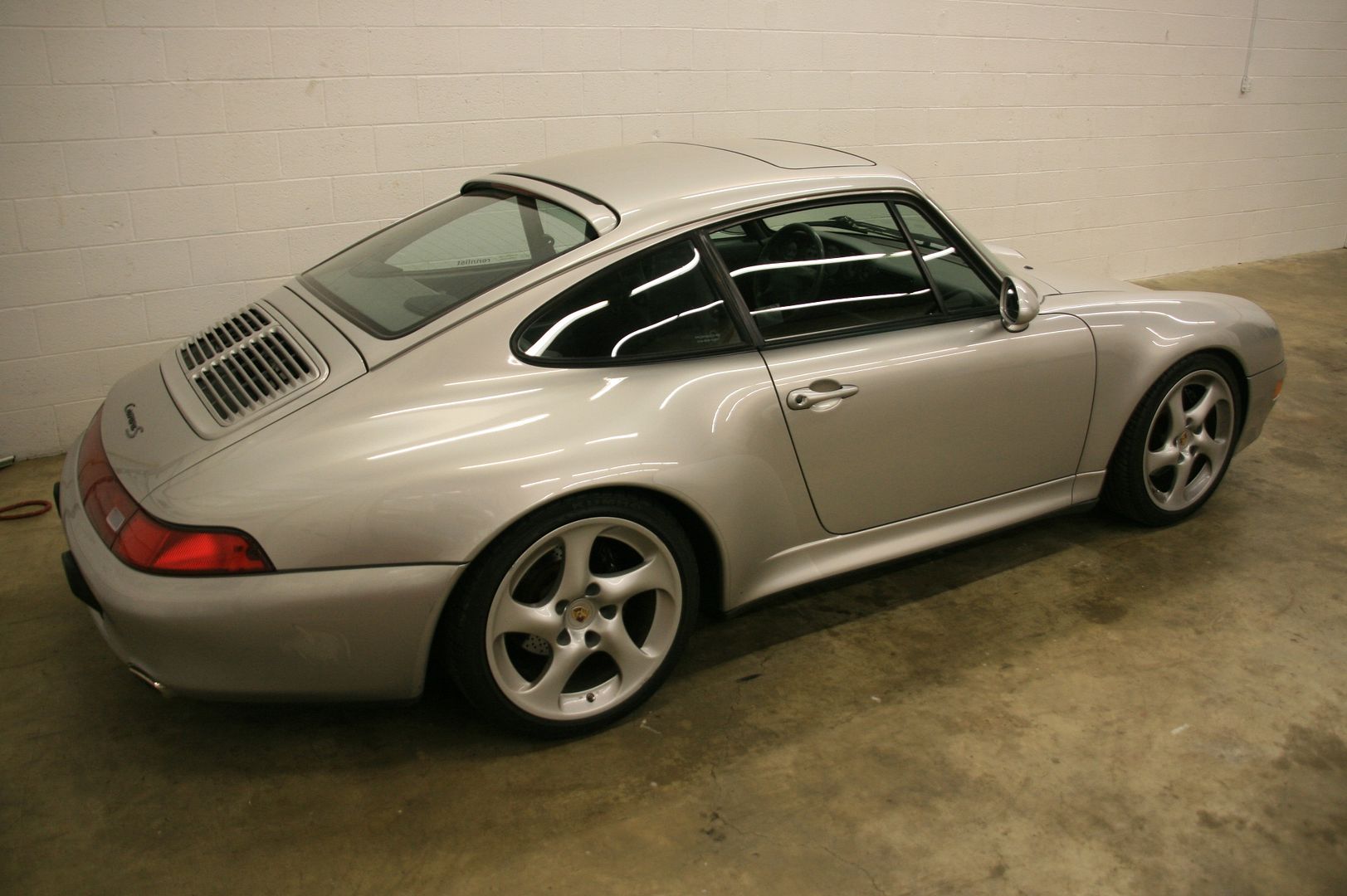

Some full body profile photos, hopefully the rear end shots are still safe for work, Sir Mix a Lot claims it might be risky!
