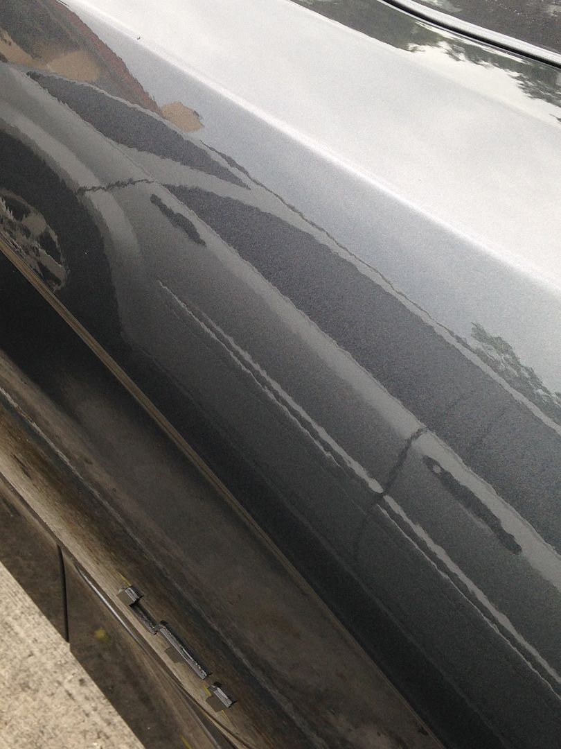

OK guys next project: I want to reduce the orange peel on my new 14 vette - it's particularly noticeable on the vertical surfaces. I talked to a local detailer and asked him to prescribe a way to do using an orbital and pads rather than rotaries and wet sanding. I have plenty of time to do one fender per day if it takes a long time (retired) I know I can wetsand and use rotaries but am gonna try the least aggressive way first. So he recommended:

the OP is light but noticeable - the reflected image is not clear - here's the front fender

With the Meguiar's pads, I would recommend using M105 or M101 or even D300. Neither of these polishes will gum up the fibers as quickly. Make sure to blow or brush the fibers clean after each pass.
As far as correction power, I would stick with speed 4-5 on the Griot's as well, although if the Corvette has the typical Corvette-hard clear coat, then you may need speed six.
are you saying that wetsand will be needed first?
will 1000/3000 do it?
Polishing the paint will not remove the orange peel. You will need to wet sand and/or use something like the Car Pro orange peel leveling pads first.
P1500/P2500 would work good. If the paint is very hard you may need to finish with P3000.
well after trying a test panel (behind the rear wheel low on the car) I have found the procedure that works for me. It gets rid of an acceptable amount of the peel - not all gone, but only I can see it in the right light. So here's what I did:
1. sponge wet dry 1200 grit
2. 200/3000 grit wet dry
3. hybrid wool pad with flex 3403 rotary on med speed w/ meg's ultimate compound
4. orbital with orange pad - speed 5- more UC
5. orbital with white or black pad with Meg's 205....
the orbital with the megs MF pads did very little to get rid of the sanding marks, I suppose they would if I kept at it, but the hybrid wool is still the clear cut winner..tomorrow the whole side...stay tuned
