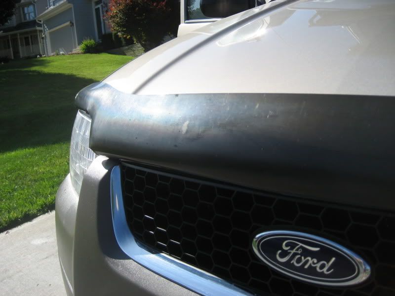

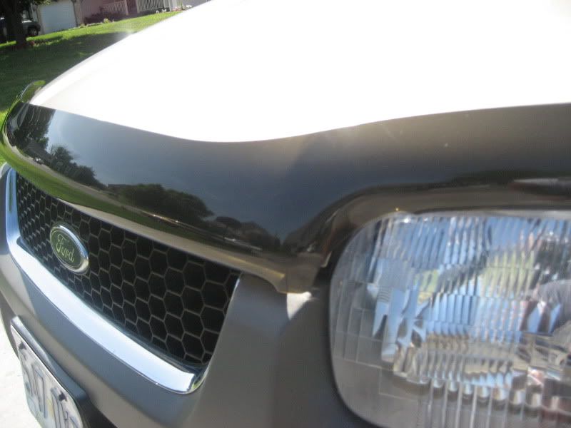

I had a Ford Escape today with a black plastic bug shield on the front of the hood. It was so scratched up and dull it actually looked like it had been wet-sanded!!!
So I thought... Hey...I'll just try some 105 on that!
I can't believe how easy it was... nothing else necessary except for a little coat of Blackfire Wet Diamond after the polishing.
It took about 5 minutes to polish this.

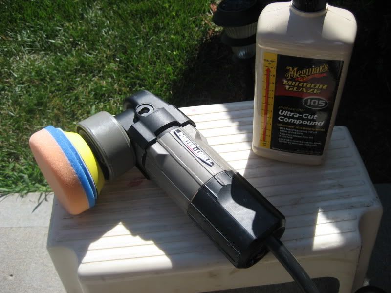

Tools of the Trade:
PC, 3.5" backing plate, 4" constant pressure pad.

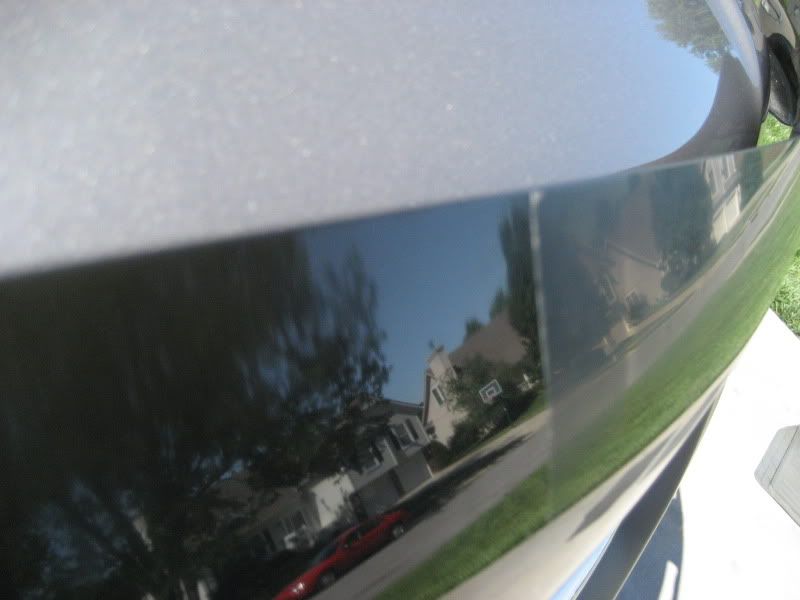

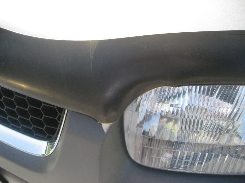

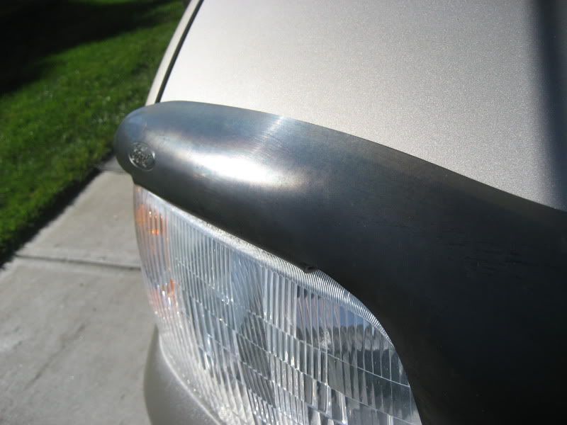

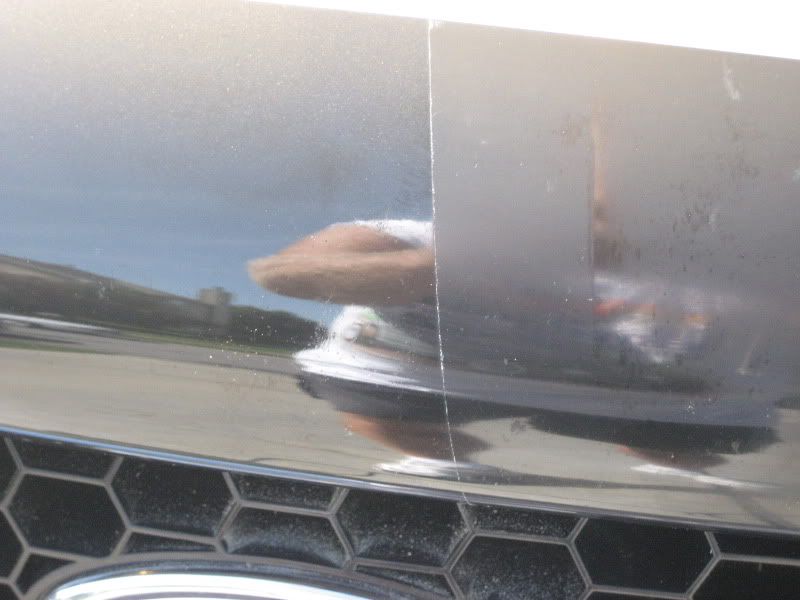

Before & 50/50:

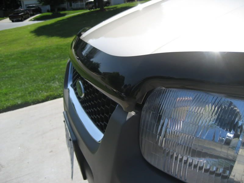

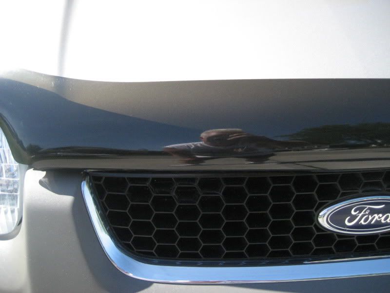

After:
Still had some bug juice etching and rock chips but looks a whole lot better.
