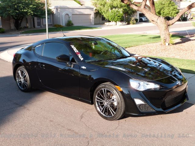

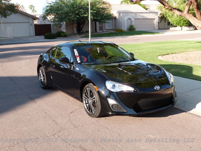

Here she was upon delivery. Not bad from a distance as usual...butttt let me go on ahead and take you through what we saw while inspecting it:

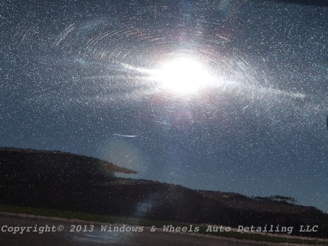

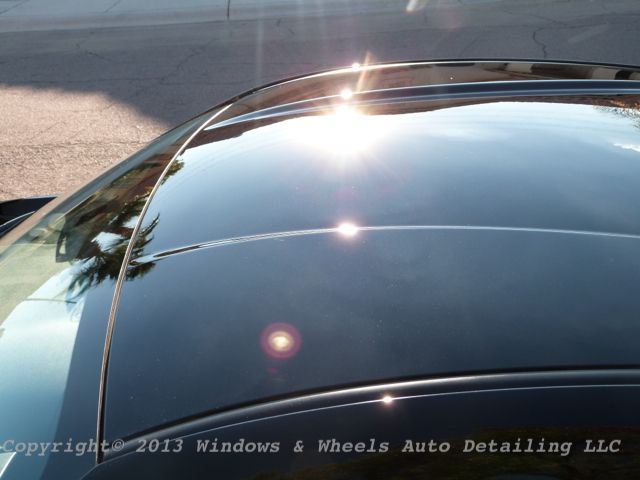

Well, it was swirled, duh. Roof was a bit lighter than the rest of the car.

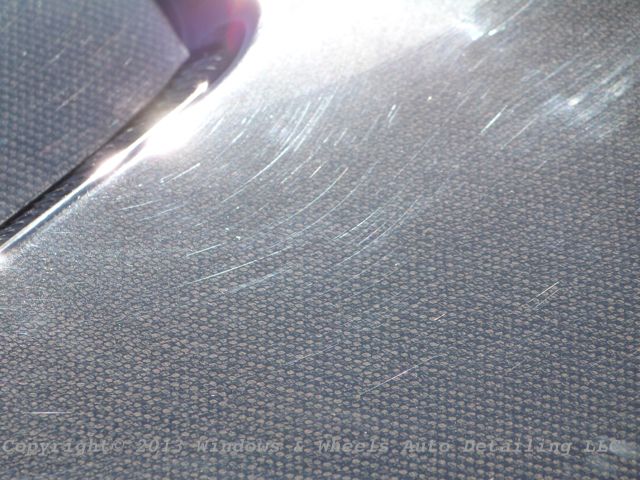

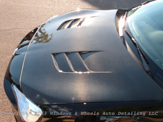

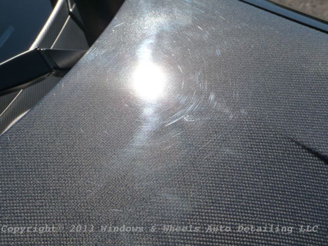

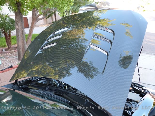

Carbon Fiber hood was beat up pretty bad in some areas...had to pay some extra attention to it:

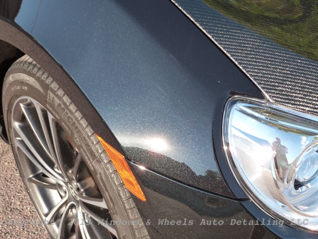

Here is a pretty cool shot up close...this is the edge of the hood where it meets the front quarter, you can see the swirls in the quarter, but you can also see the sweet look of the CF.
But, from this angle the CF doesn't look so sweet....yet

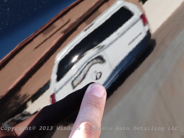

Had a small ding in the side, the owner pointed it out

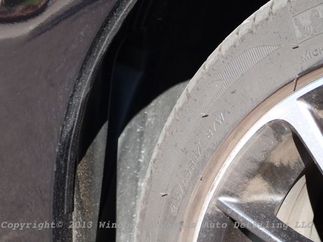

Wheels, tires and wells had the classic Arizona coating on them...

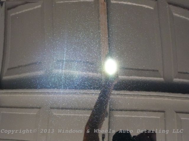

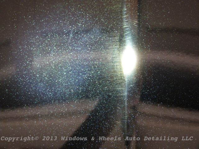

The trunk had some wicked swirls as well:
Ouch!

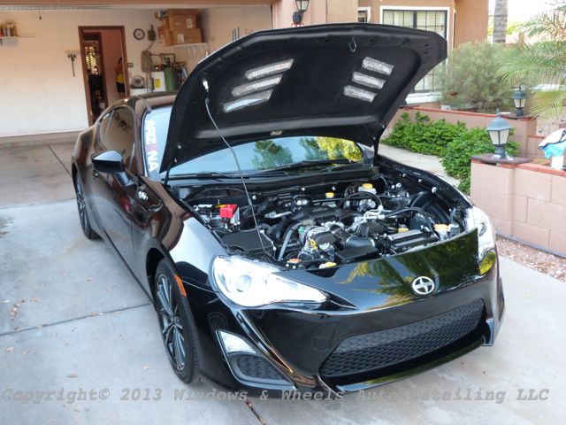

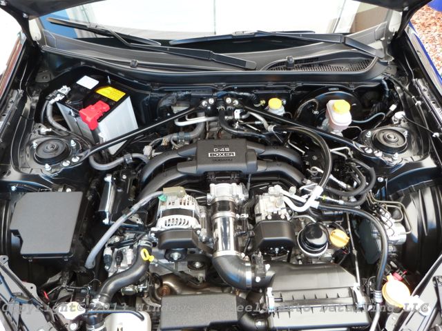

At home i had my compressor, so i poured the PERL into one of my syphon feed guns and hit the engine with it. Some areas were hit a bit thicker than others, so i just took a brush and sort of spread it out...it turned out GREAT. I really loved how it looked...and even at 5:1 i could tell when brushing it down, that it still had a good amount of thickness to it...and not very greasy (which if applied too heavily, Hyperdressing can sometimes be a bit greasy and need a wipe down afterwards).
Here is how it turned out:
Not bad huh?

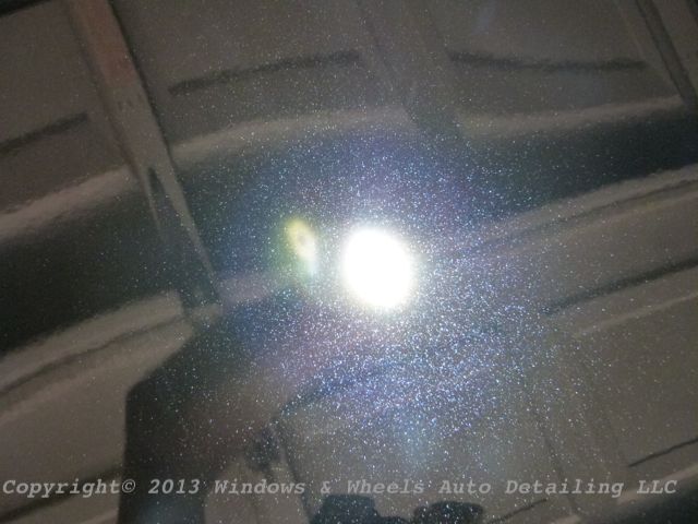

After compounding, we followed up with HD polish...and man after hitting it with that...the paint just glowed...prior to any coating...it was just awesome. In the shade it looked super black...and when the light hit it...the metallic just popped like mad:
Test spot was lookin good!
Sometimes hard to get a direct 50/50 shot on metallic paint but, i think you can tell which side is done

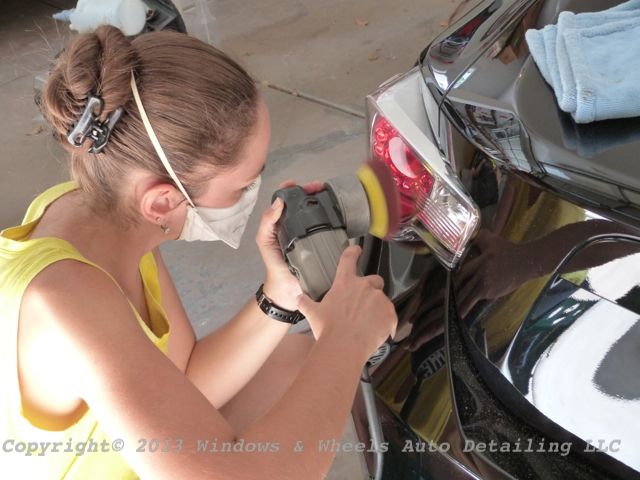

Friday morning came...and though she was still low on energy, Dani was back up and at it. Grabbing the PC and a 4" pad, she went to work on the tight areas i hadn't yet done, while i grabbed the HD polish and started turning the already compounded areas into panels that looks like gems.
Dani of course, got the lights as well while she was at it:

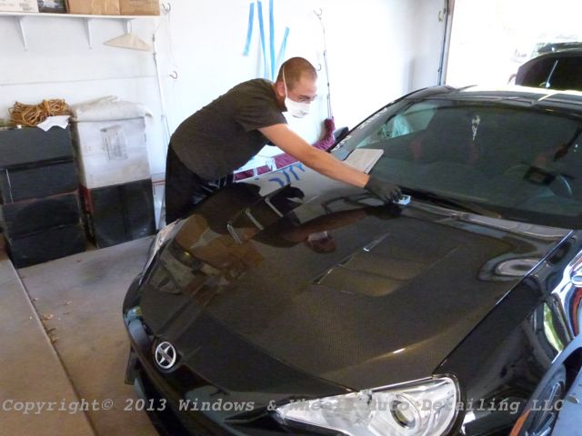

It only took us about 15 minutes including drying - then pulled her back in and began our Eraser prep.
Obvious product shot there lol....but even though the water was running totally flat after washing, which indicated no polishing oils left...we still did an Eraser wipe just to be SURE the surface was completely clean before applying Finest. Btw that microfiber towel from CarPro-Us.com (Corey)...is worth every penny...its a must have especially when prepping black, soft paint. While this paint wasn't super soft, I have used it on super soft paint...and it has thus far caused no towel marring. I use it ONLY for Eraser wipe downs.

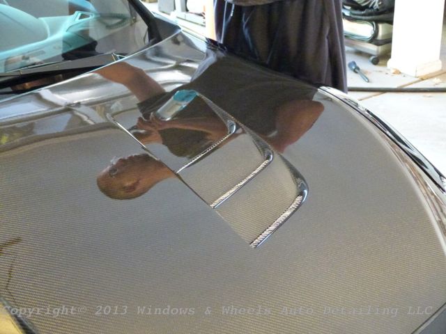

Carbon fiber nice and clean
Time to break out the good stuff...and this was the new Version 3 of FINEST

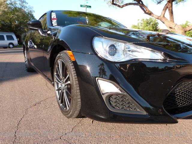

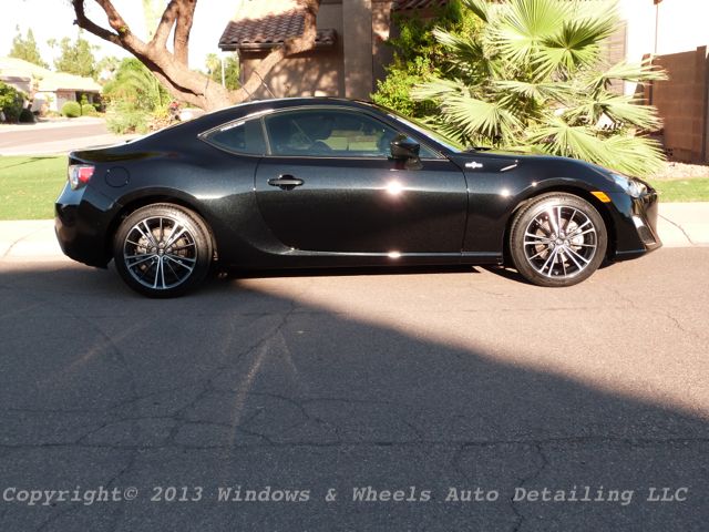

Even without the coating...the car was already glowing and looking show ready:

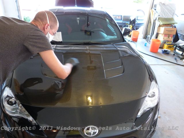

Applying FINEST:
It took me roughly 30 minutes to apply 1 coat to the entire car, Dani took care of the wheels and tires in the mean time.
Long arms come in handy:
I always do my final stroke in the direction i want the water to sheet off...in this case...parallel with the car:
Every nook and cranny received a nice thick coat:
The V3 of FINEST was very nice to work with. Usually even after waiting a full hour, when I'd go to wipe the first panel, id get a SLIGHT bit of a left over oily residue, this time however...after just 30 minutes, it wiped off completely clean. I found myself checking from several different angles because i was USE to having to re-wipe the area with a secondary towel just to remove any oily spots left (usually from where my fingers were pressing or where the towel last touched the paint)...but not this time.
After wiping away the first coat, a second was applied and then removed as well. FlyBy30 was applied to the glass, Dani applied Dlux to the plastic (there isn't a lot on this car) and a final touch up to the door jambs was done....and finally it was time for the fun part...after photos.

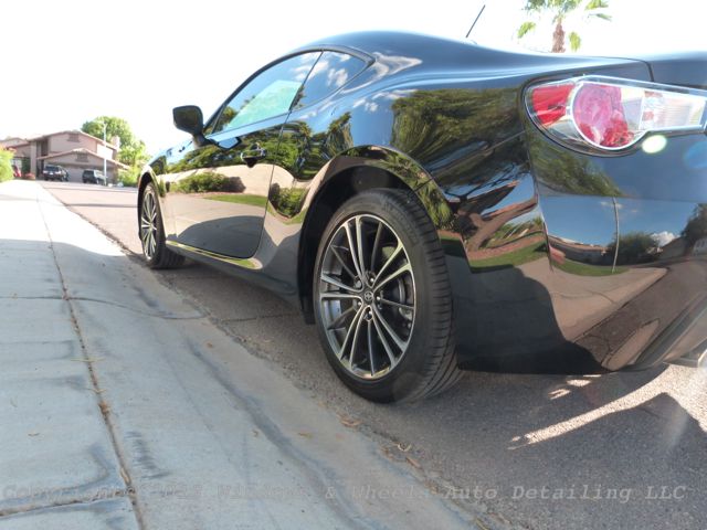

Now I took quite a few after shots....you might just scan through them...but i think if you take time to really look at each one...you will be quite impressed with the outcome. I dont KNOW if V3 has more gloss than the previous version, but when i tell you this car was GLOSSY and WET looking...i mean it...I'll just let these photos speak for themselves, but I'm tellin ya...it was gorgeous....roll that beautiful Finest/Windows and Wheels footage!
